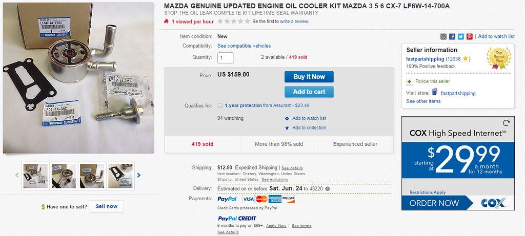

I purchased my replacement oil cooler off of Ebay. I took a gamble here because as something as important as the oil cooler, I would really only trust with OEM. Instead of posting a link that inevitably expires, here is a screenshot of what I purchased:
Ebay Listing by Monk Ratava, on Flickr

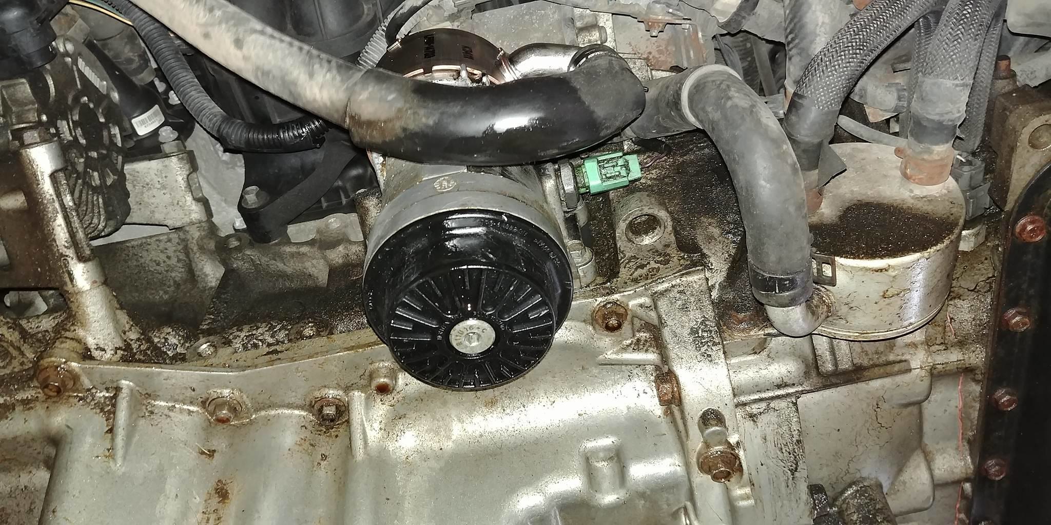

The symptoms were leaking massive Oil, about a 1-2 quarts every gas fill-up. The leak would drip onto the oil filter housing and the lower coolant line attached to it.

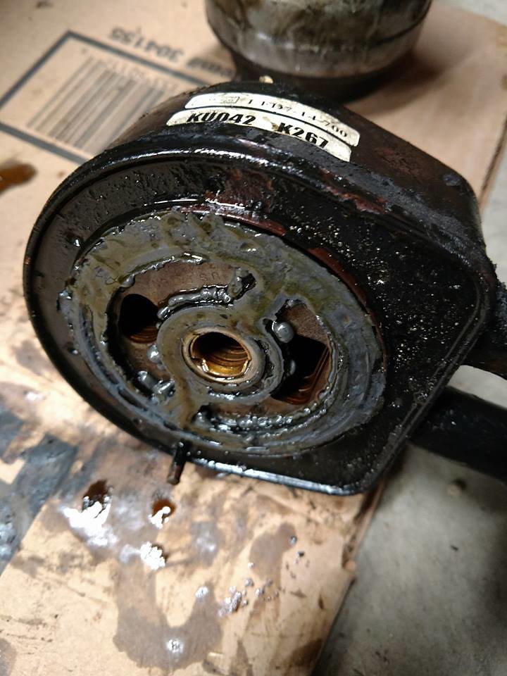

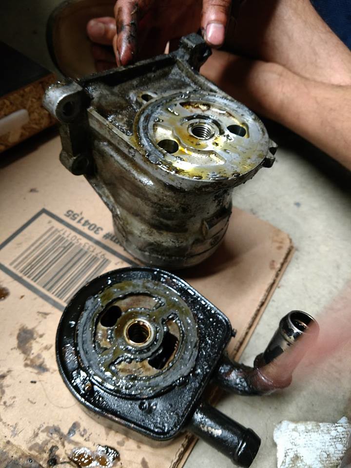

Now comes in that YouTube tutorial I mentioned earlier; Not only does it not fix the oil leak as many people have commented, but it also sets the next owner up for failure when truly fixing the leak. I don't know how much it leaked when the previous owner had my 5, but I can confidently say that their "fix" leaked a whole lot under my ownership. Your jaw will now drop as much as mine did:
bad Seal by Monk Ratava, on Flickr
Botched Seal by Monk Ratava, on Flickr

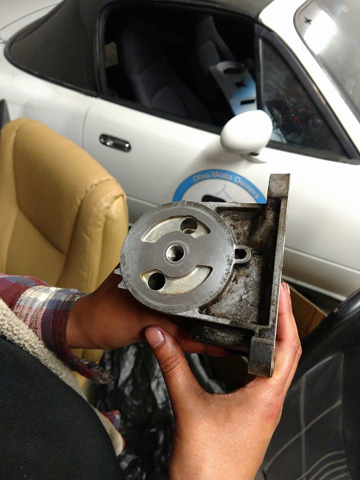

Wow. Awful. Not only did this not fix the leak, but it took me 2 hours to carefully scrape off and not have a silicone shrapnel land in the oil filter housing. Judging by the photos too, I would wager the gasket material probably shot into the oil (I cringe thinking this happened to me). Another downside to this make-your-own-botched seal is the mating surface to the oil cooler is slightly corroded. I highly recommend getting a new Oil Filter if your previous owner attempted to fix this way. After 2 hours of scrubbing with PB Blaster and a hotel key card, I finally got the surface to look like this:
Cleaned Oil Cooler Surface by Monk Ratava, on Flickr

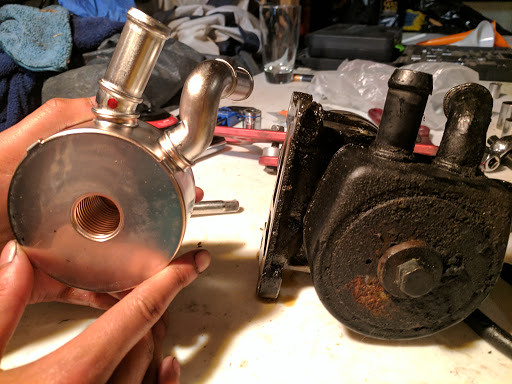

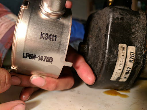

Much better! Reinstallation was pretty straightforward. For the Engine Block Gasket, I made sure to use the reticle side and the opposite corner to line it up to the block as straight as I could:
Block Seal by Monk Ratava, on Flickr

Ebay Listing by Monk Ratava, on FlickrThe symptoms were leaking massive Oil, about a 1-2 quarts every gas fill-up. The leak would drip onto the oil filter housing and the lower coolant line attached to it.
