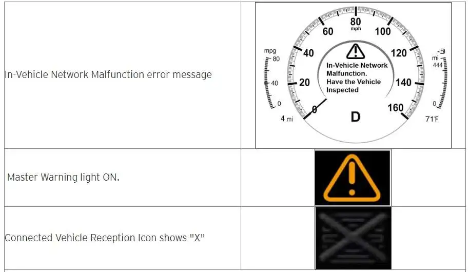

Some owners may see the following error Message in Instrument Cluster.
Network Malfunction Error.
or
Master Warning Lamp on.
or
Connected Vehicle Range Strength-Reception Icon showing 'X'
This is almost always because your TCU or Telematics Communication Unit internal malfunction, and needs the Driver (Software) to be updated Via USB Flash Drive.
