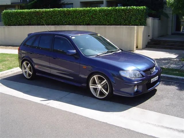

Hi people,
I own a 01' Mazda 323 sp20 and am quite happy with my car, although in the future I hope to have something abit quicker, perhaps something turbo.
When its time for me to purchase another car, is it worth converting my current car to a turbo or should I just buy a car thats turbo originially?? Has anybody done this before? What are the approxiamate costs involved?
I like the appearance of my car and am happy to keep it for alot along, if I can make it considerably quicker.
I have some knowledge about cars, but if this was to be done a professional would be doing the job for me. This will of course increase the overal costs due to labour etc.
So.. any ideas? Im in Sydney btw.
Thanks for any advice. Pic of car is attached.
