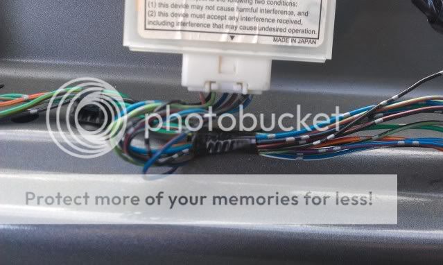

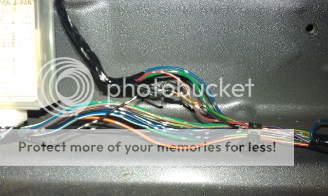

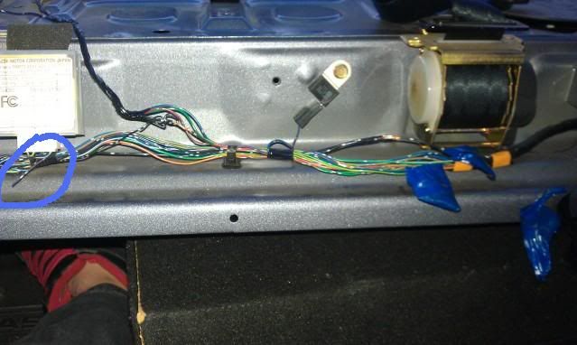

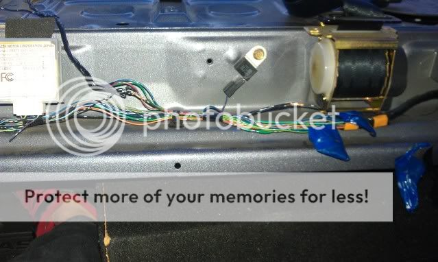

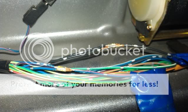

I just had to do this. I have a TT installed (and the two wires cut to arm the alarm while the timer runs). The car refused to go into programming mode until I reconnected the blue wire at the keyless module under the rear deck. Thought I'd share in case someone out there still runs the stock alarm... :)
Thanks for helping me figure out why I can't program mine, I knew the turbo timer may have had something to do with it.
I dont have any pics but just fold down the back seats, remove the clips for the rear deck and pull up on it and there is a white box with a harness plugged into it. There is blue wire with i believe a white or silver stripe that i had to reconnect, this wire lets you lock the car when its running. I like having working remotes now.

heres what im working with
what needs to be changed
