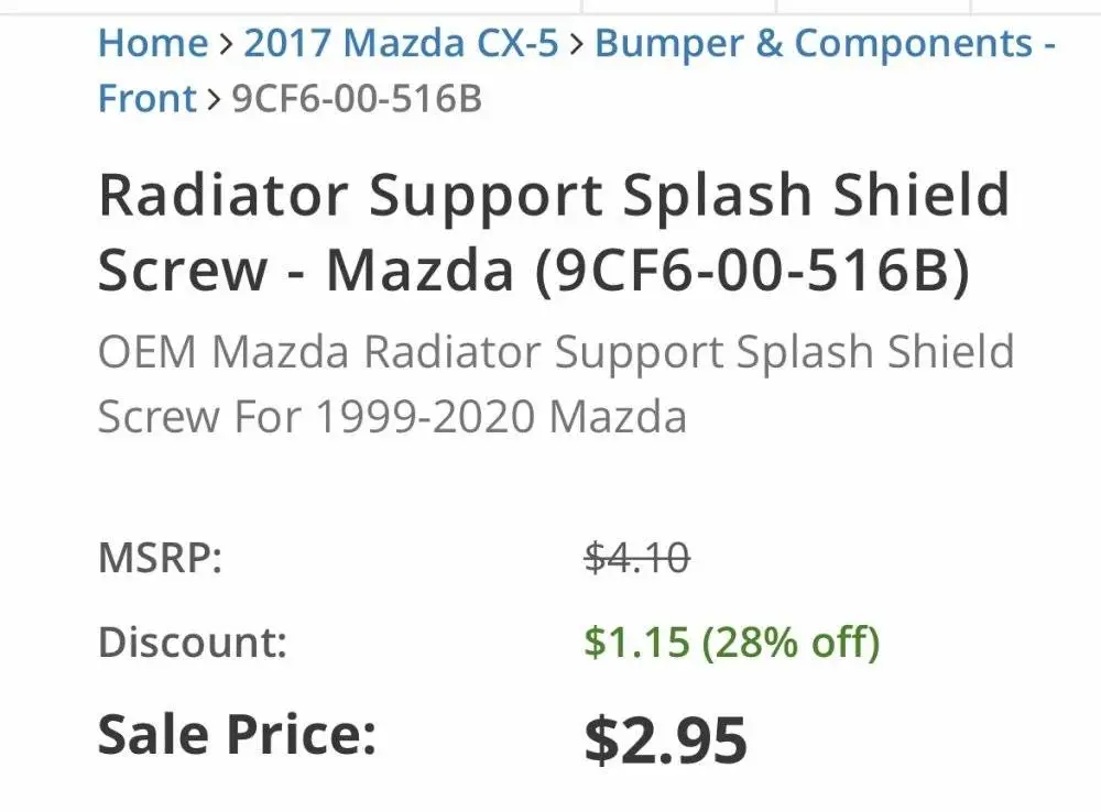

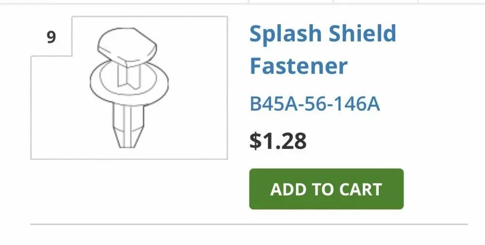

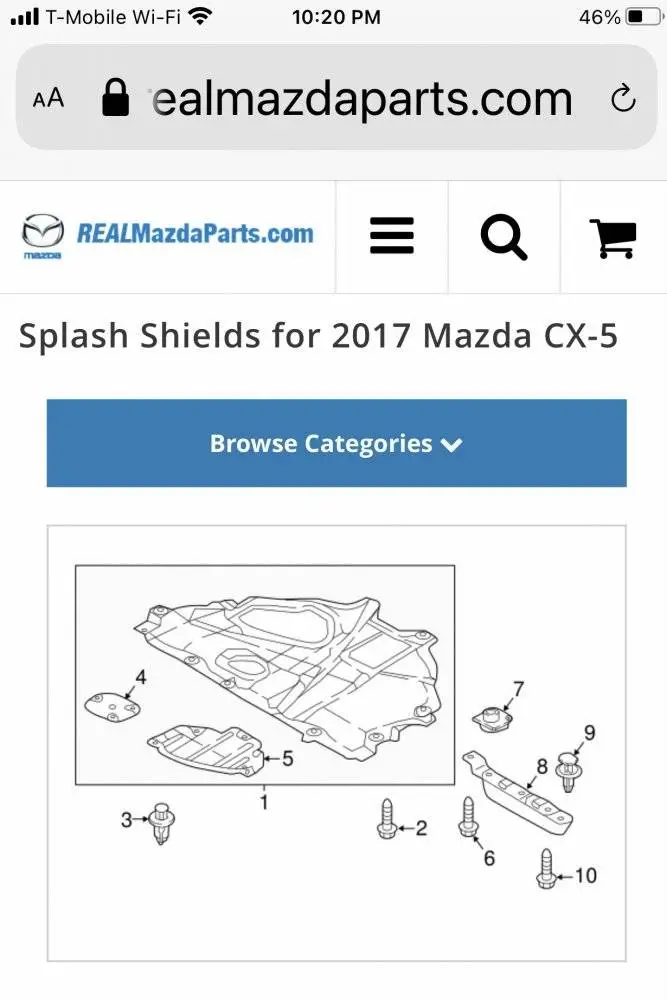

Any idea what part# are the plastic clips that hold the plastic access cover underneath the car that accesses the oil filter area?

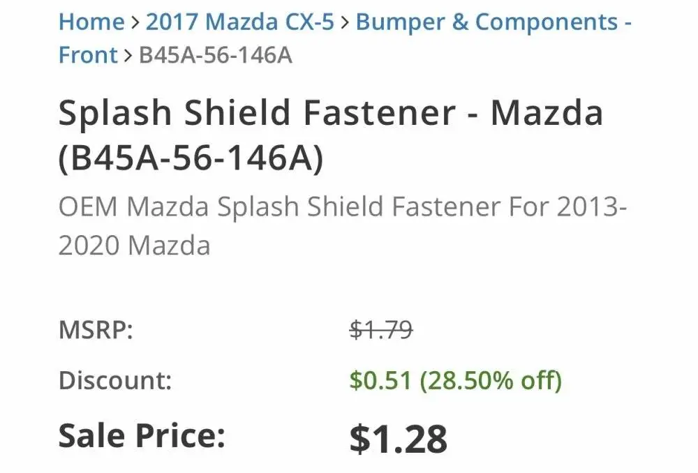

There’re plastic clips and screws (total 3) for the oil filter access hole cover.

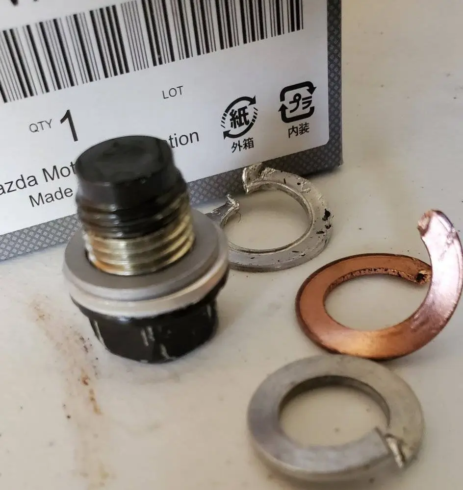

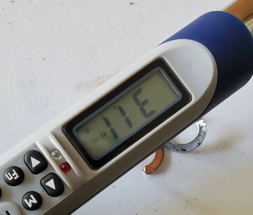

Here I snipped three washers, 1 OEM, 1 Dorman from my stash and a copper washer I had. All are soft enough to easily snipped. I'm not saying you should save money by buying cheap, but saying you don't have to use OEM washer. OEM washer was much thinner than Dorman washer. I wasn't sure what the correct torque for my CX-5 was , so went for 30 fp

Oops, over-tightened by 1.1 fp
