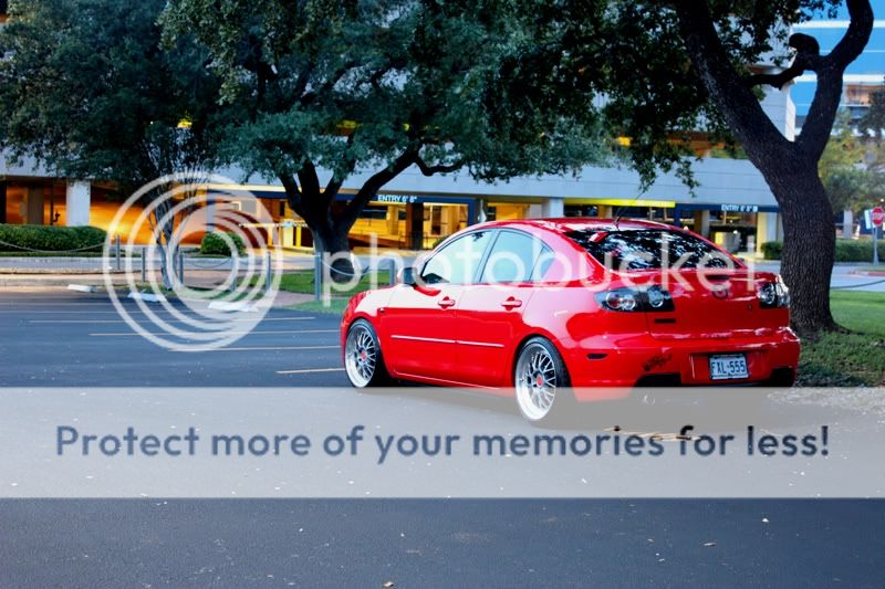

There is a red sedan with those privat wheels. Except they are 18x8.5 +40
For the 8.5 you will atleast need the natural camber of lowering to fit them with a mix of stretched tires and rolled/slightly pulled fenders.
The TSW wheel will be harder to "fit" you will need camber arms for it to fit correctly.
Thanks for the solid reference photos, i've been looking for ones like these all week.

In those pictures he's on springs.
17x9 +35 will rub unless you pull/roll your fenders and have camber

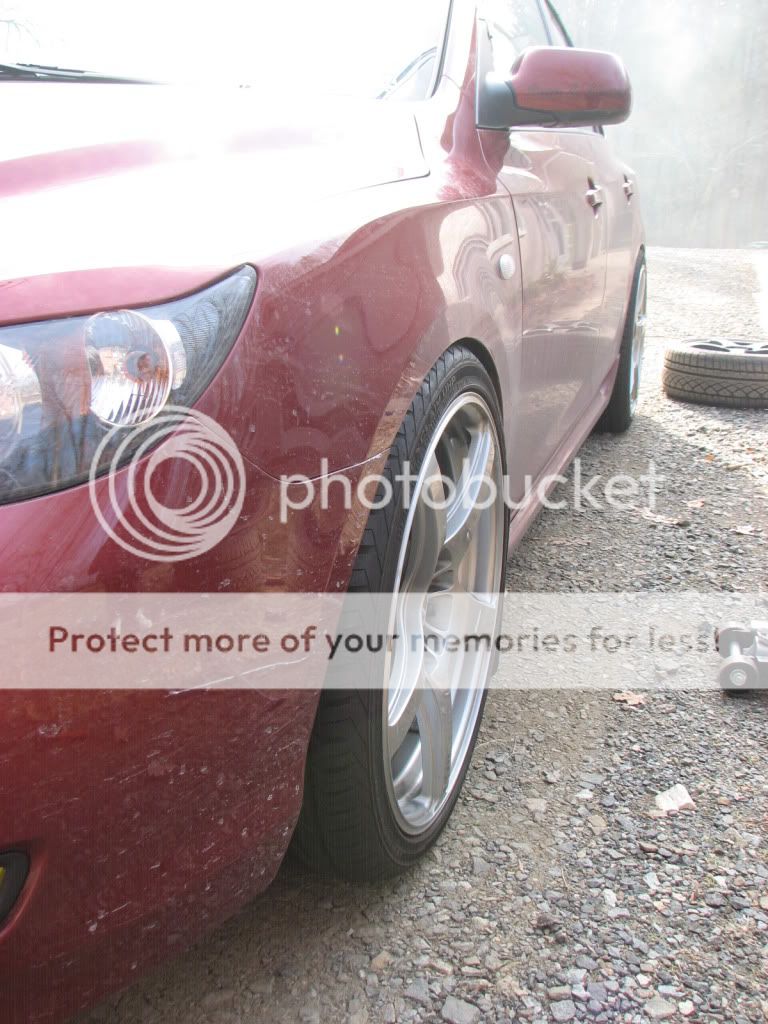

And for reference my 19x8.5 +42 wheels sit like this with 235/35/19 tires on them. This is not functional because I need to roll my fenders and get some negative camber in the rear. Also need some 225 tires in front to aid with clearance at my ride height. They're not stretched tires or crazy camber but that's not my style. I want a clean stance.
