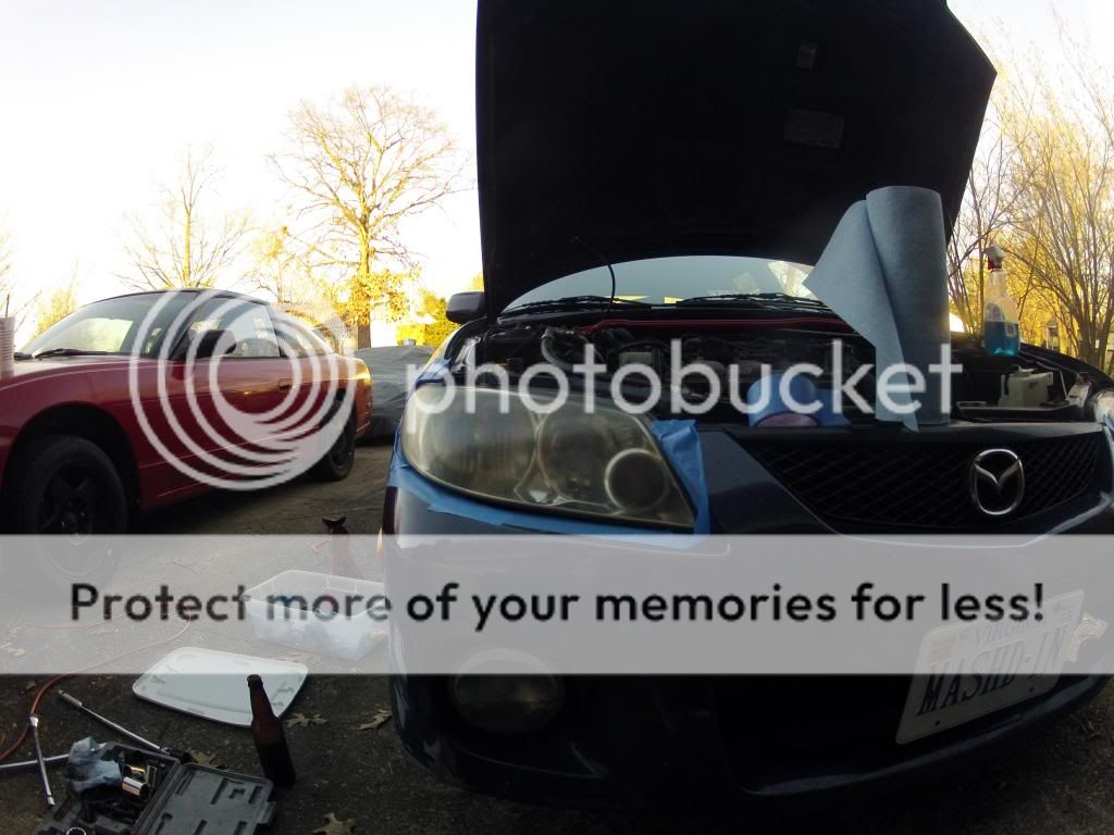

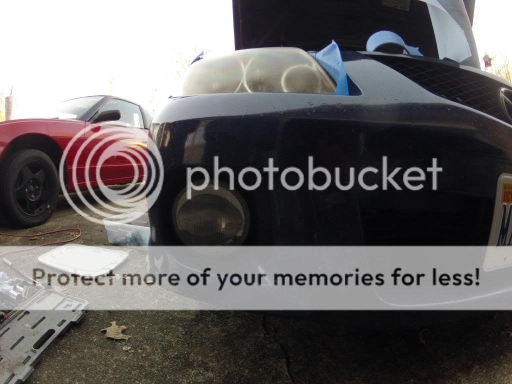

I did restore my headlights and put fresh oil in anyway. Not my fogs, I am gonna try to find a clean set later on.
DIRTY

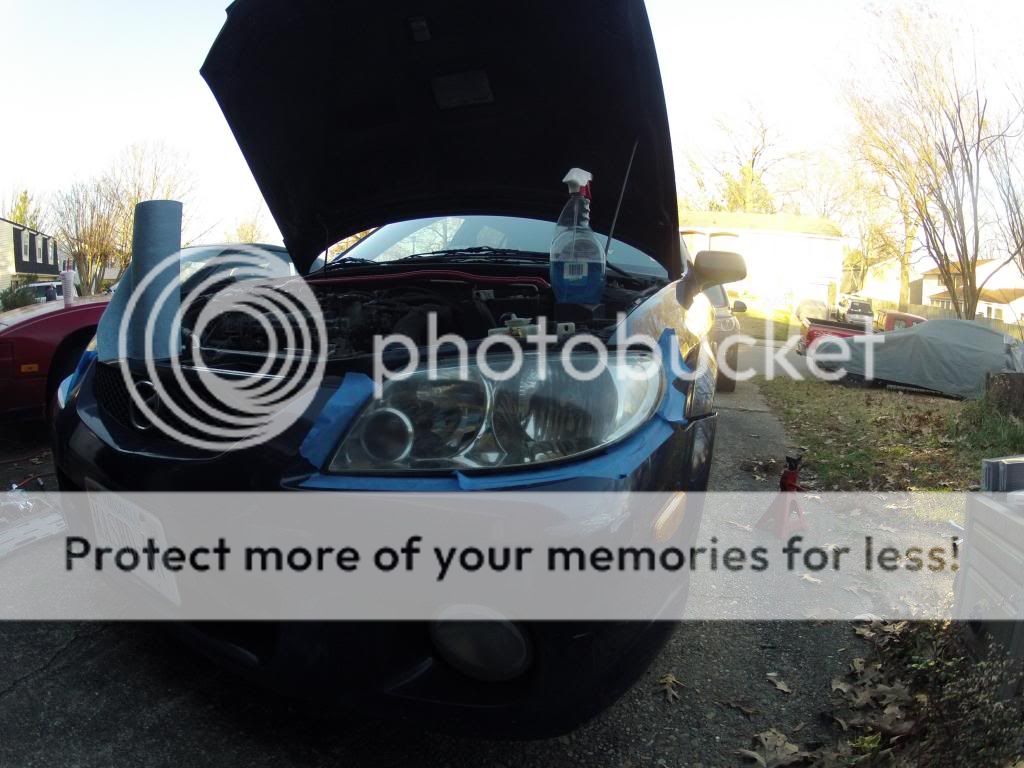

Other side I did first with the whole kit, all the levels, not sure it really needed it, inner corner was hella hard to get into with the shaped pad provided, so I will go back later with other things.

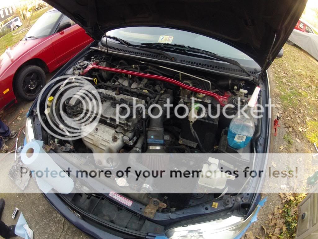

The bay

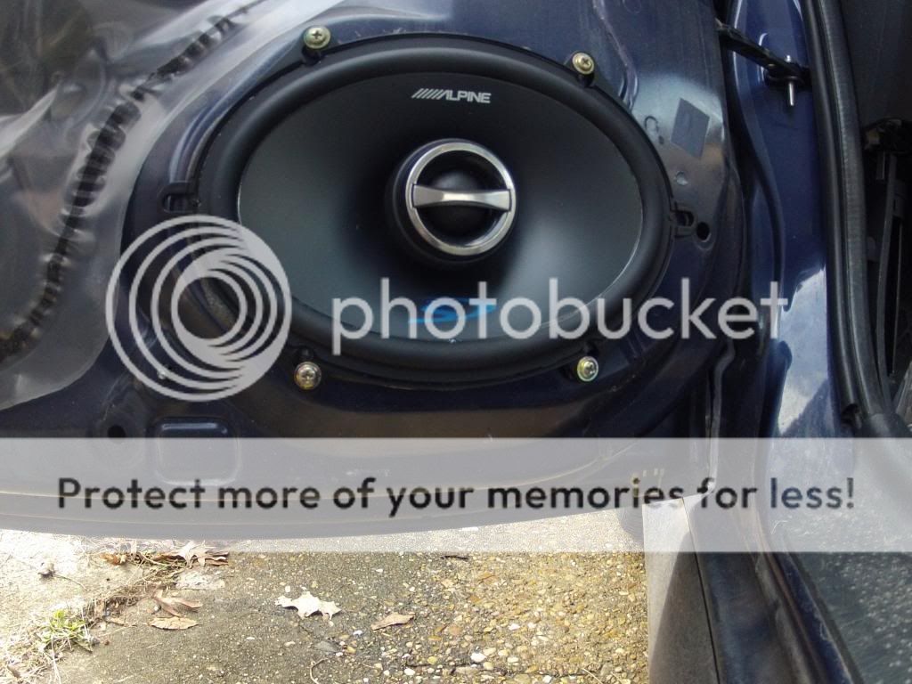

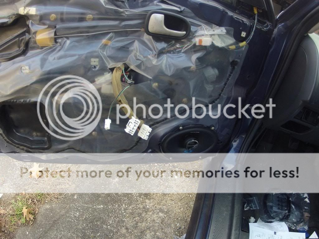

Both Front doors had the same stupid rattle and I figured that out in like 1 second.
I wanted to just use some home foam in a can insulation, but I couldn't get the old can to work, so I did a little syrofoam and silicone sealant. Should be fine.
Replaced the fronts with whatever I found first.

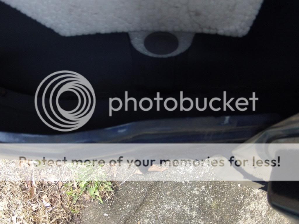

So 3 doors are all better, here's the driver's door before I make it go back.
Oh a couple tips for those of you wanting to investigate under your door cards.
*Have a thin longish flat head and a normal phillips.
*Take your time
*Take out the plastic tabs first
*In the rears to take off the handle work back to front sliding and pulling towards the inner rear of the vehicle
*To remove the tabs that usually break or pop out the door cards, lift them so you can get under the tab with the flat head and pry, comes half way out every time, pullit out and put it back in the door card and it will be ready for install later.

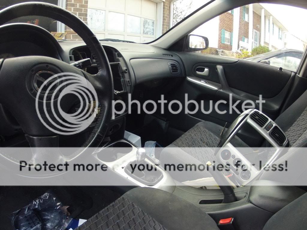

Radio bezel is also super easy if you take your time on the HVAC cables first.

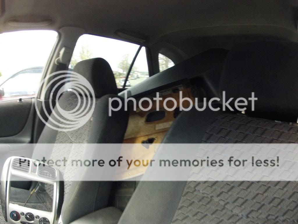

Still haven't gotten around to redoing the one lock yet. But I took the HU out of my old daily'd S13 coupe so now it bumps all four doors. Not really on purpose but I now have a full alpine system. I might build a custom 8" for the rear drivers side quarter and get more low end feel. First I need to measure the depth to see what kind of box can be built there. Probably will be an 8" that's shallow,maybe a 10". I still want a good amount of room to put stuff.
I still need to build a bracket for my HU and pocket, its just laying in there ATM, I might throw in a maxima pocket, cuz this one[current mazda pocket] holds like 3 cd cases, who needs that?
