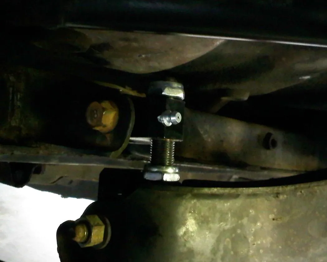

Small update: got the rear camber links installed (that was fun... NOT!). Took it back to get aligned with much better results this time; -1.5 degrees of camber all around, 5 degrees of caster up front and 0 degrees of toe all around. New brake rotors are on the way and I'm looking into a source for pads. When those come in the yellow calipers will be painted black!
EDIT: I'm seriously eyeballing some TII sideskirts and front lip on eBay right now - they're even the right color! I'll just have to see how the bidding goes as I've set a max price I'd be willing to spend...
Anyhow, here are some pics of the trick rear camber links (stock is on left in first pic):

New brake rotors came in today (now only if I had brake pads as well). Also won some stock seat rails+sliders on eBay last night - going to try to fab up something for the Sparco seats. Going to go looking at a '88 turbo motor+trans a little bit later as well :)
Goal before MWMF is to get the rotors installed, calipers painted black, Redline e-brake boot installed and Sparco Corsa pedals installed.
