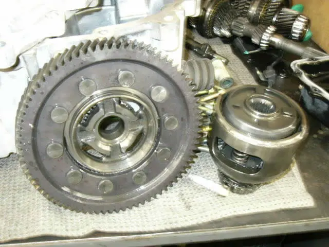

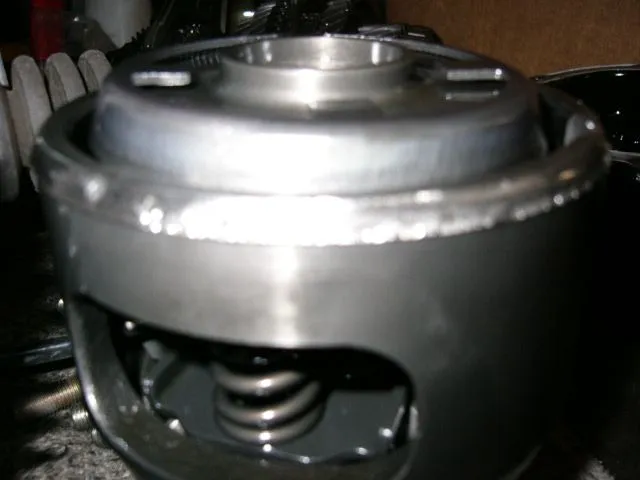

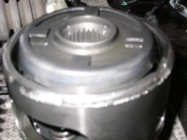

What the guys said above^. Give it gas & no go. Heres some pics of it I took today when I went to go inspect it. POS Differential. One pic is where the differential is next to the gear its supposed to be attached to but it's not.
EDIT: Pictures added at the request of JDM Sam

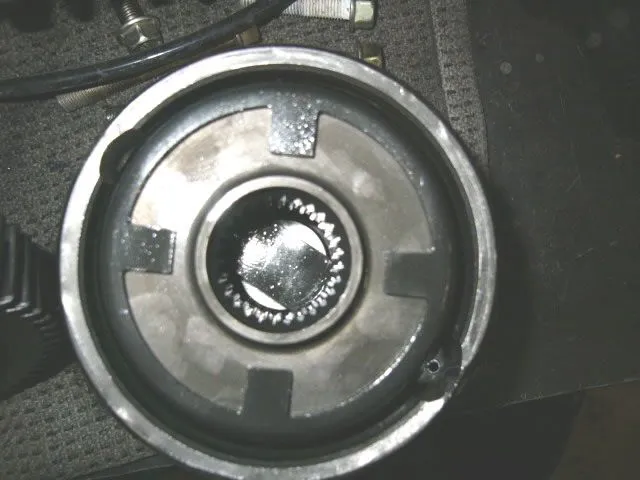

Compare the pic below to the one above. You can obviously see the half that snapped off. The other half is in the drive gear. Yea I want a KAAZ not a Queefer LSD.
