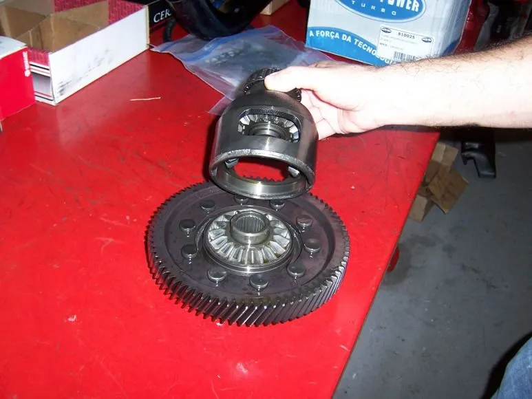

I have a 03.5 MSP with a production date of 01/03.
And this is my LSD it has no springs.
Mine went in downtown Dallas. Just let the clutch out at a redlight, heard a small pop, and them vrrrrrmmmm the motor just free wheels no movment. I reved it up enough to get out of the road a bit and waited for the wrecker.
Mine went at 103,000 after 3 yrs+ of 12-15PSI daily.
Just random as hell how and when these LSD's decide to let go.

Nope not your fluid. Mine went at 103k miles all stock fluids.
The welds are just defective and I think all of them will break over time.
TheMAN said:
all stock fluids meaning you never changed them? :wtf:
No you dufus! Meaning the gear oil was stock gear oil and not some fancy pants, overpriced, syncro-whats-its-fluid. Some people felt that the after market fluids were a contributing factor to their diffs failing. The fluid has nothing to do with it. These diffs have failed under various conditions varying numbers of miles, under all kinds of driving conditions, and with both kinds of MazdaSpeeds with both versions of the LSD.
I personally feel that all of them will break over time. In fact some people have had two of these diffs break within a fairly short amount of time.
I will either buy a Quaife, buy someone else's rewelded stocker, or have my LSD rewelded.
