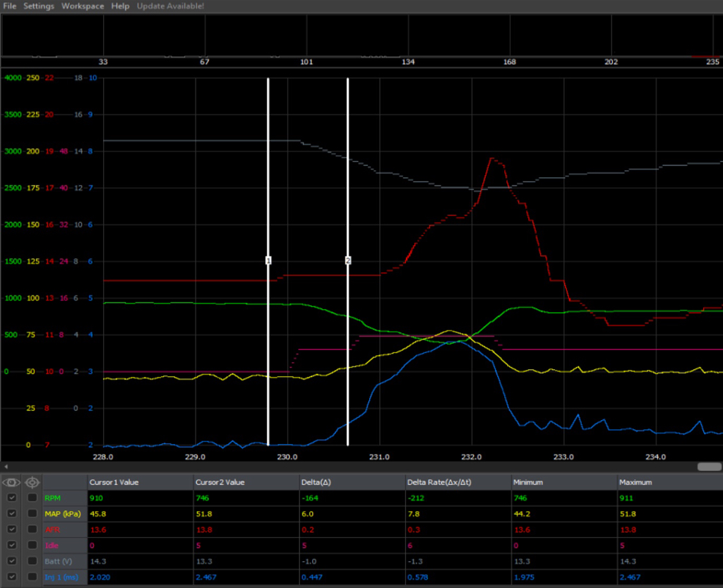

Sort of related to battery voltage, I’ve been trying to get the electric fan engagement to not stall the motor. I can bump the idle control valve, which works great to increase idle back to a desirable level, but the immediate engagement nearly stalls the motor. Not sure if it’s the opening of the valve, the load of the fan (ie more load from the alternator) or the change in voltage messing with the injectors. My idle timing could be off too, meaning I just don’t have the torque available to handle the alternator...but my timing light is busted...ugh, another trip to the parts store.
I thought you wanted the alternator "sense" wire connected to a constant 12V source as far away from the battery as possible. That way it senses the greatest voltage drop and can better regulate it. I have mine connected to the headlight circuit because it was the easiest, closest circuit that would see a large power draw. The electric fan constant source would probably have been better but that would have required running the sense wire around the front of the car.
What is your idle ignition timing? When I first got mine running I had 0 deg B/ATDC for leading and 15 degrees of split so trailing was 15 deg ATDC. My idle was actually really smooth. When my friend stopped by last October he advanced it significantly to around 10 deg BTDC but we kept the 15 deg split. The idle is definitely rougher now but I think that went a long way to help my issue of stalling when coming to a stop. I may play with it to achieve a happy medium of a smooth idle and not stalling. I don't have any issues with stalling when the fan comes on. I might get a 100 RPM drop that settles to 50 RPM lower than my usual idle (no idle control) but that's it.

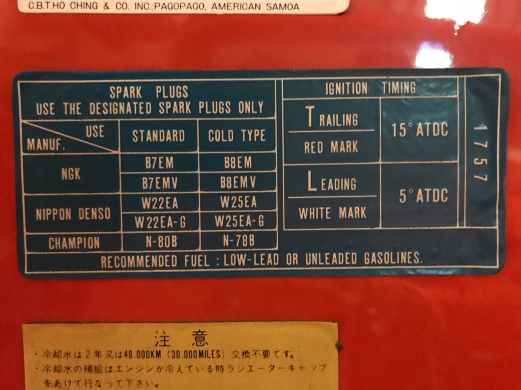

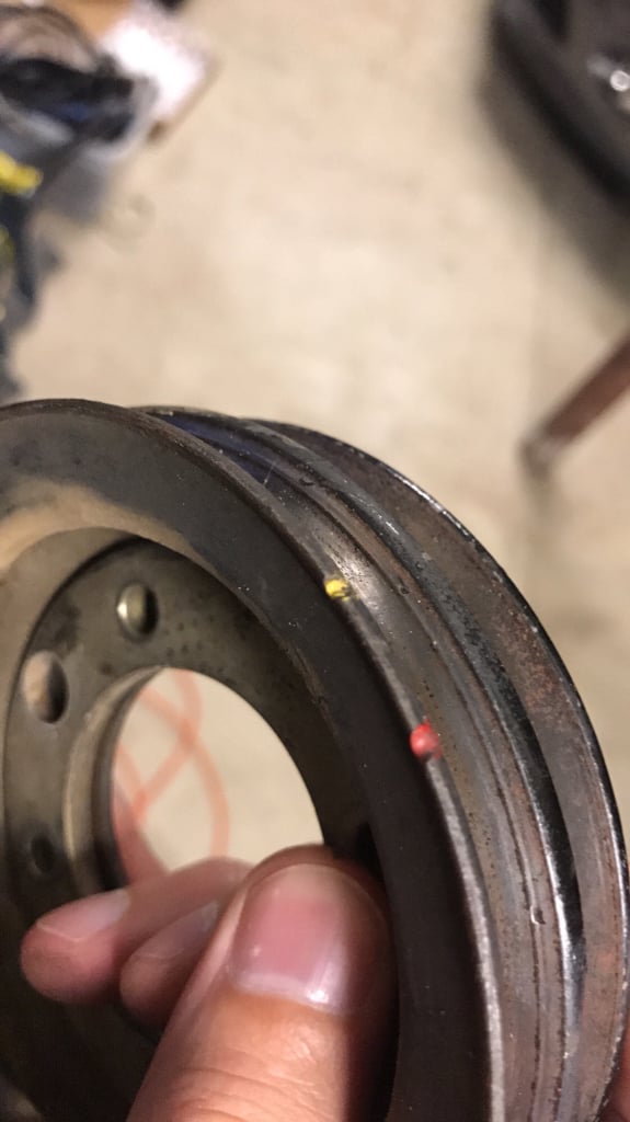

For timing, I locked the ECU at 0 and set the timing based on the original pulley that came with the truck. The manual says it is 0/-10. However, the previous owner slapped a sticker on the hood that mentions -5/-15 so I may be off by 5 degrees. Anyway, it will idle, at 0/-10 but it’s weak and hard to get it to settle into an idle after driving or revving. So I bumped it to 5/-5 on the timing table everywhere around idle and that has been working OK. Recently I bumped it to 10/0 to see if that would help. Jury is still out. I can get it to idle at 900-1,000 RPM with any of these settings, but the behavior just off idle and coming down from higher RPMs is what I’ve consistently been having trouble with.

Cool, that’s basically what I see in the base maps for Adaptronic that I have transferred over...assuming I was right about my pulley being marked at 0, not -5.
I watched a video on MCM2 YouTube Channel (mighty car mods) where they upgraded a 2.0L Datsun to EFI with Haltech. They used a knock sensor with the old carburetor still attached to get the timing right before putting the fuel injector throttle bodies on. I feel like I need something similar to lock in the timing table so I can just mess with fuel after that.
So is the issue you don't know what the marks on your pulley are: 0/-10 or -5/-15? I'm pretty sure 0/-10 was the stock target for the older 13Bs. I'm not sure where the -5/-15 would have come from. One solution would be to pick up one of Racing Beats main pulleys to check since they're marked and include 0 deg. You don't have to keep it if you don't like the underdrive aspect. I forget, what are you using for your crank angle signal?
I have an Atkins Rotary pulley kit, but I transferred over the marks from the original pulley on the truck. I assumed they were 0/10 but recently I noticed this sticker placed on the hood by the man who restored the truck originally.
When I set the timing. I locked it at 0/10 and used the S4 crank angle sensor to adjust timing. Then on the timing table I have experimented with everything between 0 and 10, they all work, but as I said above, the motor doesn’t like to drop down into a strong idle, it seems to bounce around sometimes, and other times it’s fast, and then sometimes when coming down from higher RPM it just goes right past idle and hiccups. It’s been doing that less lately, but I still don’t have what feels like a strong solid idle.

I went and looked at the '75 and '76 REPU FSMs here: http://www.wright-here.net/cars/rx7/manuals.html and in both the stock idle timing is given as 0/-15 BTDC. It also appears that the stock pulley should have three marks: 0 deg BTDC, 15 deg ATDC and 20 deg ATDC. The last one is a "leading retard" mark. Have you tried adjusting the split at all?
