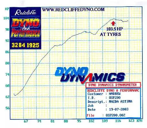

for reference, i got 103.5 on a dyno dynamics
attached is the graph

It's surprising how low of an RPM KYREDP5's peak HP is, Andrew what was the rpm @peakHP for yours?
unfortunately i dont know because of the stupid machine (the speed is miscalibrated)...but i'd guestimate it to be around 6200rpm
