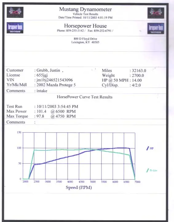

well the mustang dyno info was very helpful...but what i still dont understand is how there could be such a difference in whp between the cars....is it just cause of the lack of a cat-back...? Also i wasnt clear on why the mustang dyno always factored in the weight even though the faq said that it was only necessary at the beginning like with a dynojet?
if his cams were tuned we would have seen a lot more power from his car. but untuned it seems they actually hurt performance.

here is my dyno chart
sorry it didnt turn out that clear. i will try to post it in my thread for a clearer pic. i just dont know how

Actually what i really dont understand is why the car with cams has 94 and just an intake and exhaust have 101. I believe the 101 cause whether it baselines at 89 or 96 its still a decent gain. But for the cams not to yield much is surprising. obviously a cat back would really improve them. Then i would like to see a comparison. ALso have u guys raced...who won? ALso that dyno sheet kinda looks weird. Usually they have spikes and arent that smoothed out....
any part you put on your car that requires tuning can actually hurt performance untuned. i think we will all be suprised when he gets cam gears and has them tuned. his hp didnt start to really climb until right before the rev limiter kicked in.

Well here's what's going on:
I'm having the cams checked this week to double check the alignment.
My spark plugs are 28k old, I doubt this would make much of a diffrence, but it's possible.
I will be buying KYMP5's axleback as soon as he gets his new on in. Shortly after that I will have a mandrel bent midsection.
After all those changes are made I will dyno again.
I still think my biggest bottleneck is the Exhaust. Like I said before, I "gained" 4 whp when they took the probe out of the tailpipe. That pretty much tells me exhaust restriction is the problem.
Just for s**** and giggles here's what other's have put down on a Mustang dyno: (thanks to Mazdacub)
5sp stock = 86 WPH
5sp with intake = 89 WHP
5sp with intake and ground wires = 89 WHP
Auto with intake, ground wires and exhaust system = 89 WHP
So overall I don't feel bad about it at all, I think mines was a normal dyno, and Justin just has some freak of nature P5. :D
Edit: and just to toss something else out there for everyone to think about, our intakes were at diffrent angles. :D Mine was more level, while his was angled way down. :D Again doubt it would make much a diffrence but something to think about.
