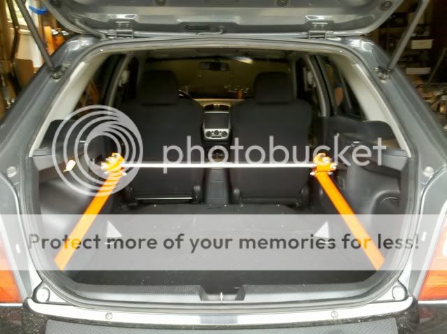

Affirmative. JT, you might want to upgrade your hardware too, man. I understand why they only used the M8 bolt there because the hole is already there and most people won't buy a product that will need holes drilled/tapped. But why would they use such huge spacers with all that room in there? It's pretty simple to drill and tap it out if you want. I used an M12 x 110mm 1.75 thread bolt.
I mean, yeah they look cool. But the design won't really offer very much structural support...

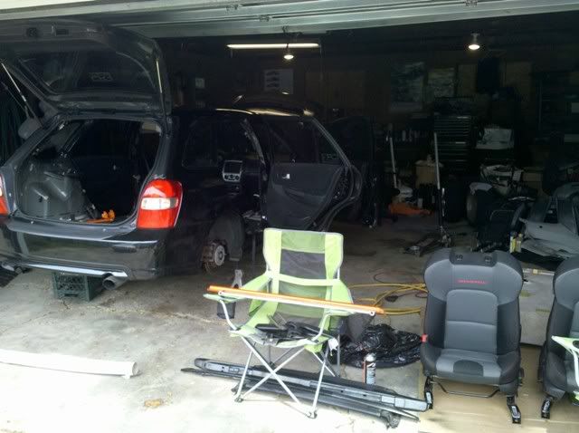

I took over the entire garage. It looks like the interior exploded. haha Don't worry, Phen, it will be cleaned up before you get home.

The roof racks are off. It wasn't as scary as I thought it would be. I thought I would be able to just plug the holes and use 3M tape to secure the filler strips but the OEM clips are $1.65 a piece so I ordered some from OnlineMazdaParts.com. Still not too sure how they mount to the roof though. It looks like the two that are still installed are just double side taped in there.
I also installed the CorkSport shifter bushings on shift linkage. I'm going to wait to install the CS bronze bushing until after the swap since it will be a different trans and linkage.
Off to Autozone for some grommits for the roof rack holes, new wipers and black caliper paint.

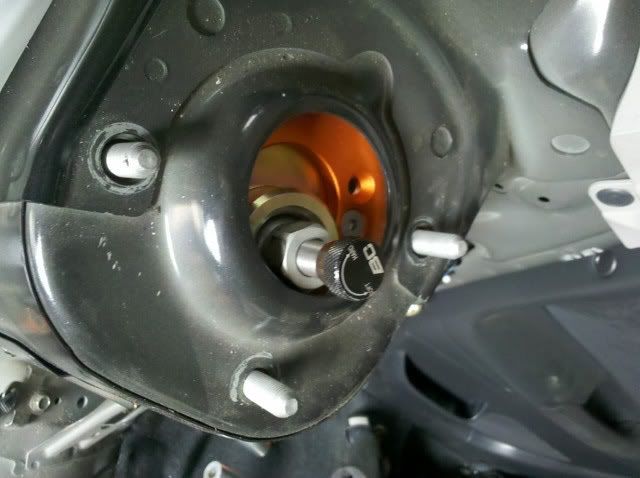

I got the rear camber plates in. The way the bolt pattern is on the P5 they don't mount perfectly straight like the fronts. But AAC said they got -1.5 degree of camber out of these plates. So we'll see when she gets aligned this week.
Is the body preventing you from getting more adjustment? LOL, if I ran into that with the RX-7 I'd be attacking the body with a cutoff wheel in a heartbeat! I also noticed the same thing about the GT Spec rear cage, but I didn't do anything. I'd almost look to see if you can find a solid aluminum block to drill through rather than the little cylinders GT Spec provided. Might add some more stiffness...

Nah, these camber plates aren't slotted like the front. They just have 2-3 mounting points so I went with the most negative camber. They cleared the strut towers just fine, no worries. :)
