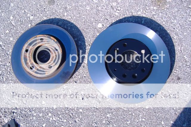

Just a note, although I think you know this. The MS6 rotors measure out at 12.6" in the front and 12.4" in the rear. The only ones bigger in the front are the RX-8 at 12.7".... Just a bit of info for you.
Ripped from PT:
"Every model of Mazda6 front brakes fit our vehicles [PGT], if doing this setup; you must be consistent with the year model you are using. So if you by calipers for a specific model, you must buy the matching rotors and pads. Parts are not interchangeable between models. Here are the specifications of the different models and what wheel diameter is required for them to fit:
Disc diameter:
03-05 Mazda 6 => 11.1" => Fits no problem with a 16" wheel
06-07 Mazda 6 => 11.8" => Fits no problem with a 16" wheel
06-07 MazdaSpeed 6 => 12.6" => Must have a 17" wheel minimum"
With 280whp on tap, I think a few lbs in rotational mass will be almost not noticeable. And if it is, it's a small price to pay for not having the thought of brake fade dangling in the back of your mind while ripping up the track. You'll be at around 3x the power that the P5 came with, and those stock brakes are definitely not up to the task of hauling it down to 60 from 130-140mph on the back straight of Mid-Ohio lap after lap.
Ripped from PT:
Disc diameter:
(Pic here)
I bolded the quote for reference... 17" rims are a minimum, but some may not work because of inner diameter. Please note back to what I said about a MS6 owner with 17" rims and needing to grind a little bit off the caliper to make them fit.
Yes, 17" rims will fit but they will have to be the right ones and a test fit may be needed.
As far as specific models of calipers go.... I do agree if you are talking about the difference between regular Mazda 6 and MS6, however if the RX8 rotors may be an option as .1" is really very minor.
I will let Evan research this fully and come up with his own conclusion and I really am curious because it may open windows for my MS6.
Edit: Also, Evan will have my old MS6 rotors to use for testing.
Shae, anything you want to include with the P5 would be awesome. But I don't want you to feel like you're getting ripped off, ya know? Want to throw in the RSB, Blizzacks and car cover? Of course I'll say yes. haha. But honestly, I've already got a Progress 22mm rear sway I would put in, the car won't see winters so I wouldn't need the Blizzaks but the cover would be aswesome when she's sleeping in the garage. But even if you want to throw all your extras in and I can sell them and send you a good chunk of the money they sold for. It's up to you. :)
Chris, PM me a price on the rotors. I looked up new (rebuilt) calipers from RockAuto and they're about $120 each so it's not too bad. Some clown wants $300 for a very used set here on 247. But I would swap both fronts and rear to make sure everything is still balanced on the chassis. I can't really see where upgrading rotor/caliper size would "hurt" any performance, per se. And I can check rotor clearances with my wheels when I have a setup on the P5. After more research is done of course. haha. But it would be nice to have MS6 brakes on the P5 for sure.

Just an FYI, our e-brake cable does not work with the rears, and you need to flip the calipers to the opposite sides so the bleeder is in the right location. I think some people made custom brackets for the rear to fit, but I've never seen any pictures of them.
Evan, been meaning to ask you, do you want any of the extras with the car?? The un-installed RB rear sway bar, blizzaks, etc? Since you're having the car shipped I'll be limited in what I can stuff in it... :(
Shipping companies don't like when cars are loaded up with stuff. I got an earful when I got the Bav because the previous owner loaded the trunk and back seat with stuff. Just a heads up.
Check out EBay and message everyone. I was able to find a few guys selling Calipers and brackets for $40 each.
I'll get a price on rotors for you. Slotted only?
I'll look into more when I have the suspension sorted first. But yes please, StopTech slotted. Thanks!
Thanks, mate. I'll look into it more. We talked a little bit about the bleeders. If they're in a wonky position I can put in some speed bleeders so air won't come in. There is a valve in them so they only flow out.

Just a heads up idk if you've made any purchases yet but theres a guy that put up a ms6 front brake setup with rotora rotors for sale on probetalk
Thanks for the heads up! I wish they weren't so rusty. I'll send him a PM at lunch, $400 seems a bit steep.
I need to ask Jon or Fez if I can test fit my wheels on their MS6's before I buy anything though.

Well, more is more, right? The MSP kit was designed for a stock MSP. I'm sure that would be plenty fine for my application but if I'm going to upgrade components anyway, why not upgrade them to the parts I really want? Plus upgrading/modding is the whole part of building a car. Heck, a stock P5 would be plenty for me on track but building this car is the reason why I'm doing it. The added bonus is it will be quick-ish. Like the Lego metaphor again, I liked building the Police Station a lot more than actually playing with it. Ya know?
