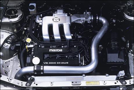

PrjectBlack, if you have a general knowledge of mechanics and wrenching skills, you can do it. I'm no mechanic or genius and I got mine working with the help of a few friends. I would opt for the KLZE though. 30 more chp than my KL"DE".

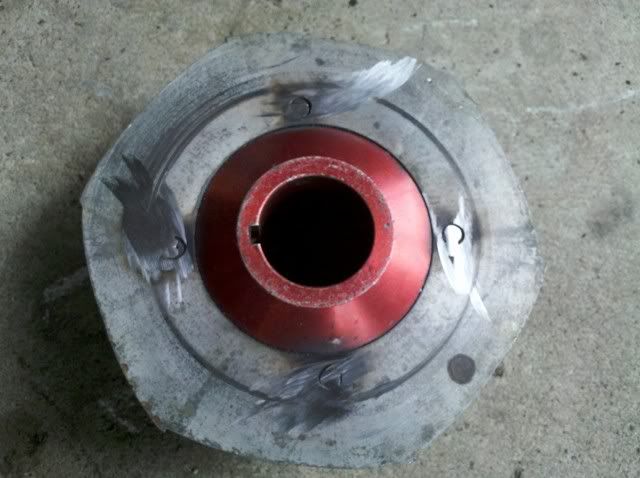

In other news, I asked Josh to weld the screws in place on my UnorthodoxRacing underdrive pulley last weekend and I smoothed the welds out this weekend. Apparently that's a flaw with the UR pulleys. The screws come out and the metal plate the crank sensor uses creates havoc. Well mine's not coming loose anytime soon. I'm going to order some new belts and install this next weekend. It's MUCH lighter than the stock crank pulley.

-Buy a true, straight neck KLZE;
ZE's have 200chp (as opposed to my JDM KLDE with 170chp). But ZE's have a tendancy to drop valves because of the valve retainers, so just swap in some from a DE or aftermarket. And I would slap a curve neck intake manifold for the lower torque band and so you don't have to relocate your battery.

hey my battery is in the correct location :P. Also, the issue with the curve neck is that the vris points are different from the straight neck so a stock ecu with the correct points is hard to come by, where the straight neck u can use a kl31/36 ecu and je50 vaf they arent terribly different and will work just fine, just not optimal. I do agree on removing the protege harness and combining only what is needed is a cleaner way. As for the dropping valves, anyone that looks into the KL will find this, however its really only the majority of 7k+ rpms drivers that experience this, I know there have been a few that have not revved that high and have drop valves, but they are not as common. And like mentioned just get USDM DE springs, retainers, keepers. As for the MAF vs VAF there are tons of arguments over it. In boosted engines definitely a plus, however the VAF is not as restrictive as it looks and very little power gains have been shown with the MAF on a N/A engine.
