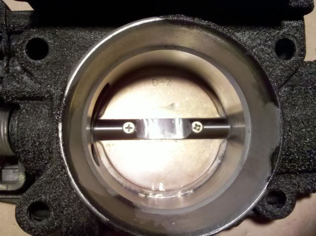

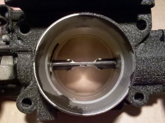

Well, it took me about an hour of meticulous cutting, grinding, sanding and polishing with the Dremel tonight but I hour-glassed my throttle body butterfly. Every little bit helps! heh-heh

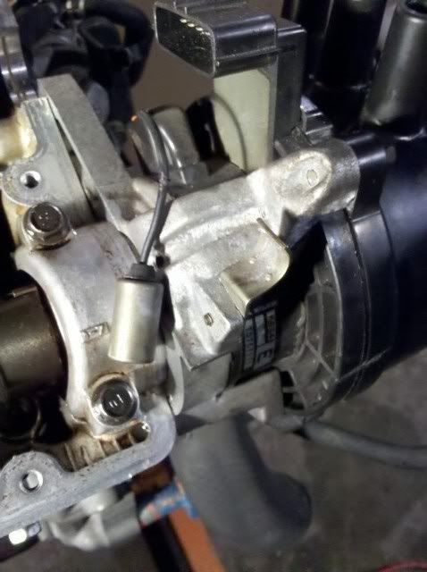

I have a question about this part on my distributor. It was busted off during shipping. I don't know what it does but I can see it was mounted in the little metal coupler. Can I just carefully solder it back in? Or do i need to do more research and find out what it is, what it does and how much it will cost to replace.
What about dremeling down the other parts of the throttle plate stick thing on the outside of the screws? Or would that compromise the structural integrity of the piece?
that is a resisor I can take a pic of where is goes. As far as the tb remember you have coolant running through the boby there so do not go hog wild on the outside but that is as far as I would push the shaft.
You can also cone the TB to get rid of the step in there..

Wes, I think I'll just leave the TB how it is. It took me a long time just to remove that much material. Keep in mind there isn't much room to work with in there either.
Jon, I see the little bracket, curve section where it goes and where it looks like it was spot welded from the factory. I was just wondering if I could use some epoxy or solder it back into place instead of buying a new one.

I am talking about the TB. There is a step in the TB before the throttle plate.

Yeah it is not the valves that make the ze an interference (that is a debate on probe talk). Lewis you got the best block setup for turbo without forgeing there. The only improvement is that would be easy would be if you could get the lighter crank out of the klg4. The milly rods are stronger than regular de's and g4's. And the resistor reads off of resistance so soldering it may work but may cause issues too. I recommend a new one. Save some head aches down the road.

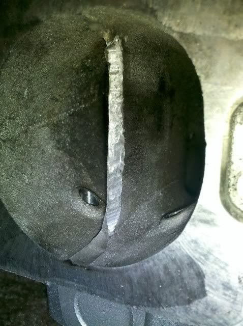

Here's the knife edge of the IM I did. I should've taken a before pic for reference but meh.

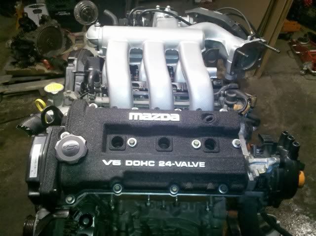

Well Pablo and I got the timing belt on last night. It took a couple tries but i think we have it aligned right. I turned the motor over twice and everything was still aligned. And because I'm freaking paranoid I turned it 4 more times. It still lined up okay. Got the timing belt cover back on and FINALLY put the valve covers back on. I'm still waiting on my bloody intake spacers so I can match the oval/square runners. They shipped Friday Dec 10th from Indy which is only 5 hours west of me. Then the USPS tracking number says they were in Harrisburg, PA on Monday, which is 4 hours EAST of me. Now they are in freakin Philly. I hate you USPS! ugh
But I took a quick pic of the motor. It's coming along nicely.

Oh, and that broken resistor just simply unplugs. So hopefully I can find a part number to replace it. It's pretty confusing with all the different variants going on with this build for ordering parts. Hell, I don't even know what year the motor is. I tried ordering belts from Autozone by just giving the guy the part numbers and he insisted on looking up the car make/model. So I told him; It's a J-spec Mazda Millenia motor going into a Protege5. So he just used the part numbers I supplied him with. haha
