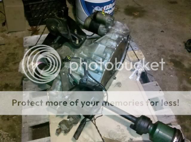

And I just unloaded my transmission from the truck. I'll unwrap it and bring it home tonight. It came with the starter, half shaft, tranny mounts and clutch and flywheel (even though I'm not using those). The half shaft and starter are the parts I really wanted anyway. Just cross my fingers the bolt holes line up for the halfshaft mount to the block. I've read the years are wonky and are all sorts of different bolt patterns.

edit- peekturs are fun. The trans is in the garage now AND my tranny saver brace will fit, phew. There are some transmission mounts that were too thick and wouldn't work with the brace. But mine bolts up fine.
