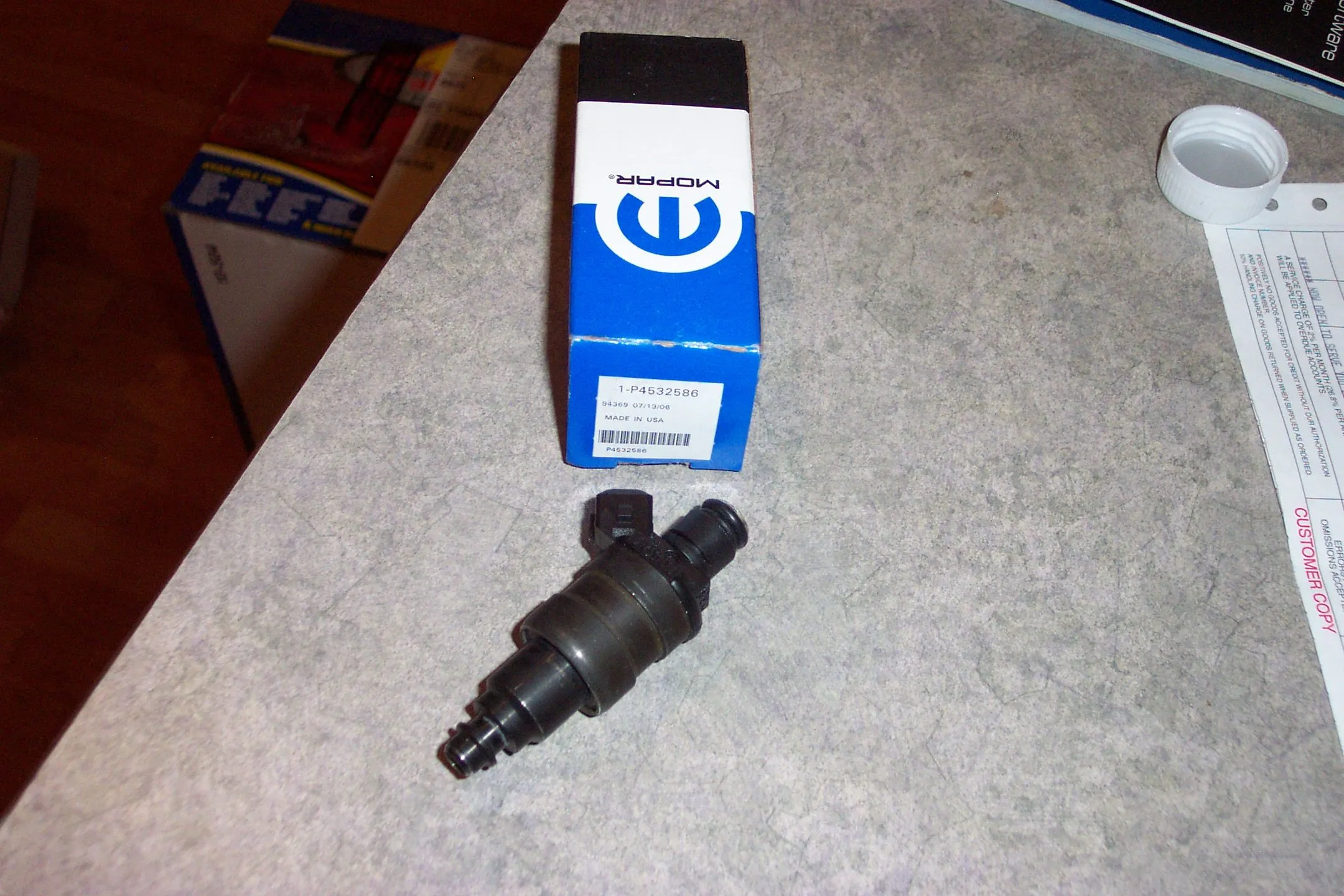

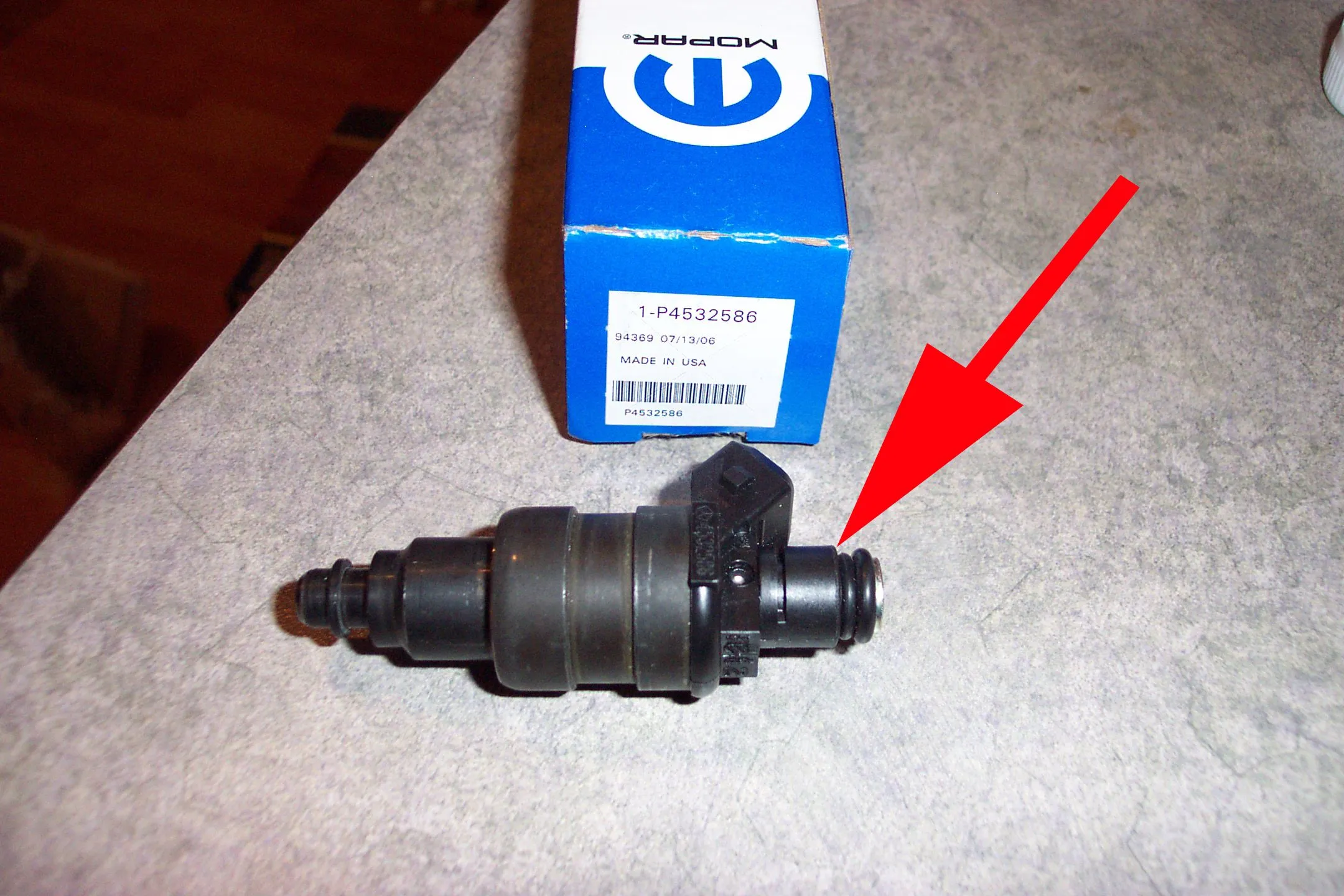

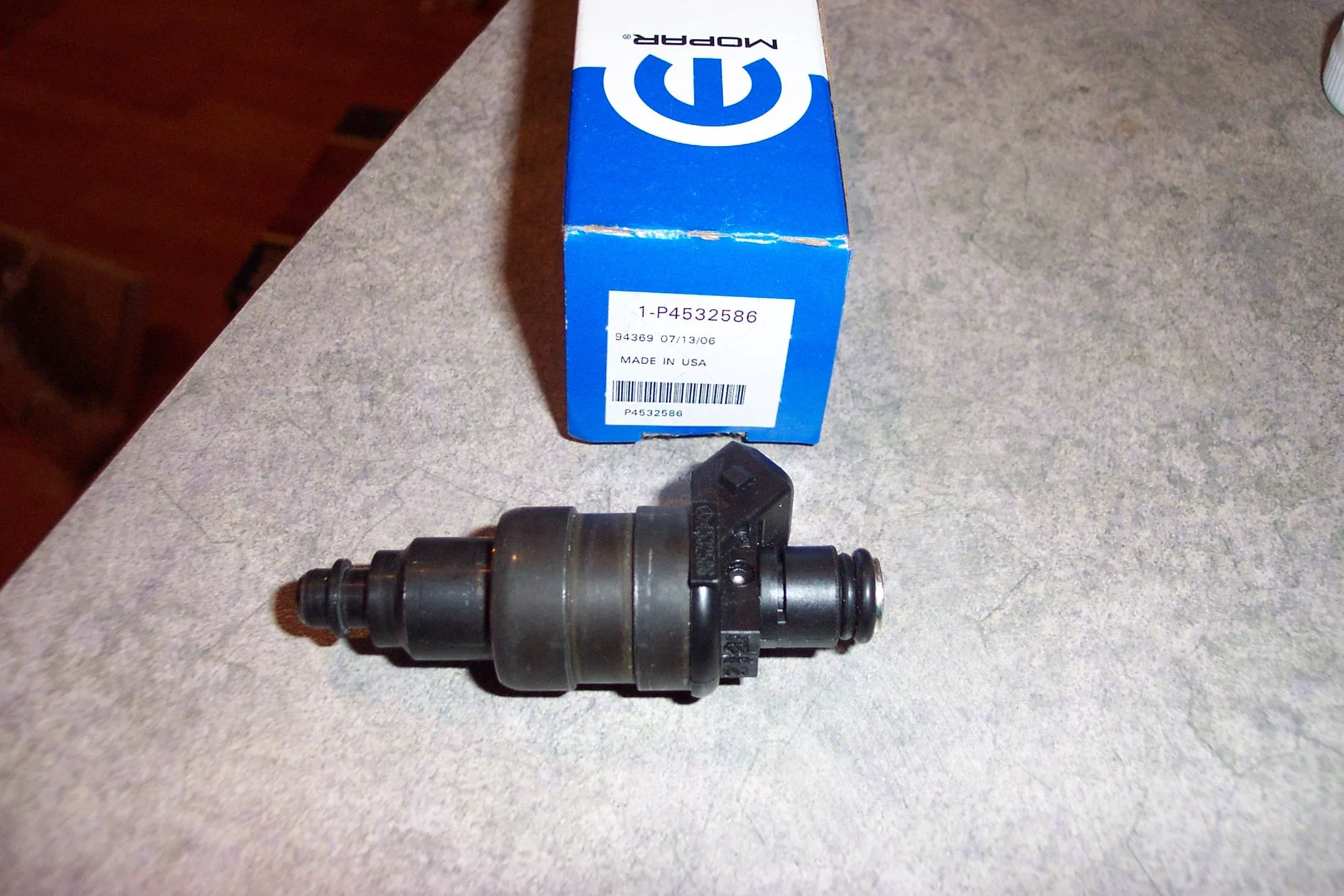

I went to install your 550's that you sent me today and they do not fit the OEM fuel rail. I think you may have sent me the wrong injectors as they are a different MOPAR part from what you are reffering to here and they are definitely different from the ones pictured on your website.
Attached are pics of what I got from you. Note the part no.
Tried to phone you but just got the answering machine...
We are now in the process of wiring the old clips back on so the OEM injectors can go back in to get me home. Drove 200 km to my shop to do this today... :(

Those are the right injectors and the right part number... the part number you quoted is WAY off... I verified those injectors and they do fit when installed properlly. We've sold dozens of sets... so the problem is not with those parts man. Sorry you guys had problems and that I missed your call, but the parts are right!
I guess I should have taken a picture of the injector and the fuel rail. They physically do not fit in the rail. That is why we had to abort the whole project.
I will ask my shop to speak with you directly about this I guess. Man, all I want is for this to work. :(

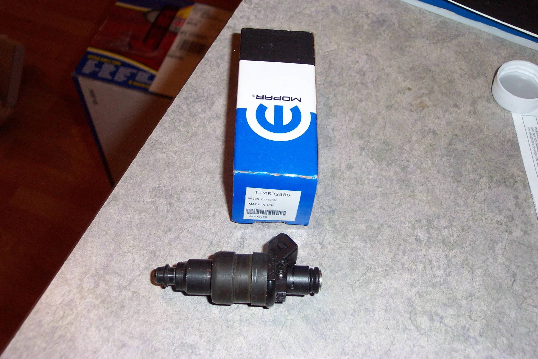

This is how far these injectors will insert into the OEM fuel rail. What am I missing here?

What you show is correct. That shoulder will bottom out into the bell mouth of the injector port onthe fuel rail. the o-rings go up far enough into the port to allow for it to seal up and not leak, especially once tightened down properly. I know it may "seem" weird but we have plenty of these out there with no issue at all with sealing and so forth.
Also, you need to take the insulators off the tips of the stock injectors and put them on the tips of the new injectors so that they seal correctly in the manifold.

I see. Valuble information... that I could have used yesterday. Sounds like the injectors basically sit in the manifold and then the fuel rail as tightened down over top of them to secure them in place.
