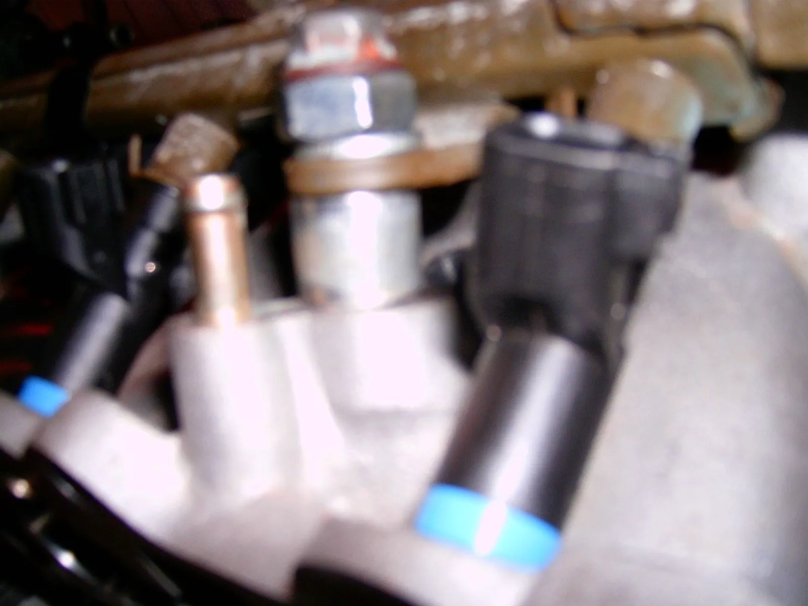

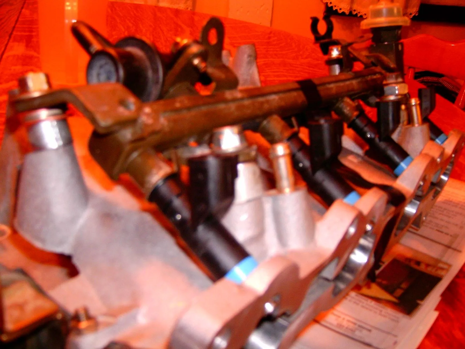

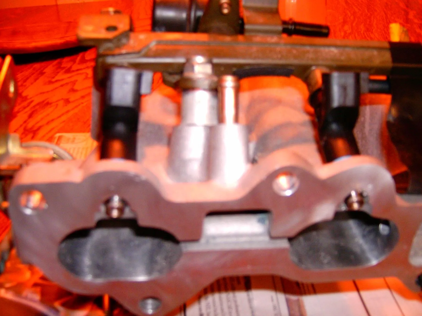

Hold the phone :(. I just fitted them on a stock manifold and they didn't line up right... so I'm trying to figure out what is up with that as I didn't believe that section of my manifold had been modified at all by Terry.. time to dig through pictures.
Heres my 577cc injectors on the manifold with some mock up spacers. I have a one more spacer to make and then get them to fit alittle better. (I made them a little long on purpose.) I am using the wiring harness off of a Mazda6 2.3l. as the clips are the same.
They are srt-4 Stage1 injectors. High Impedance (they are 1 ohm lower than stock resistance).
As a side note if you have a Mazda 6 or 3 2.3l, They will fit that rail perfectly, same clamp clips, wiring harness clips and everything.
