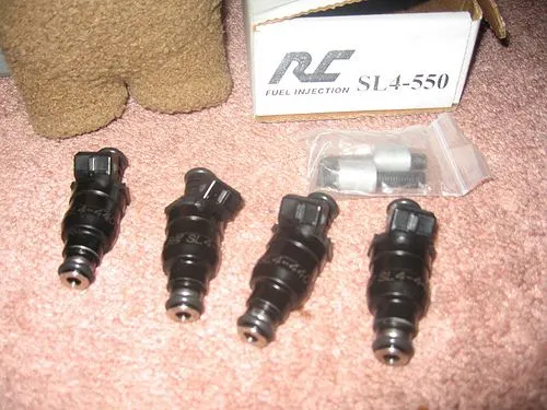

Will these RC440 injectors work with the P5 harness and rail?
Looks like the bolts with spacers are close, but the o-rings are wrong, and the connectors are wrong. So they won't fit in and seal up proper and you won't be able to connecto the the harness.
BTW... our full 550cc package for use with cars that can handle low impedance injectors (Haltech or Microtech) for under 300 bucks... Just in case ;) LOL. But yeah, sorry what you have 'as is' will not go in.
