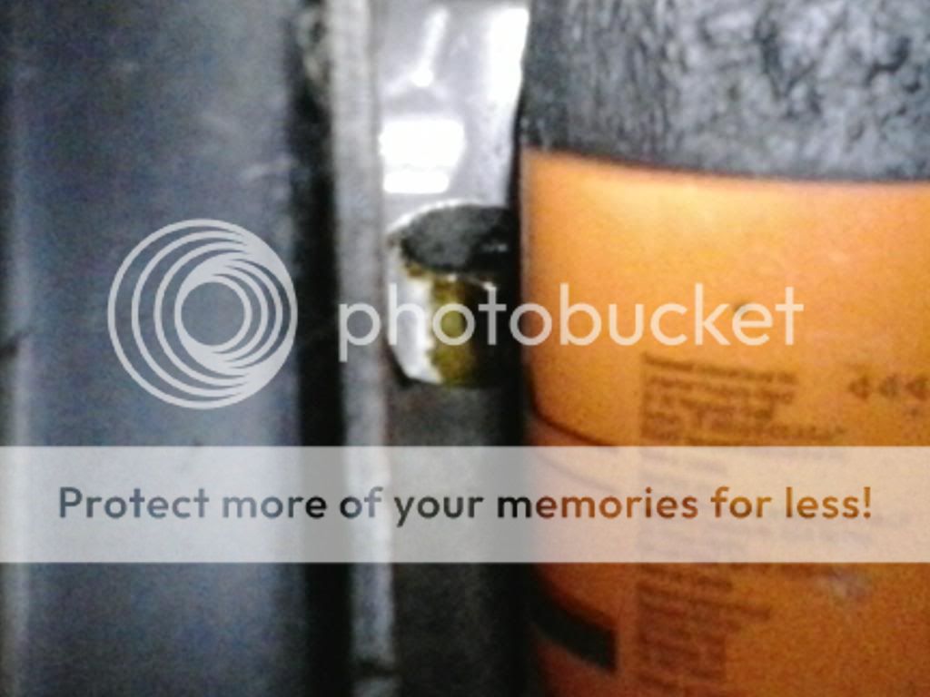

I was curious about my knock sensor and didn't like the look of the "goo" dripping from it.
After reading about the knock sensor and it's parameters, I was concerned that my knock sensor may not be sending data and that my ECU may not recognize it.
So I decided to try to "fool" my ECU by replacing the knock sensor with a 560 kohm resistor to see what would happen.
I went for a drive and while watching my UltraGauge for engine load, temperature and the five second rule, my CEL did go off (code 0325),... proving that my ECU does indeed monitor for actual data.
I didn't notice any "pinging" that I would expect even during the first 4 seconds before the ECU reduced the timing advance because of the code. I'm guessing that may be because my engine is in great shape with no carbon buildup (regular seafoam treatments), no oil burning and I passed emissions with almost NO measurable pollutants (1 or 2% of what is allowable)
I then pulled out my resistor and got the same result.

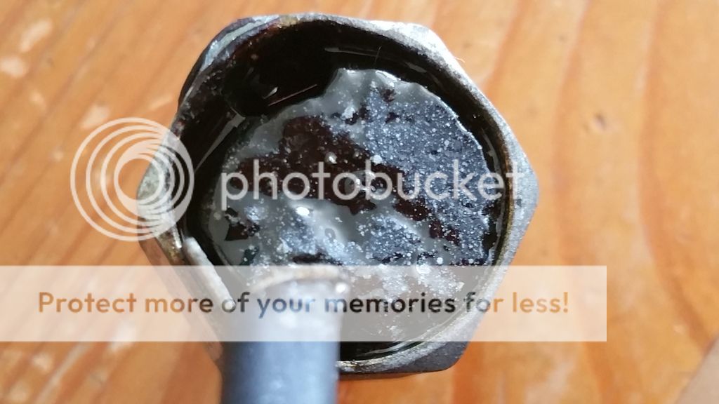

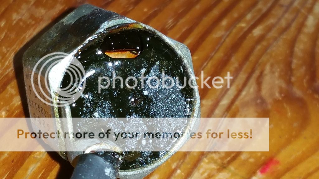

HOWEVER,... I am still concerned about the goo dripping from my knock sensor. I'm thinking that the "goo" is the suspension that the accelerometer floats in (if it's not an "air suspended" crystal) and if that is the case then the sensor may be giving reduced signals due to the lack of free movement within the sensor.

My advice is that if you are experiencing any pinging,... definitely consider a new knock sensor. An old "gooey" sensor may be giving just enough signal to not set off the CEL but not enough to stop the pinging.
They aren't too much money so it might be worth "throwing money at" to find out if it stops your pinging.

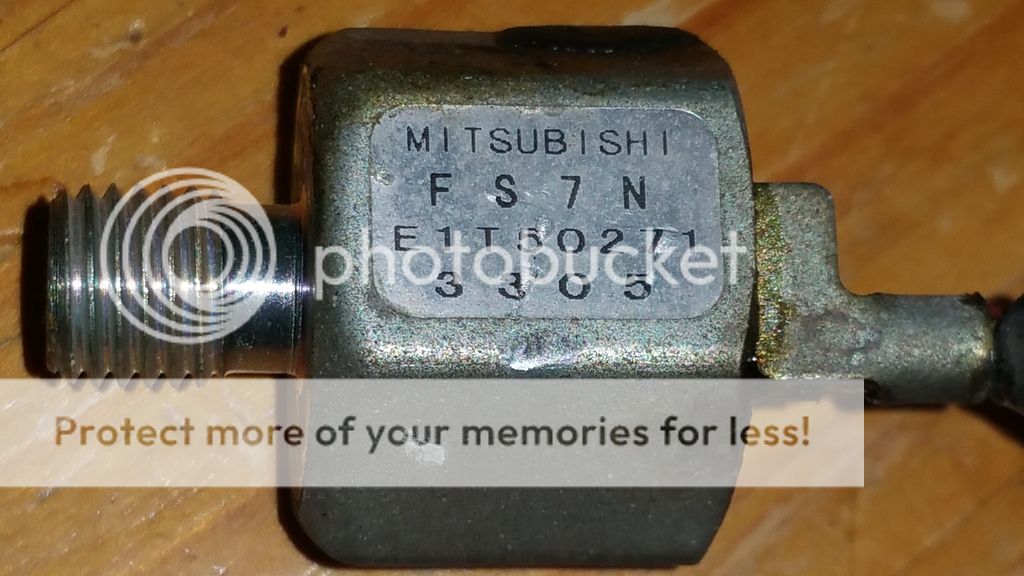

Sorry to bump an old thread, but when I replaced my knock sensor with the Beck Arnley one I noticed the one there was the same mitsubishi part I got from Beck Arnley. After looking at a picture PCB posted of his knock sensor, it also looks like he has the same mitsubishi part. And the pinging I was having has gone away.
Just an FYI for those that want to replace theirs.

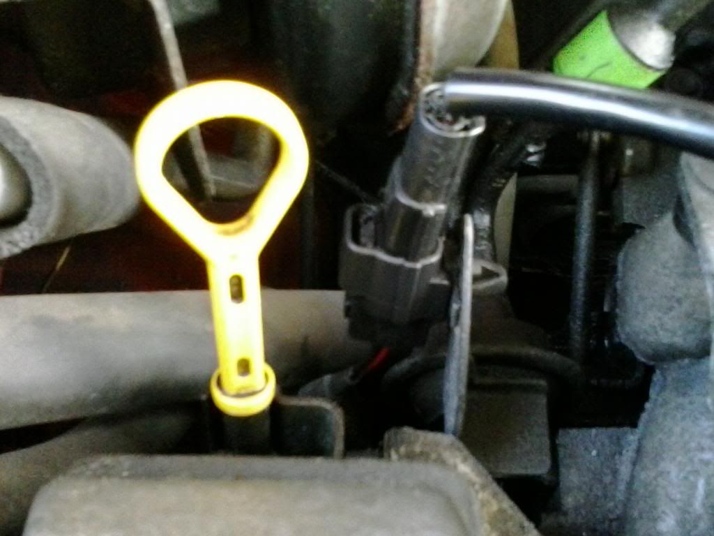

To PCB thank you so much because this thread post really helped me out to Pin point the Location of where the Knock sensor wire is located. No body on this Forum was able to answer it the closest answer i got was yeah its up by the driver side Lol! This picture shows it all and yes i did buy the Beck Arnley one.
