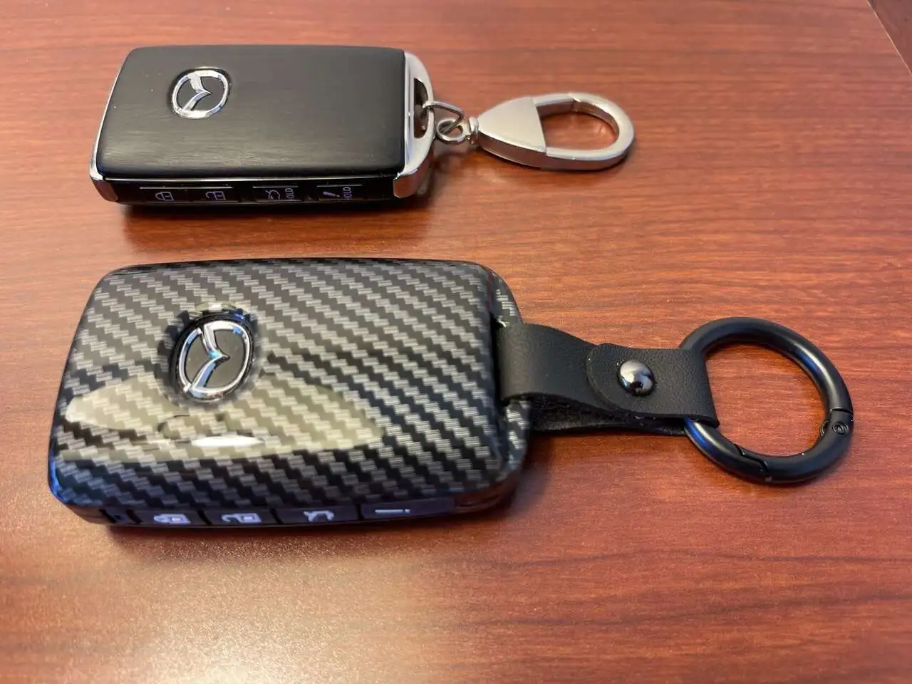

Hopefully that’s just the perspective of the photo angle, that the new fob looks that much bigger than the old one. And I thought that the old one was way bigger than it needed to be. Soon it’s going to be like dragging a paperback romance novel along with you.
Yes, it is the perspective. They are both the newer keys but the one in front is in a case.
