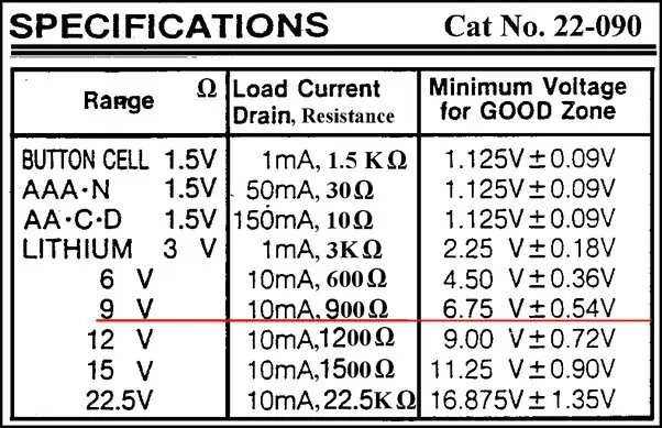

I'm trying to find out the proper load resistor value and got various results searching the web...One guy said 4.7K for a CR2032. I have a 5.6K and used it on a spare CR2025 I have for the garage opener. 3.28V no resistor 3.08V with the resistor. I also tried an old CR2032 and it read 2.78V no resistor .45V with the resistor. At least, it gives me a good idea of the battery condition. The chart below shows 3K; I have another 5.6K so I could put two in parallel resulting in 2.8K.

The chart above seems reasonable test loads for various battery voltages and mAh (capacity) batteries. Simpler testers, like above won't load AAA ~ D cells like the chart shows as they don't have switches to match the battery type. There are testers with individual slots, where they provide a custom load for each battery type.
BTW, for lithium button cells, 2.25v under test is fine, in my experience, for a typical IR remote to work reliably, but for many auto FOB's I've found they need to stay above 2.7v under test (my Pilot FOB, 3.0v) for them to work reliably.
