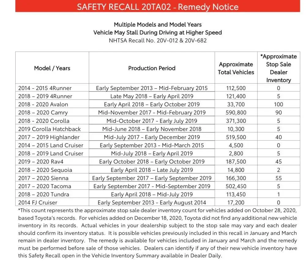

Toyota/Lexus recalls stretch back to 2013's and ahead to 2020's. This raises all kinds of possibilities including multiple unrelated problems with or without different Denso model pumps with or without different manufacturing plants.
So if its the same Denso fuel pump that has been known to be an issue for a long time, why did it take Mazda over a year to notify owners compared to Toyota.
Is it the same Denso fuel pump as the Toyota? Are all Denso recalls for the same pump for the same reason? Are all Denso pumps of a particular model being recalled or only specific production runs? I don't see where these things have been established in these pages and that link above is as deep as I'm going to dive since these questions are probably unanswerable.
Maybe Denso is a generally lousy builder of fuel pumps. Some would say the same of their transmissions. Didn't Mazda dump Denso for transmissions and started building their own?
Safety recalls start with failure incidents followed by a considerable amount of backtracking detective work and product testing to figure out which models and production runs might be affected. I would not assume Mazda was foot-dragging. Maybe Denso was foot dragging. Maybe there was no foot dragging at all.
Consider the Takata airbag recall--100,000.000 vehicles and counting stretched over several years. It takes time to sort out the good from the bad in which applications whatever the issue may be.
Can you tell me when Toyota determined some 2013 fuel pumps were bad? It looks to me like it was 2020. Was that foot dragging?

I dont think they determined it in 2013. The recall evolved and more models were just added dating back to 2013 production dates.
If I am not mistaken they started noticing it sometime in 2019.
It is true though that Mazda is the last to issue the recall. After Toyota, Honda, etc
Lexus recalls go back to 2013 models. A Lexus is a Toyota as far as I'm concerned.

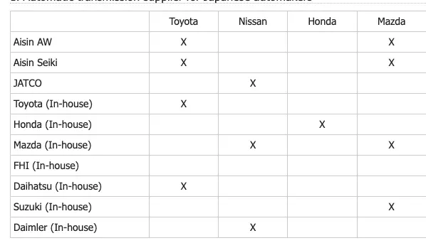

Wasn't aware that Denso even made transmissions. Aisin Warner perhaps.
I stand corrected. Denso makes peripheral transmission components, not units in toto. JATCO, not Denso, is what I was thinking of.
JATCO? Didn't they make the CVT transmissions that Nissan has had so much trouble with?
I'm not up on that. I was correcting myself about Mazda having used Denso transmissions--it was JATCO before they started building their own.
In-house production at Mazda​
Automakers are shifting from ATs to CVTs for small vehicles in Japan and other markets. However, Mazda has developed the 6-speed Skyactiv-Drive AT that is mated with new engines by using Mazda's unique Skyactiv Technology. Mazda currently produces the 6-speed Skyactiv-Drive AT for gasoline and diesel engines, and mounted it on the CX-5, Atenza, and Axela. 4-speed and 5-speed ATs are also produced in-house. Mazda procures 6-speed ATs from Aisin AW, but is gradually replacing the ATs with Skyactiv-Drive ATs as the automaker fully redesigns its models.
Getting way off topic but this list is from 2014. Mazda's use of JATCO transmissions predated 2014.
