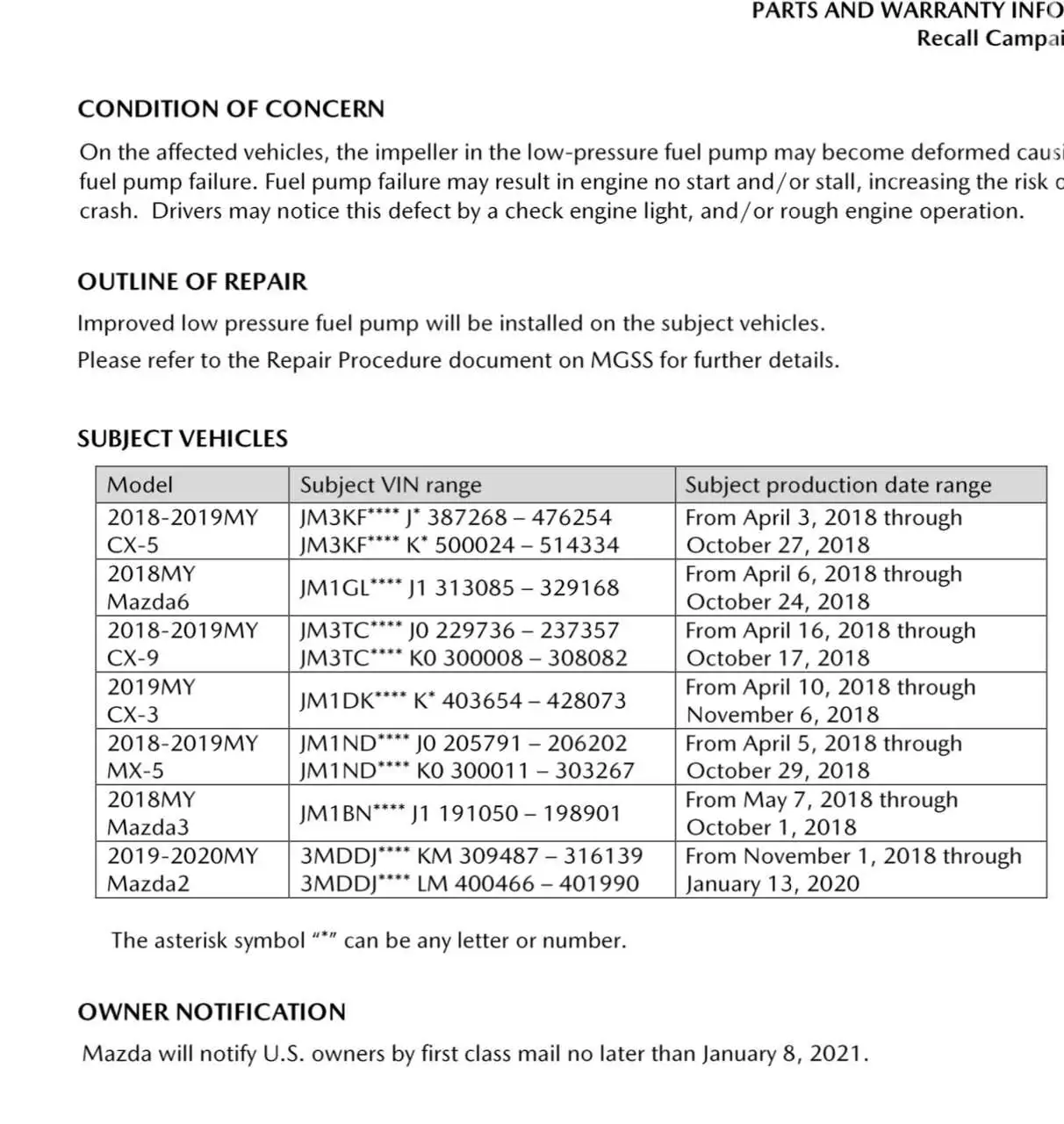

Just received the recall notice for fuel pump

there was a forum thread on this one from a month ago. In short , yes. Everyone with 2018 and early 2019 is receiving the paper mail notice.
Even the Turbo models from first 2019.
No parts available yet, checked last week again.
So sit tight and wait. The pump replacement steps are available (not very easy swap but doable). Most important is when time comes to go to the dealer to have almost empty fuel tank. Otherwise if the tank is full its a big pain and lots of spills probably.
Our 2019 was delivered in Dec 2018. It shows no open recalls. Where did you hear that the turbos were included?
Since CX-9's equipped exclusively with the turbo are included in the recall one can assume turbos are not exempt.
However, note that Mazda is recalling only 121,000 vehicles covering multiple models and years. US sales volumes for recalled 2018 and 2019 CX-5's alone was over 300,000. US 2019 CX-5 sales were 154,543. So obviously not all 2019's are being recalled, and it could be a relatively low percentage, hard to tell.
It's possible Mazda is targeting specific pump production runs.

Ok, I can see from that list that no CX-5 turbos are on it. They went into production in November 2018.
I dont know about dates but the recall has a part number listed for a Cx5 awd Turbo.
How accurate that is - no clue.
My 2019 CX 5 GT-R with the 2.5L turbo engine has a build date of 03/19 on the door jamb sticker. I checked the VIN for recalls on this official Mazda site:
No recalls were indicated. I am however keep close watch on the engine coolant level just in case I develop the issue with the cracked head. My CX 5 VIN falls within the range covered by the TSB but I assume since it isn't technically a "recall" it doesn't show up when I search the Mazda recall website.
