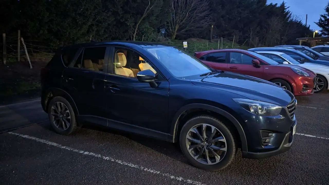

Finally picked it up yesterday, liking it so far! I've been a honda civic guy for a good few years, so taking a bit of getting used to, but really enjoying it so far.
Got lucky with one that has white leather interior, makes it feel quite premium.
Thanks for the tips on OBD2 readers, will definitely be getting one!
Here's a little photo of it
