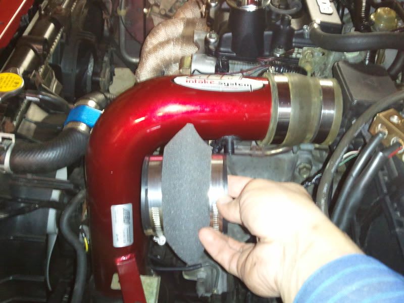

Doesn't look like this thing can be mounted to this CAI?? The air temp sensor is in the way of the straightest part of the intake. The instructions say not to mount it too low on the intake, so I couldn't mount it just above the filter. Space wouldn't allow for that anyway, radiator is right there.

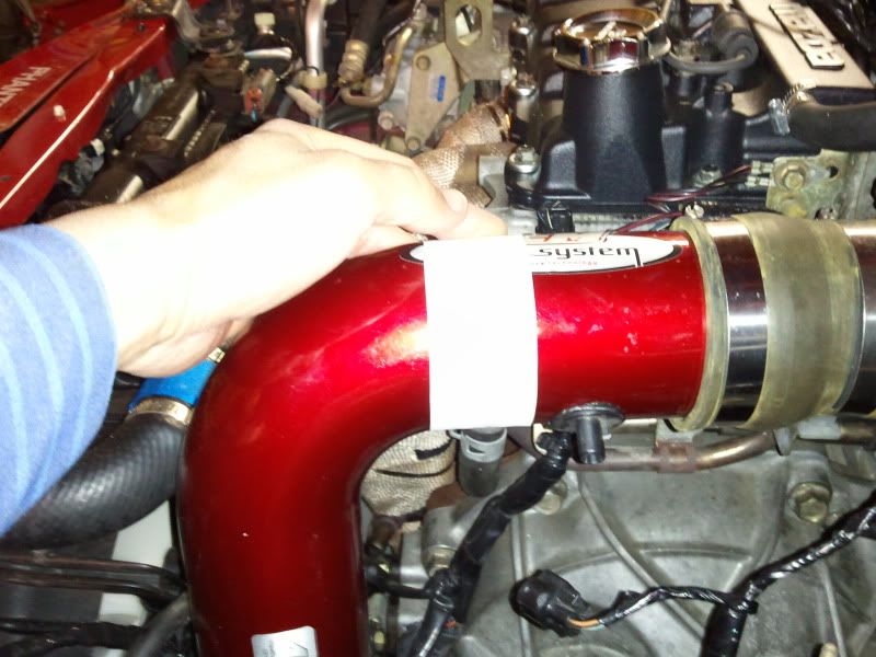

This is about where it would go, but the bend is right there and I'd be afraid of not getting a good fit/seal.
The only solution I could come up with, is putting the template over the hole for the air temp sensor (using the hole as part of the cut-out), and moving the sensor to a part of the pipe between the filter and the valve. I'd have to extend the wires to do this as well.
I'm not sure if it will affect anything by moving that sensor though? I imagine AEM put the hole right there for a reason?
The sensor position doesn't matter a whole lot. I've had mine wrapped up in a plastic bag tucked in my fuse box for the last two years...
You've only got to make one cut not two. The bypass valve will just lengthen the intake towards the front a few inches. You should be just fine clearance wise.
I don't think that'd work. The intake is probably 1/4" from the upper radiator hose as it is now...if it moves forward any, it will be buried into it.
can you put it after the elbow or does that defeat the purpose of them?
Yea, I think it'd defeat the purpose. Instructions say to mount it as far on the top as possible.
I think this whole thing is a little overkill to be honest. All throughout the instructions and information, it keeps saying that it prevents water from getting sucked up while the filter is "submerged" in water. Doesn't say anything about helping when the filter just gets a spritzing or a little bit of moisture, so I'm wondering just how necessary this thing was? I definitely won't be submerging it...not even on accident. Did that once to a civic, I won't be making that mistake again. lol
But overkill is what half of us have done. ha ha ha. Anyway, the bypass valve works because if the bottom filter gets wet the pressure would be higher so the the air would be sucked thru the bypass valve.
