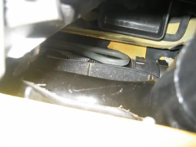

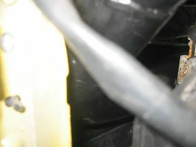

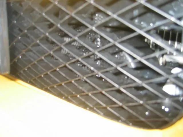

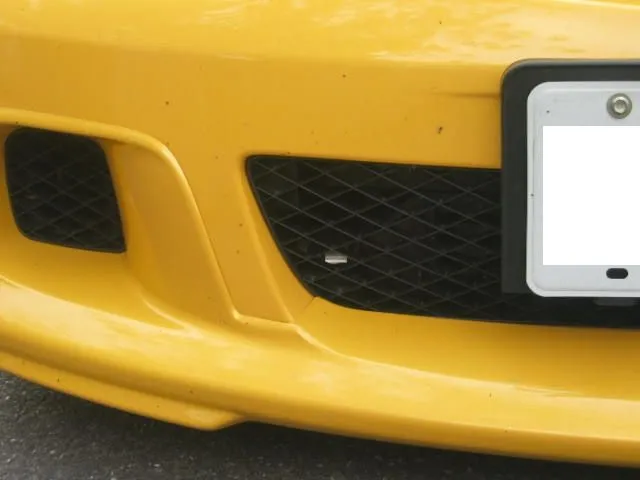

Pics of the stealth-ized FMIC setup
projektmsp said:
post pics or send them to goldenknighte@yahoo.com ...i wanna get an idea of what it's gonna look like thanks alot-Dan

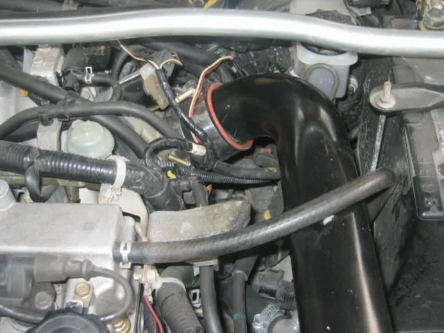

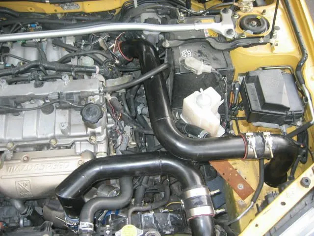

Here are a few pics of the work in progress. Some of the piping has yet to be changed (like the wicked 90 degree bend coming out of the turbo for which a perfect bend is being CNC machined), but the basic layout is shown. Some pics of the piping will be available as soon as the shop emails them to me.
R

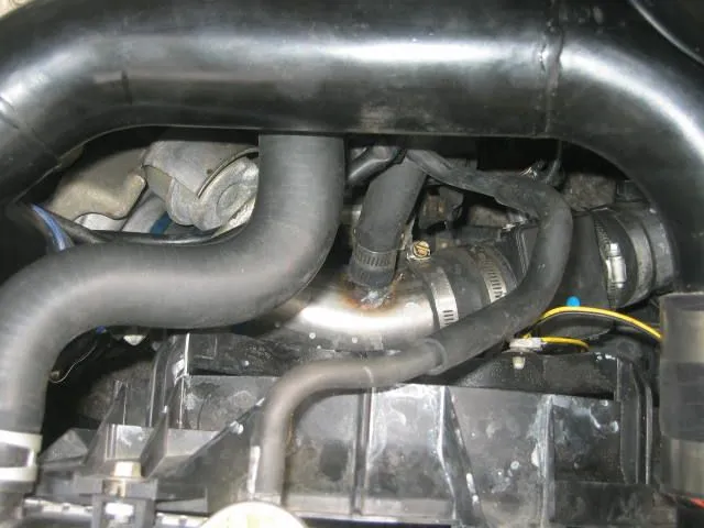

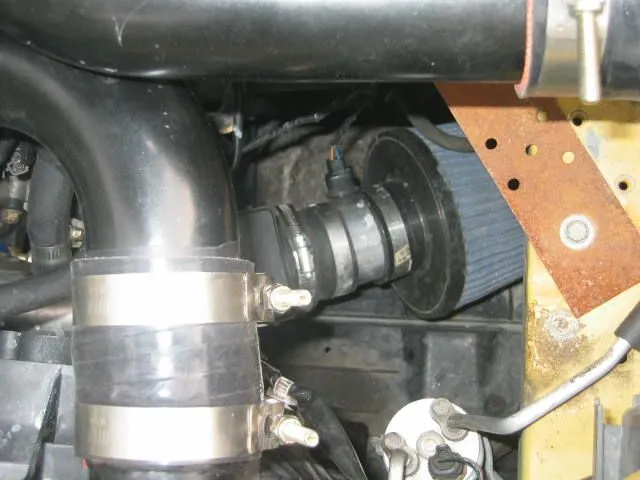

Add'l pics of piping. All piping is 2.5" mild steel painted flat black. Once everything is finalized. I'll paint it gloss black and clear coat it.
R

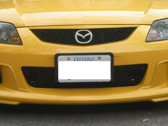

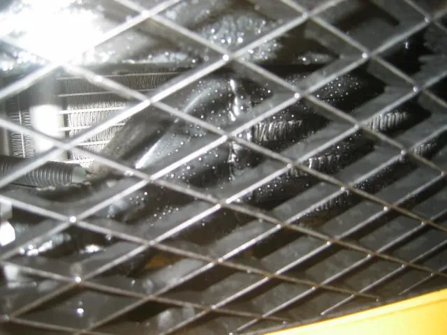

A few more pics. Yes, I am aware of the wicked 90 degree bend...that is why I have donned my flame-retardant suit....LOL! Seriously though, once they design something to replace the 90 degree bend it will look alot better and I suspect that it might even decrease the spool up time a fraction.
R
R
can the pipes be made without the 90* bend in it? maybe use some sort of mandrel bent piece?
