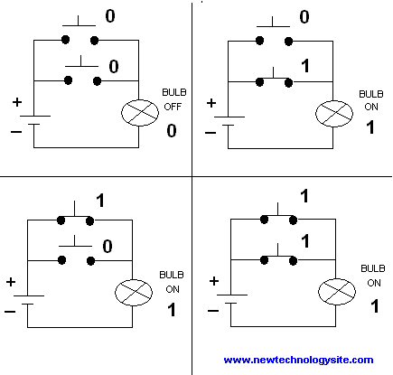

Wired up the water pump finally. Fans are also wired up. Wondering how to put a switch on at least one of the fans so I can turn it on whenever I want, but still retain the ECU kicking them on at the right temp.
Wire a switch in parallel to the fan control relay. Like the picture below. This could be done using the power lines to/from the fan, or the relay control wires. One switch will be your manual switch, and the other will be the relay or ECU.
Make sense?

Why do you think you need to have the fans on a switch as well as being connected to the ECU? Some kind of failsafe?
I really don't remember anything relating to wiring that I learned in high school. :/ and I suck at wiring to boot... So... It doesn't make sense lol. I drew a pic showing what I'm working with. I *think* I could somehow splice a switch in between the 87A terminal and the hot wire going to the fan but I'm not sure if that will even work. I don't know. I am wiring illiterate.
Magnum, what you see is what you get. I've yet to figure out the fuel level, it still shows 00 with some gas in the tank. Usually on v8 builds you see the NA guys wire up a digital speedo. The only other option I know of is the little convert box from FM. On my spear tech harness there was a "speedo" cable coming from the ECU. I assume that's what I was supposed to hook up to the speed wire on the gauges. We will find out, lol. I used a mustang cobra speed sensor on the T56 due to its low profile.
Run a wire from 86, to a switch, and then to ground. This will only pass a small amount of current through the wire so you can use a smaller wire and a smaller switch.
If you go fan+ to 30 through a switch you'll need a switch and wiring rated for 30A or more. You will slightly decrease fan performance form the added wire and will have to deal with bigger wire, a bigger switch, etc.
Edit: I assume this won't do anything to screw up the ECU. It may be worth using a "single pole, double throw" switch to isloate the ECU when it's being overridden.
Where 86 is connected to "com"
L1 is connected to your ECU
L2 is connected to ground
This lets you switch between "always on" and "ecu controlled"

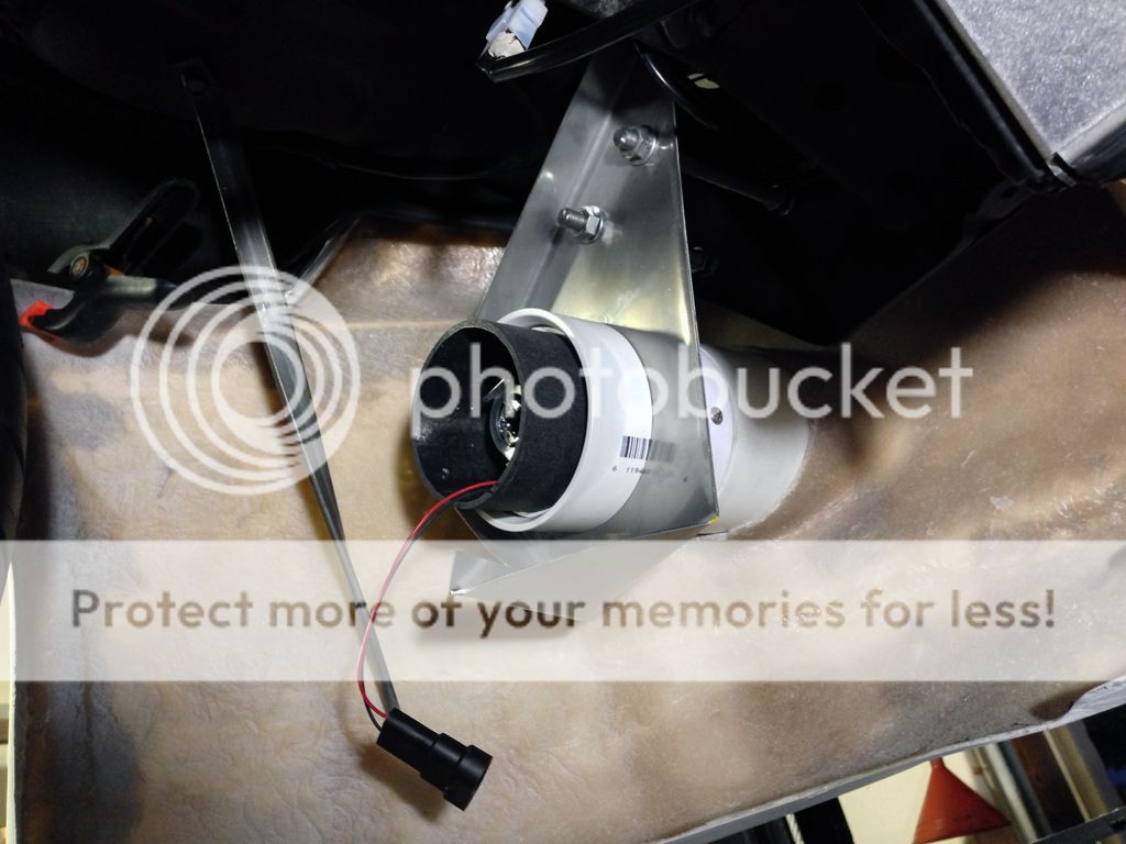

Well I've been working on:
-Fitting the projectors into the foglight holes

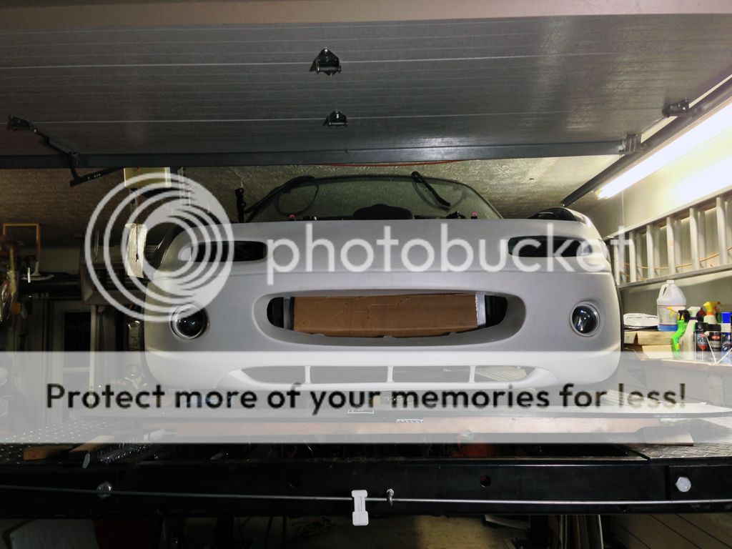

After figuring out something in the tune was off (DTC wasn't on), and that I had unplugged the fuel pump... it started up. Being the idiot I am I decided to let it warm up to operating temp... and wait for the fans to make sure they would kick on when they should. They did, but they didn't bring the temps down. They hovered around 203-205 (fan 1 kicks on at 195 and fan 2 at 197, both kick off at 190). I figured out why later......... I totally forgot to take the piece of cardboard out of the front of the radiator that I was using to shield it while I worked on the car. So really, no air was going through the radiator at all, the car wasn't moving, and the LS didn't over heat lol. Win! It still needs burped, also.

Still waiting on the exhaust to be coated.............. the shop said it's been so humid that the headers they've been coating have been blistering and they were going to wait for a drop in humidity to do my exhaust.

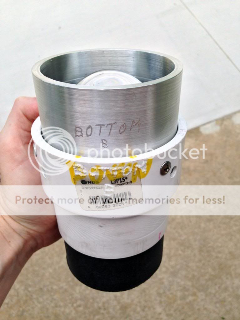

So while I wait I started working on my headlight solution: Morimoto Mini H1's in the foglight holes. Before anyone says it--YES I KNOW THEY ARE ILLEGAL DUE TO HEIGHT. I will have LED running lights up top, also.
I learned that the black PVC melts, so I substituted aluminum. Hopefully it will act as a heat sink somewhat.
Nothing is finished or painted yet. I know PVC is kind of janky but I can't think of anything else cheap that's doable and easy to work with.
It will all get sealed and I grabbed some 90* rubber angle vents off some old Miata front turn signals that will get fitted to the top. I'm still working on the adjustability. The two brass screws are attached to two angled pieces of PVC so I can slide them to adjust in all directions a bit.
Any comments/suggestions welcome.
If the black PVC melted (I assume where the aluminum is now) then the white PVC has a good chance of melting. I don't see a way that the aluminum is going to carry heat away from the plastic.
