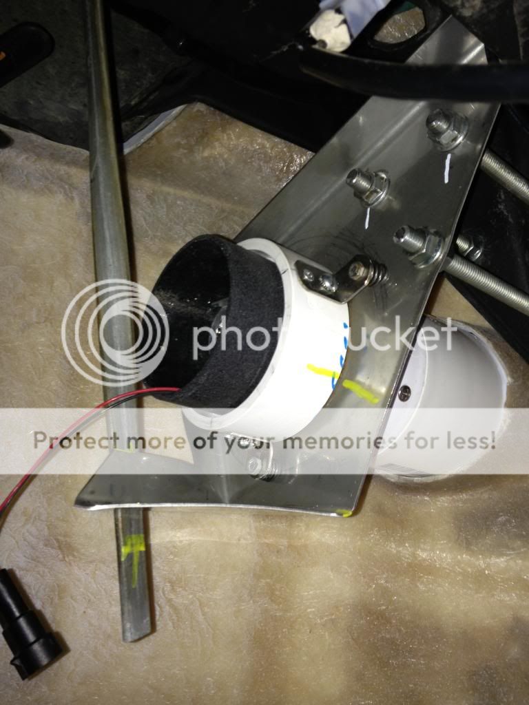

Well I left the HID on for an hour. I highly doubt I'll ever have them on while the car isn't in motion for an hour. I expect some of the air hitting them to cool them at least a little bit. In addition to the aluminum piece, the projector itself is resting on a small-coil metal spring at the bottom to help distribute heat. It's hard to explain but on the bottom of the projector, the flange is rectangular and where the 4 edges contacted the round black plastic piece is the only place it melted. I hope the spring will act as a heatsink and distribute the heat around more.If the black plastic was ABS (very common material for black plastic piping) then it actually has a higher melting point that PVC. A stress-test is in order methinks.

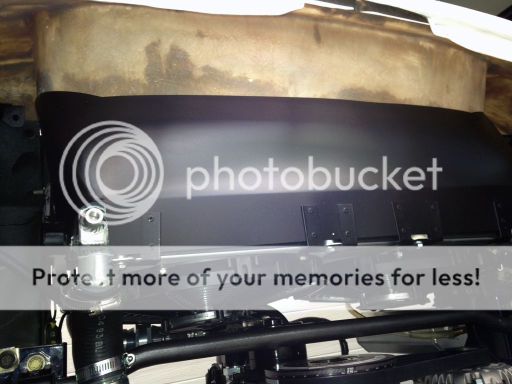

Woah! What's that shafty thingy going down the middle? Us FWD people aren't familiar with that type of witchcraft.
bahaha the driveshaft! I was paranoid and I had to clearcoat the raw aluminum it was made out of. Same with the oil pan.... lol.
