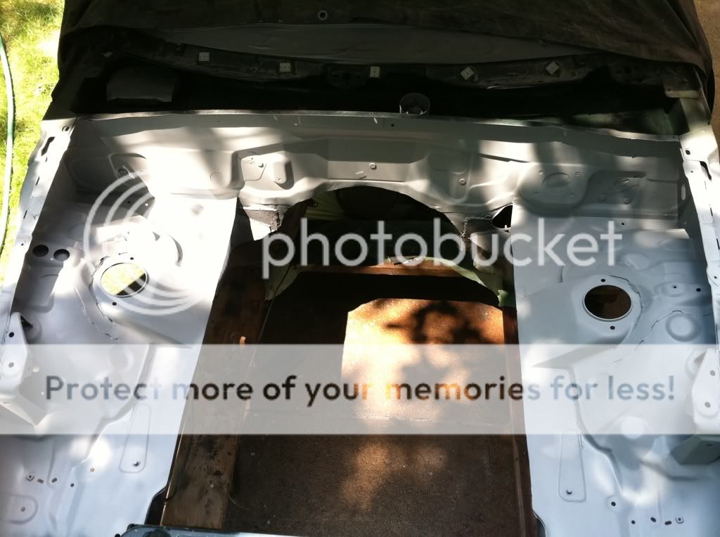

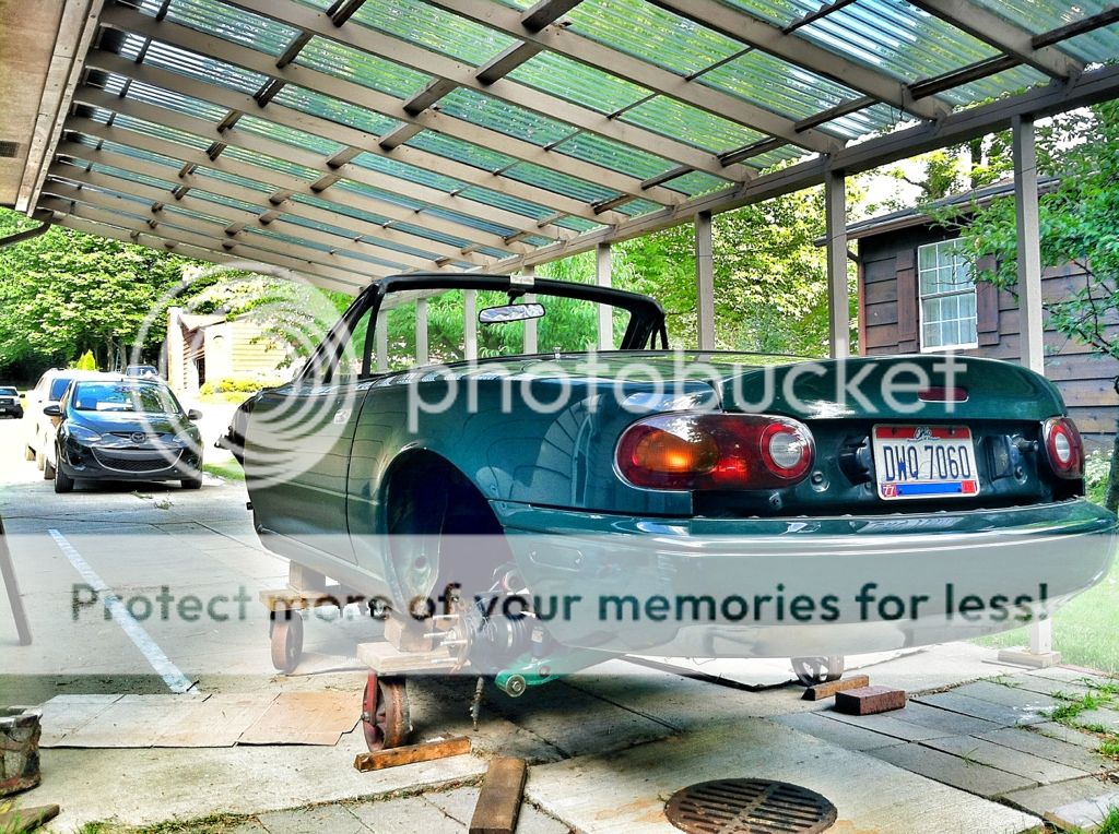

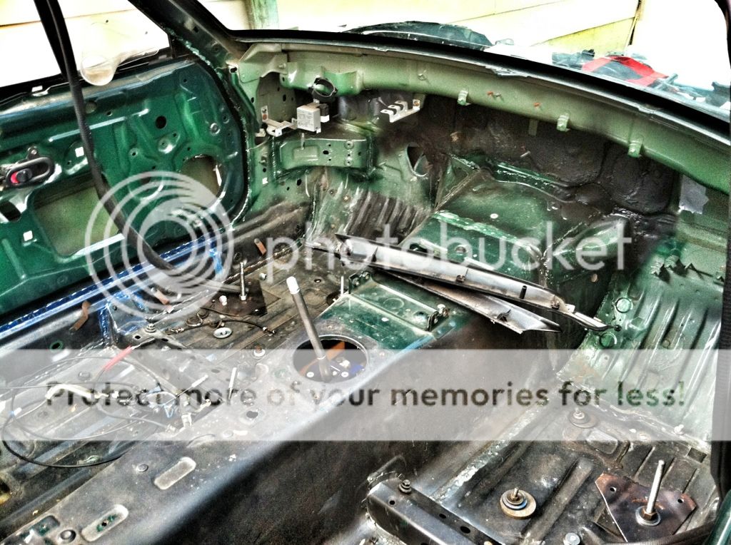

This body work is taking for.ev.er.
I guess I could update this :P
Not much going on, need MOAR MONEY!!!

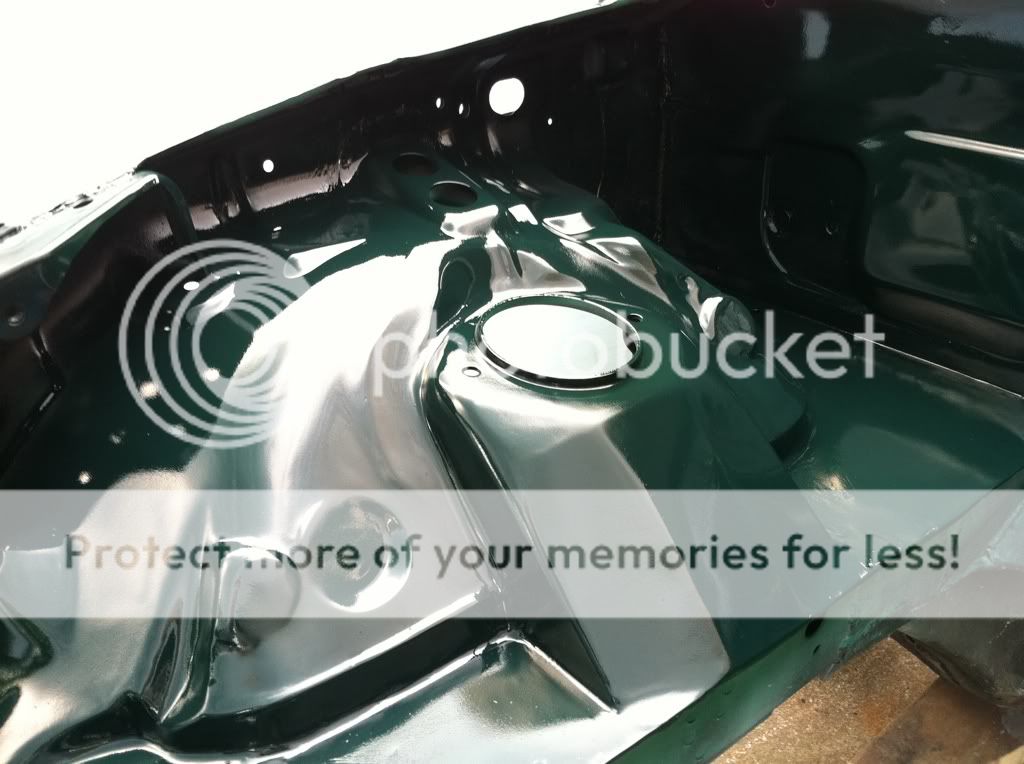

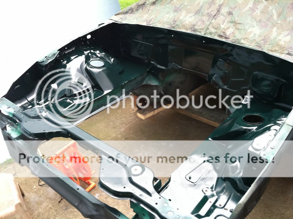

Bay got painted.

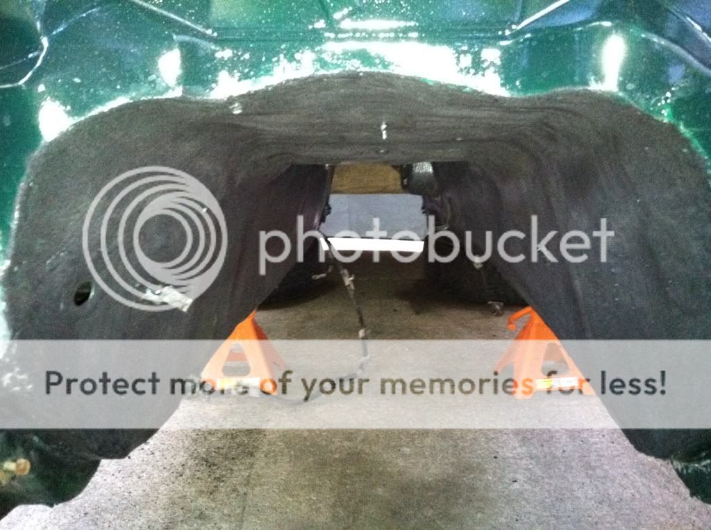

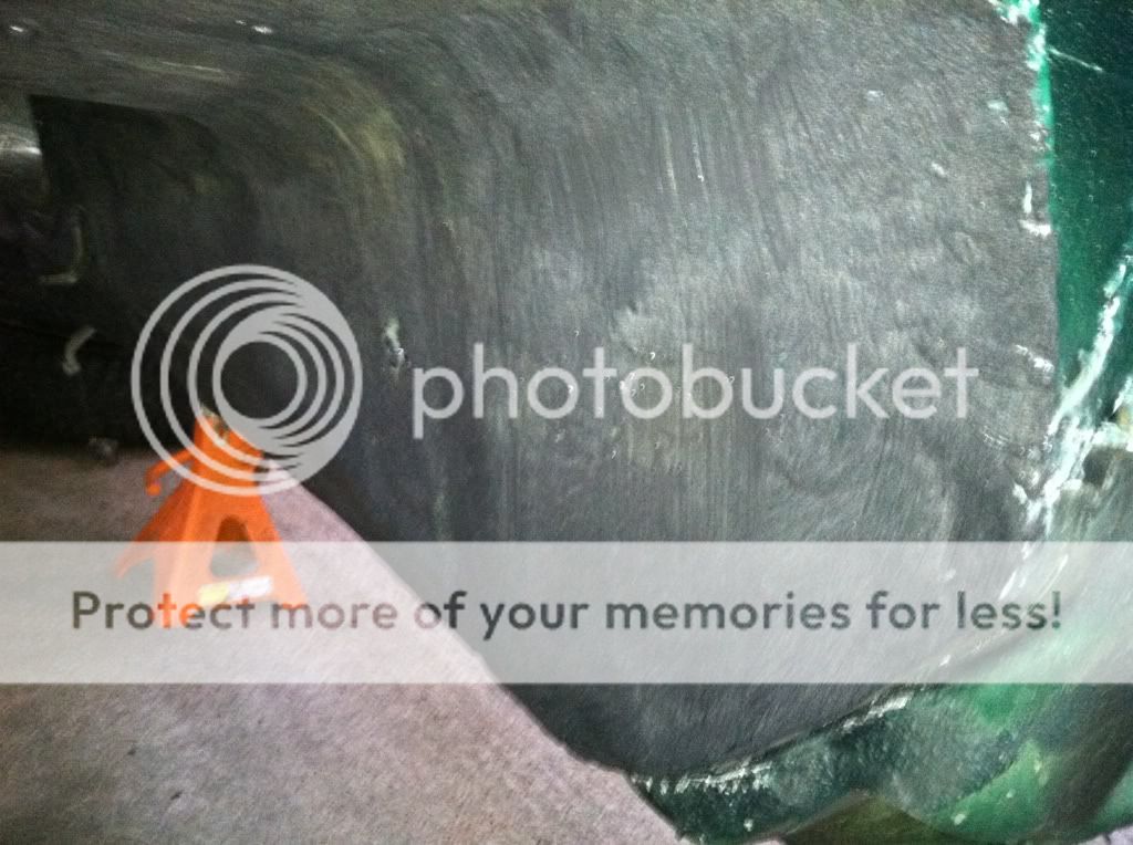

Also cleaned up and undercoated the tranny tunnel with some heat insulating and rust-preventative paint:
(I also undercoated the entire underside of my 2 with this, I got a gallon of it from metalshield.com o_O)

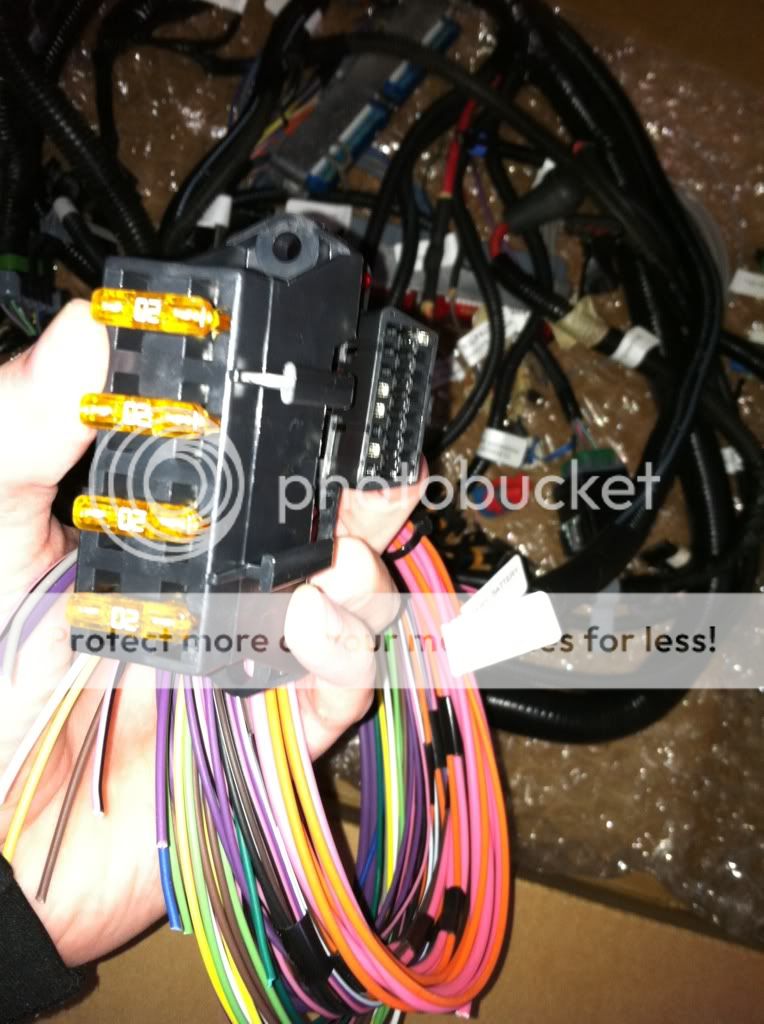

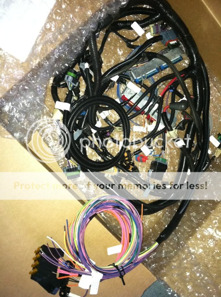

Got my standalone harness back from Speartech, I can haz OBDII on a 91 :)

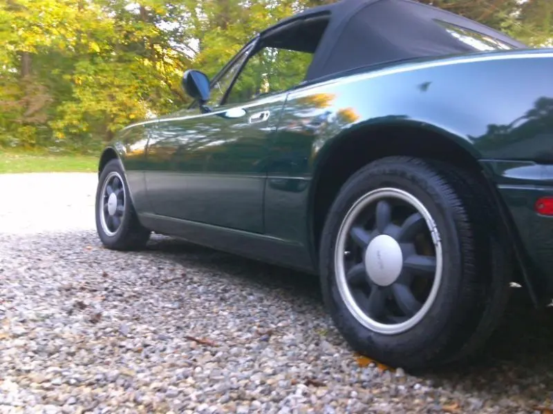

I will have a set of 15x9 6ULs in my possession after this weekend................ they will probably get stuck on the 2 for at least a test fit to see just how much they stick out (guessing about 2") but they are destined for the Miata.
Went to CT last weekend, picked some wheels for the Miatar from a fellow CR.netter. They stayed on the 2 for a week for S&G, now they're in storage :)
15x9 6UL

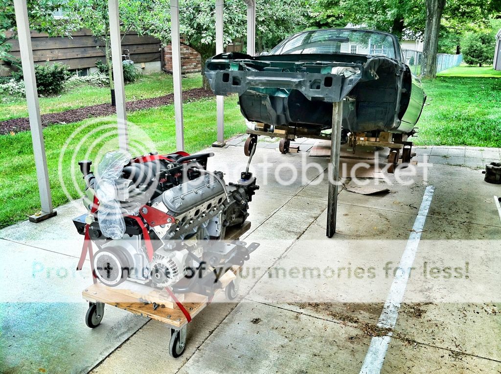

The 2 grinning like a retard at the V8 Miata:
The sheer size of the tranny and engine combo is insane. It really looks like it wouldn't fit in the little Miata... but it does.
Waiting on the headers to come back from coating and then I can bolt it in for good. Tonight was just lets-make-sure-the-tranny-clears-everything...
