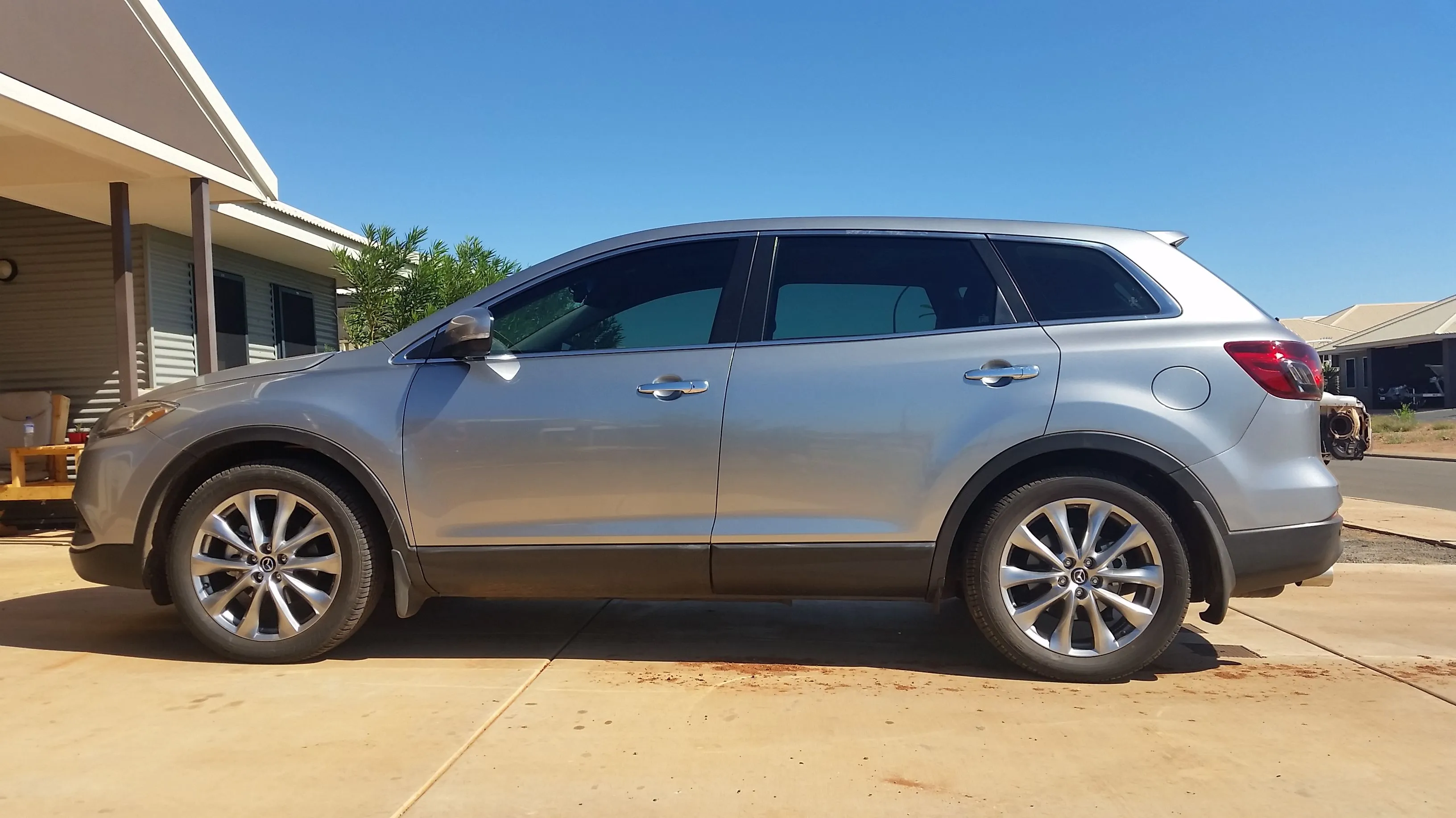

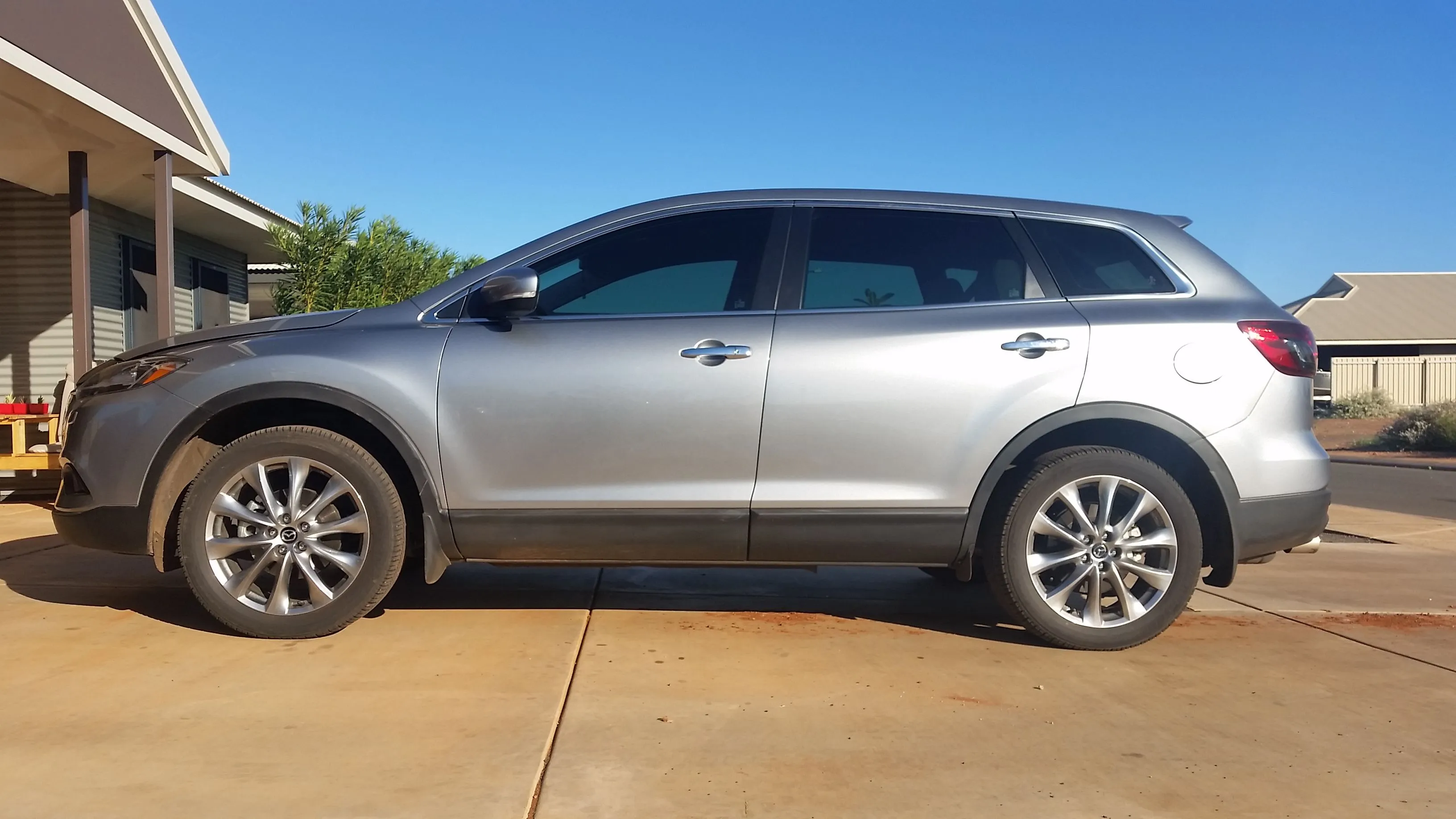

Finally got around to lowering my 2014 cx9 GT.
The rear is a piece of cake just take out lower CA castor bolt and out comes the spring no need for compressors or anything. Took a total of 2 hours and the difference is subtle but more noticeable in real life than camera. I also fitted wheel spacers to fill the guards out and now sits very nice. As far as handling goes definitely better covering and a real nice firm feel. Not too much to make it annoying still very comfortable. Happy with the out come. Springs are King springs 30mm lower.20150617_112129.webp20150617_083756.webp
That looks good. Subtle, but I can tell the difference. I wonder who King's North American distributor is.

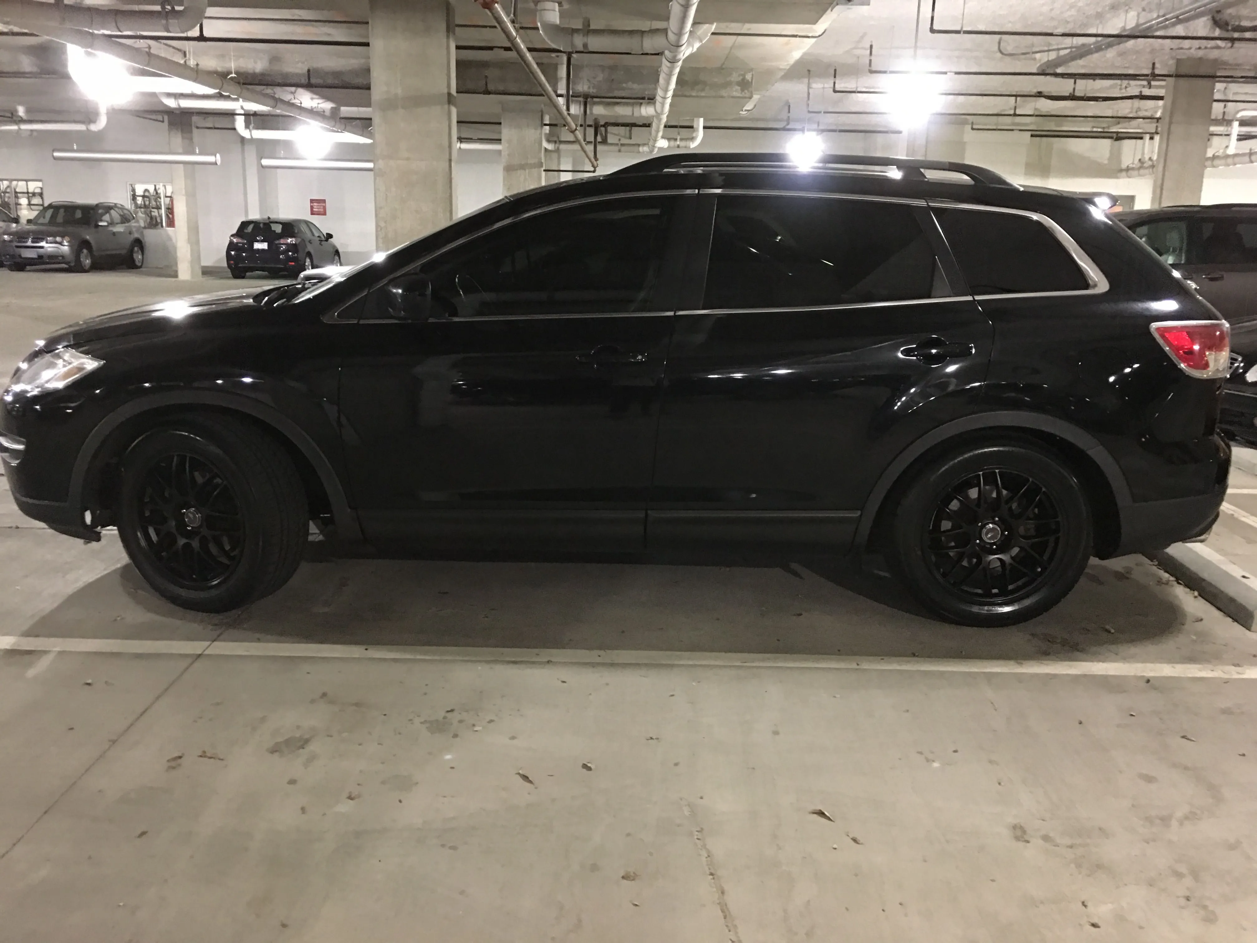

Finally lowered mine as well...looks meaner with black rims...
