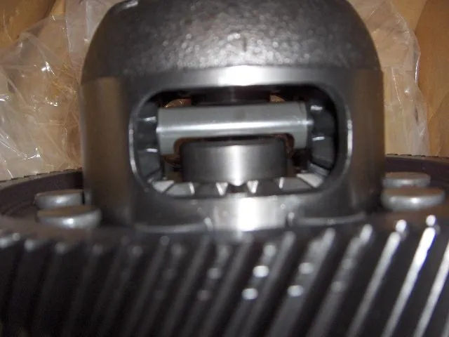

I appreciate a "let's slow down here" approach, but I just conference-called with the mechanic who is working on my car, and Ken at Protege garage. The mechanic I took this to builds race cars and has installed many LSD's in various vehicles so he's not naive. He put the axle in to test after partcially installing it and it allowed 1 wheel spin.
Ken was then told by Mazda that there is some (my words talking here)--> magical mechanical piece inside this new diff that manages to go against physics and only grabs both wheels under a certain amount of torque.
How is that even mechanically possible?! Either it's an LSD or it's not, right? My mechanic agreed with this sentiment.
I'm assuming Ken will be letting us all know what's up, and I'm sure I will be getting what I orderd--the OEM LSD 2003 MSP diff welded and not this new open/closed diff enigma.

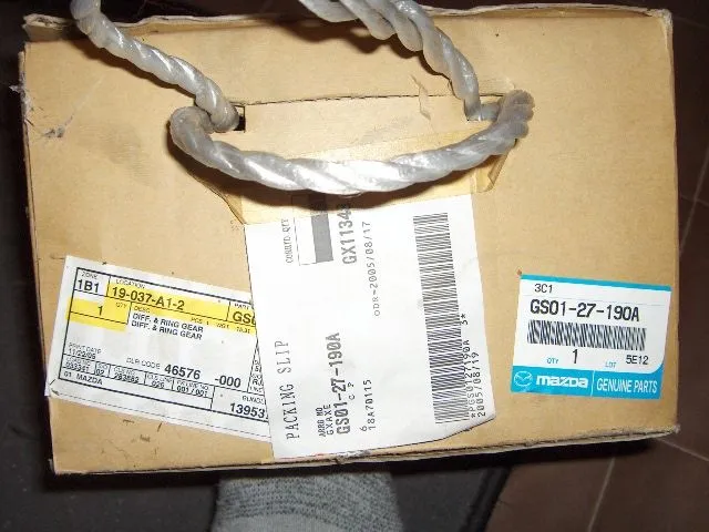

Tell you what, right after supper I will go to my storage space and get my brand new GS01 LSD that I have and I will take pics of it. I will also stick in to axles and see what will happen !!
If the new differential has a "button" inside on the LSD casing side then it is in fact a LSD. The open diff doesn't have that button! This is a picture of my Original LSD;
Just got off the phone with Ken; He got up on the ladder high enough to determine they are shipping 2:1 ratio Torsen diffs.
And just so you know I'm not just stirring a bees nest for the sake of drama:
A) Mazda shipped a different part from what we ordered.
B) looked exactly like my LSD minus the locking mechanisms inside.
C) my mechanic spins the wheel and only 1 spun. Being we were expecting the OEM 2003 LSD this would tend to lead one to believe they received a standard diff.
What this thread helps ALL of us gain is that you will not get a mechanically locking LSD if you order the OEM MSP replacement, but a Torsen style that at first will apear to be a standard diff.
And that is why the title of this thread was posed as a question and not a statement.
I'm going to take a nap; christ.
Here are the pics:
I handed the new LSD to the master tech at the mazda dealer today and asked him to identify if it was or was not a limited slip differential. he had to look and play with it for several minutes before making the determination that it was indeed a limited slip, and he truly had a hard time making the determination. after pulling the service highlights manual and further inspection of the new diff, he came to the conclusion it is the Torsen style and very close if not identical to the one now being put in the RX-8.
which leaves us with the following LSDs for this car;
1) 2003 Tochigi Fuji - discontinued
2) 2003.5 Mazdaspeed Revised - discontinued
3) Revised Torsen Style, released 2006
that said, i was able to secure some of the last remaining (4) Mazdaspeed Revised for those that want them. If they all sell to members here, I'll consider a discount just to move them for Mazda. Two questions remain unanswered - why the dealer cannot force an order on the old stock despite it being there, and why the change was made to begin with.

This new number is probably only an internal change. The 2003.5 Revised diff and the one from this new part number are one in the same. I am 99% sure of this.
i'll have side by side pics when i can of the two, probably monday. i honestly do not think they are exactly the same and the master tech here does not think they are exactly the same either. i trust his expertise since he is ranked as the number 2 guy skill wise in the US as master techs come. lord knows he has the trophies and plaques from MNAO from the various competitions he has participated in. they were very adamant in not wanting the 2003.5 revised models to get into my hands.
having spent some time with mazda, if it was a mere internal change or slight upgrade, the suffix would change to a B or C, etc from the A and the rest of the number should stay the same.
