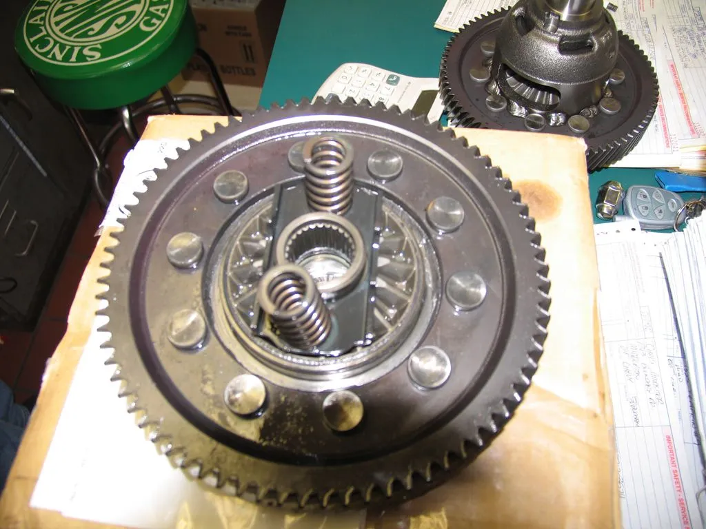

That's what I was told as well, seing as the springs are there. But there is no mention of it from Mazda. And the cutaway view I posted is from Mazda's Manual. You clearly see the springs, and they describe it as a torsen.
I am no expert in LSD construction, but if I had to guess, those are helper springs that they removed for the revision.

I've only found a few pictures of the 03 LSD but the spring appears to only preload the gears, allowing for smoother engagement. Removing it, the revised versions, should have little to no effect on the TBR.
Focus, why did you come out of the gates so defensive about this?! It's like you are defending yourself against some kind of personal attack.
The reality is that this was a completely justifyable concern given the circumstances, and I know for a fact (which the photos prove) that the 03 diff I had removed and the one I got are very different.

What's this photo of then (removed from my 03 [not 03.5])?
I don't build transmissions for a living, but it looks a hellofalot like a clutch pack assembly to me (huh)

Tallard- can you post a picture of the underside of the plate the springs sit on? I want to see how it mates with the gear.
