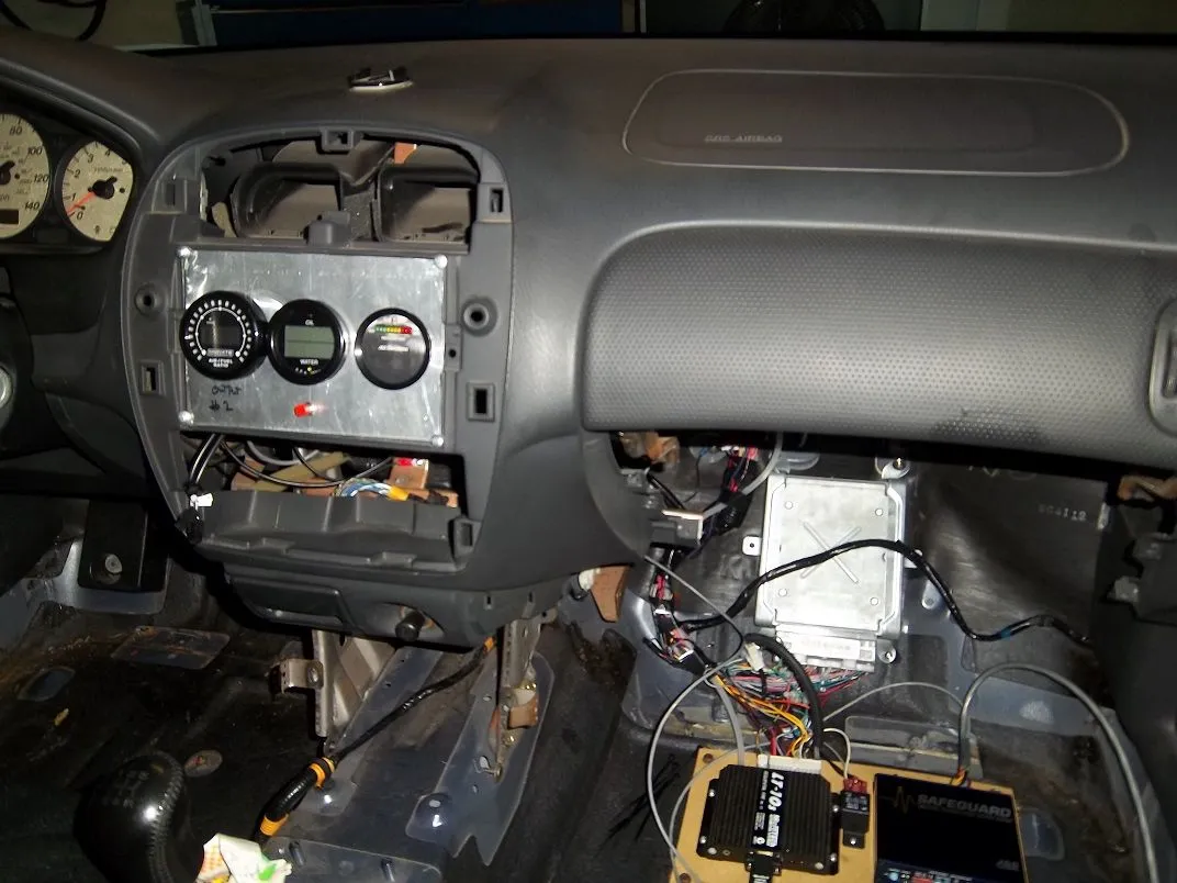

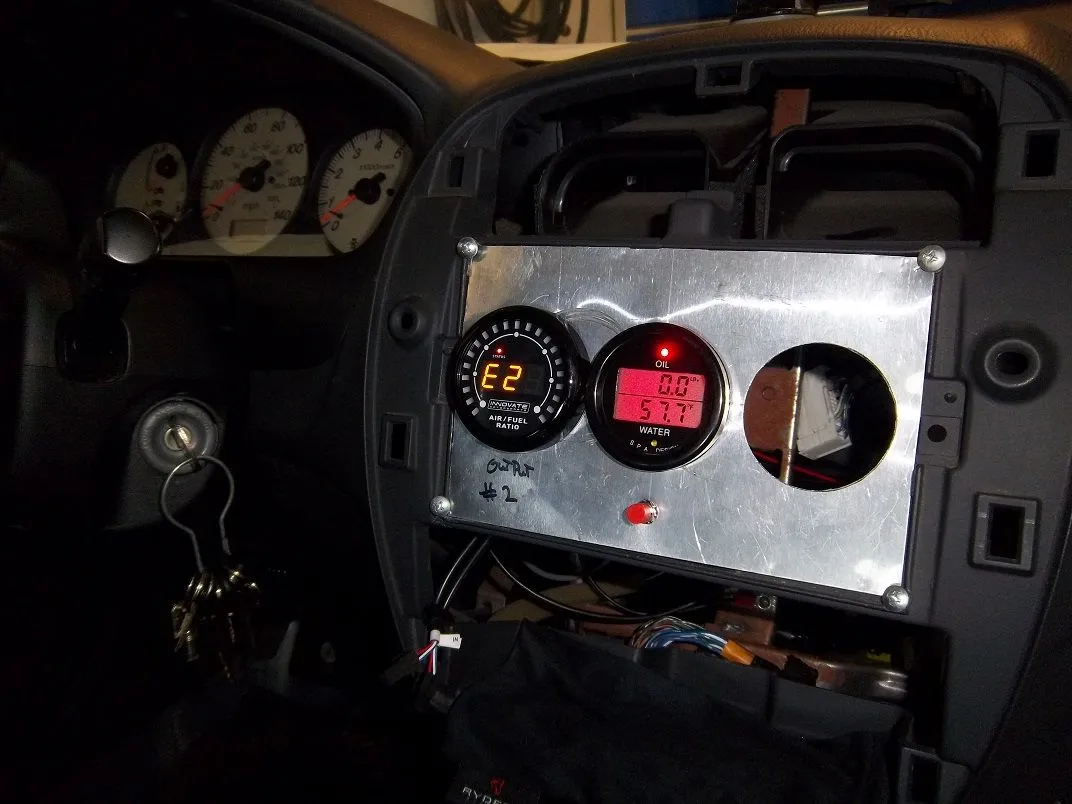

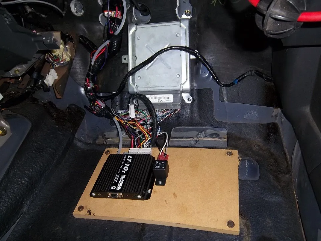

Dying to finish this thing. But I am still waiting on the J&S.... Also I am trying to figure out the cam and crank sensor hook up. In the mean time I got the wideband hooked up too.

Ahh s***.... now that I look at it the zm is different. Not too sure about what you guys have. But if I remember right you do have some pretty different stuff.
Not sure the sensors are different, but certainly the trigger wheels / maps are. I don't think it will really matter at the end of the day as long as you grab the right wires.
As these are sensor wires you should just be able to splice into them. Like I said before it's probably best to do it in the cabin.
OK cool! Thanks for the push... all done, and the cars starts and idles great! Now I wait for the J&S. Hopefully off to the dyno next week!

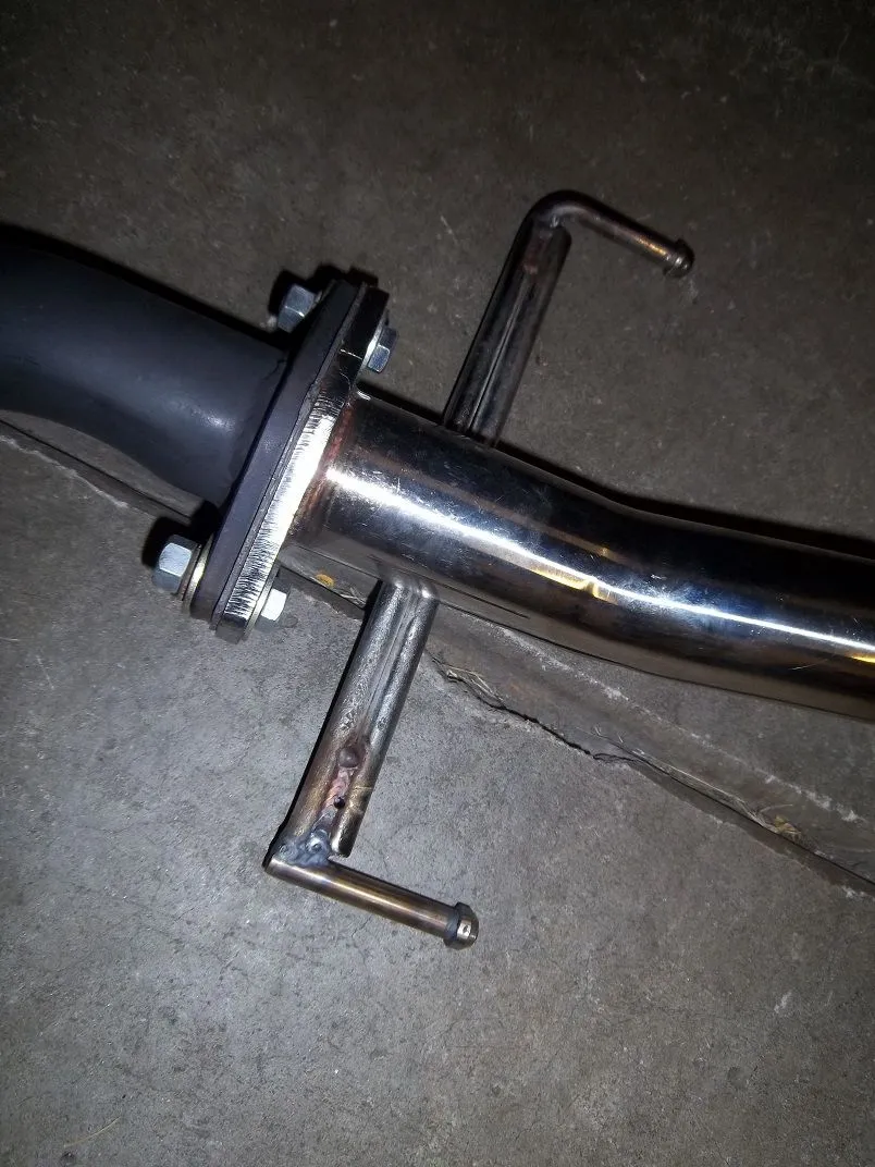

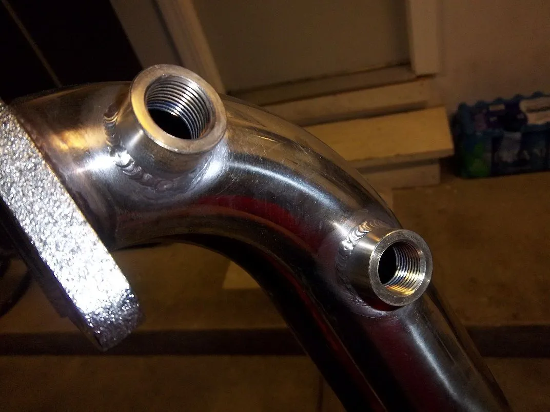

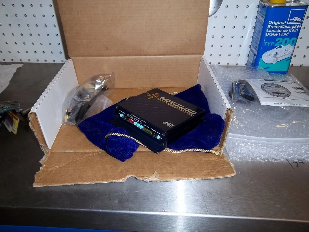

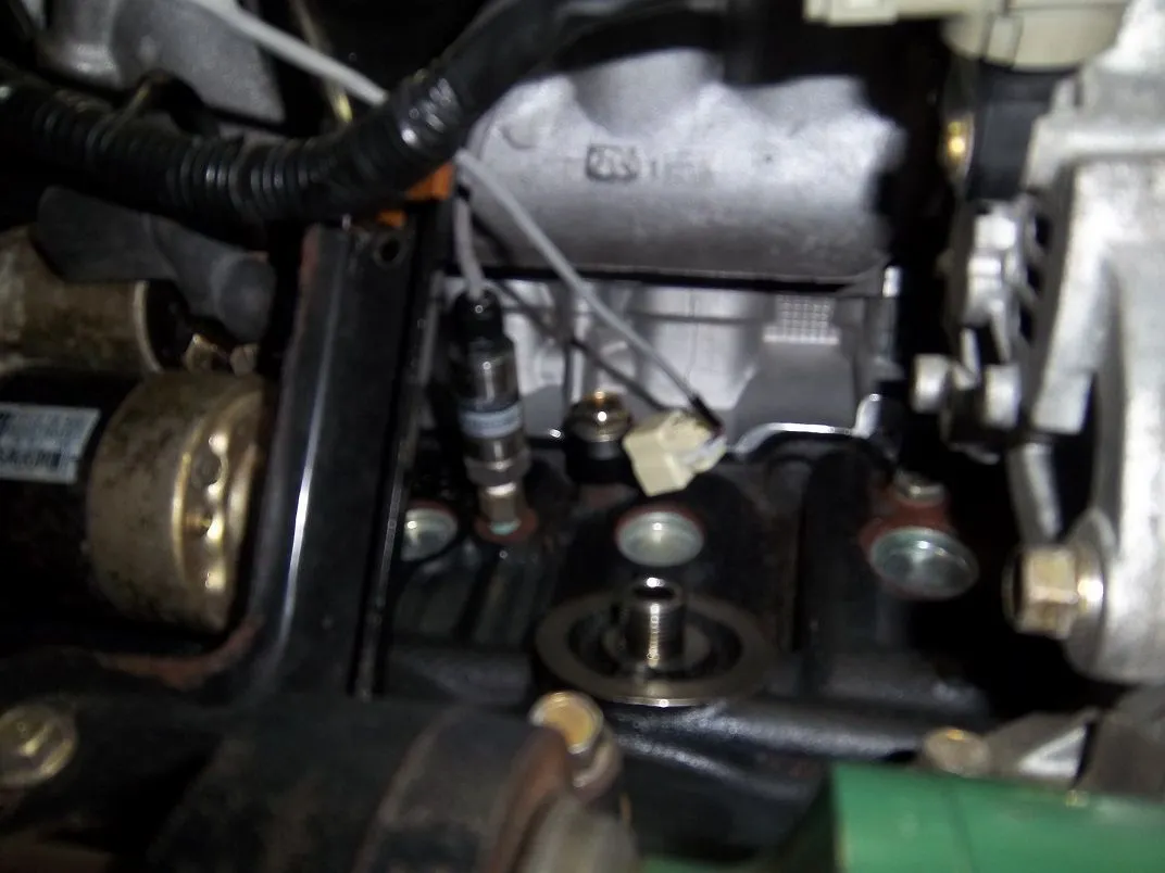

OK got the J&S in the mail (a day late from the usps) and got it installed. Having problems with the gauge. It is supposed to do a self check thingy but is does not. Asking John about it now so we will see if he can help me out. Also got the two SS bungs welded in for the wide band and the second O2 sensor, and fixed the exhaust hanger I tried to modify. SOOO its now off at the dyno! A-Spec in Schaumburg IL has a freelance guy whom has been tuning Microtechs since they cam here in USA. He should have the cam gears, microtech, J&S all tuned up by the end of the weekend. I guess I am hoping for at least 150whp. If not then modding this car N/A is sooo not worth it. For me any power I have gained will defiantly be helpful as I am in a controlled racing environment. But its going to take a huge gain in hp to stay in front of that BMW!

These two hangers where pointed the other direction and must be for a probe or something so I bent them backward and they fit great! except the one busted off.
