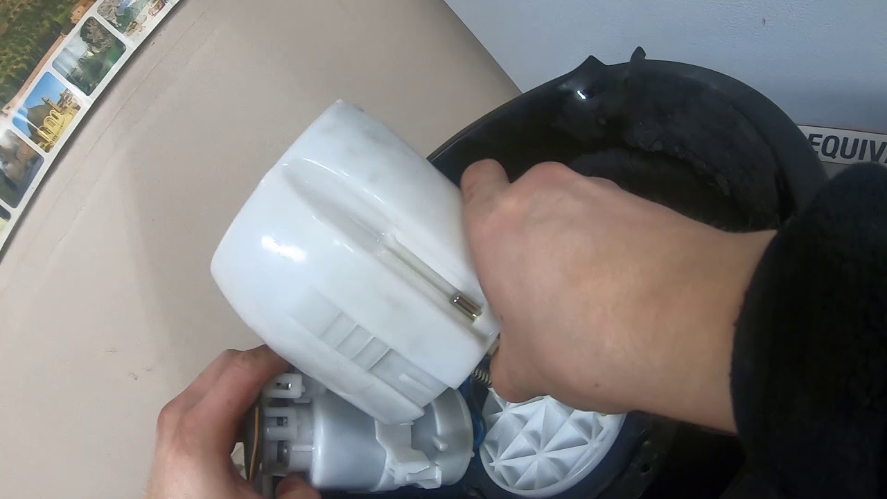

Dunno where exactly to test for fuel pressure. Haven't had a fuel pump issue with this car yet. This guy does it with some hose, a T and a fuel pressure gauge.
Replacing the pump looks very easy. I'd probably just do it if I had north of 150k miles on the car.
