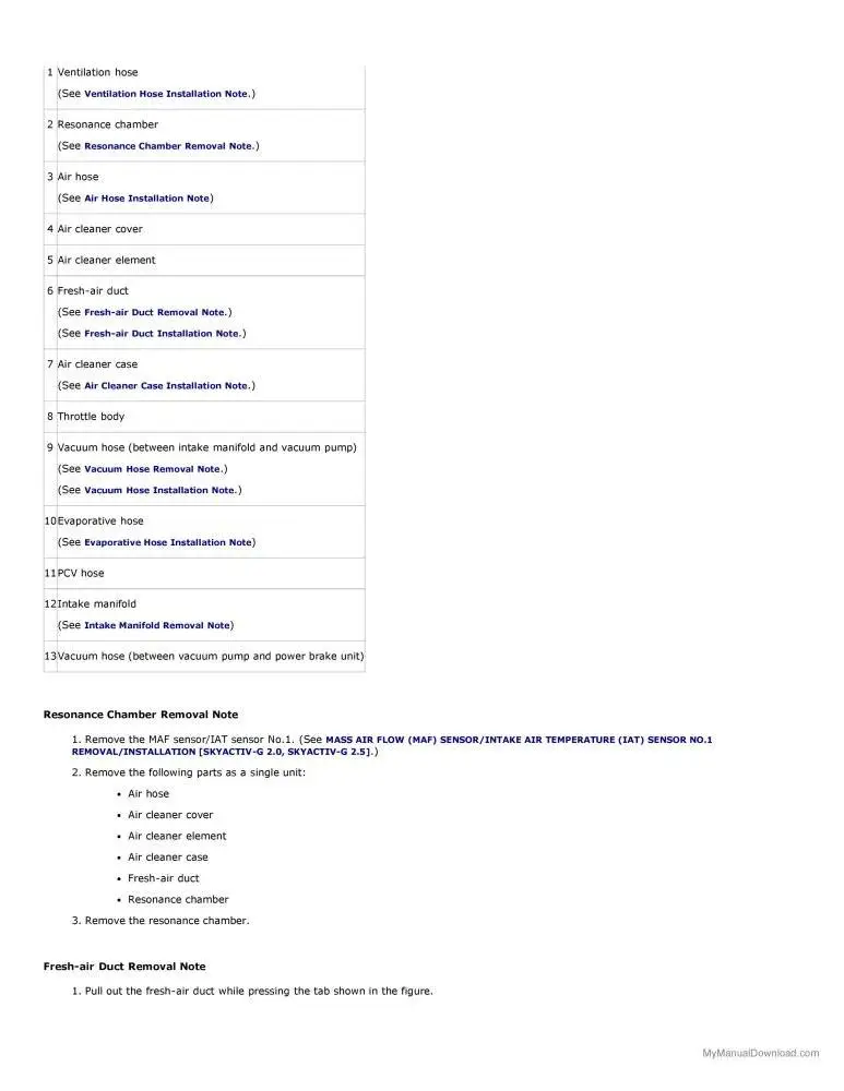

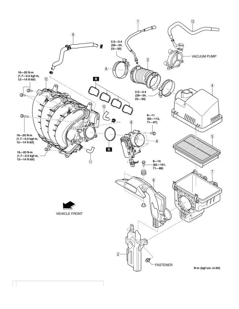

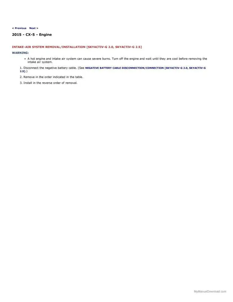

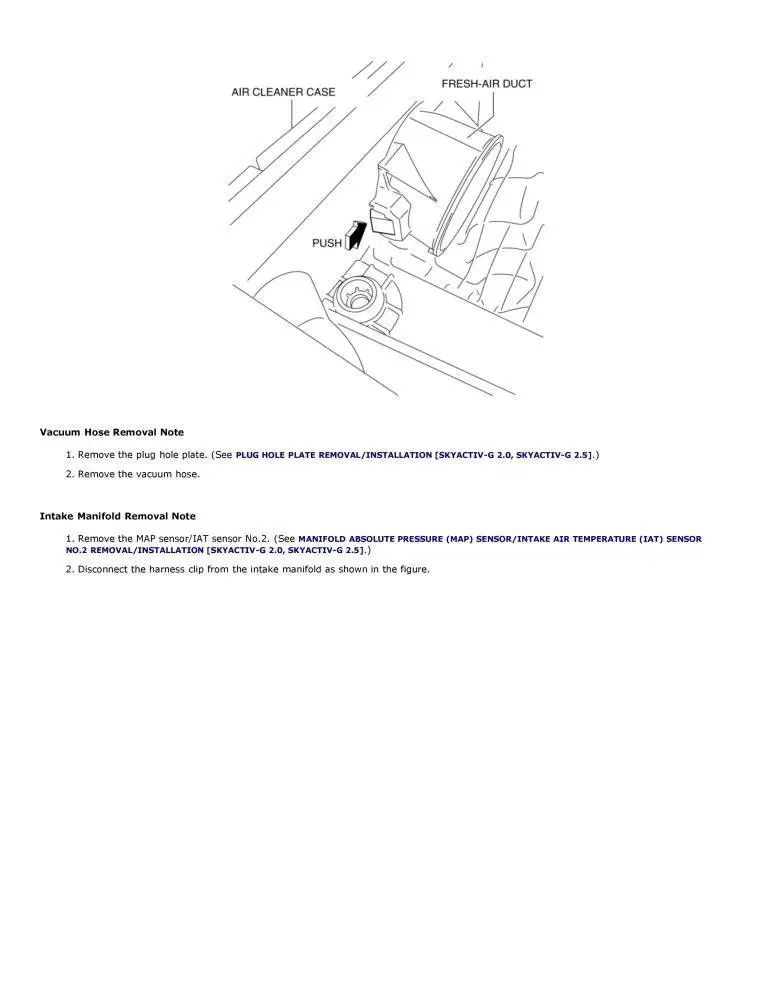

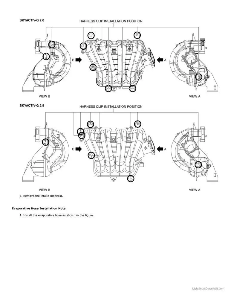

For those that did do a intake cleaning at the actual valves did you have to remove all listed here? Unfortunately don't have vehicle in front of me to look at for a few days.
If you only want to clean or inspect the valves, I suppose you could leave the airbox in place and remove only the manifold and throttle body. I took it all out leaving the airbox intact. I did that to clean just about everything though (MAF sensor, throttle body, intake valves).For those that did do a intake cleaning at the actual valves did you have to remove all listed here? Unfortunately don't have vehicle in front of me to look at for a few days.
