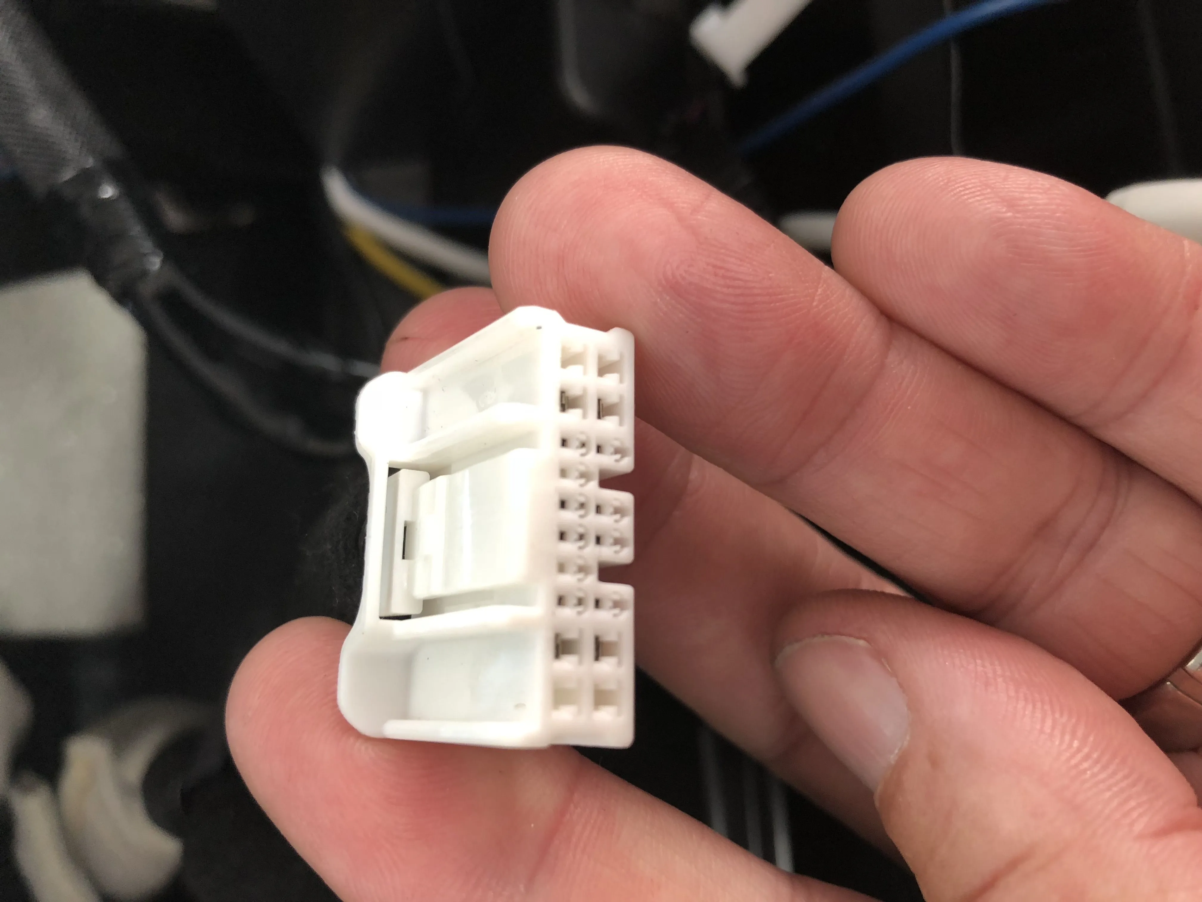

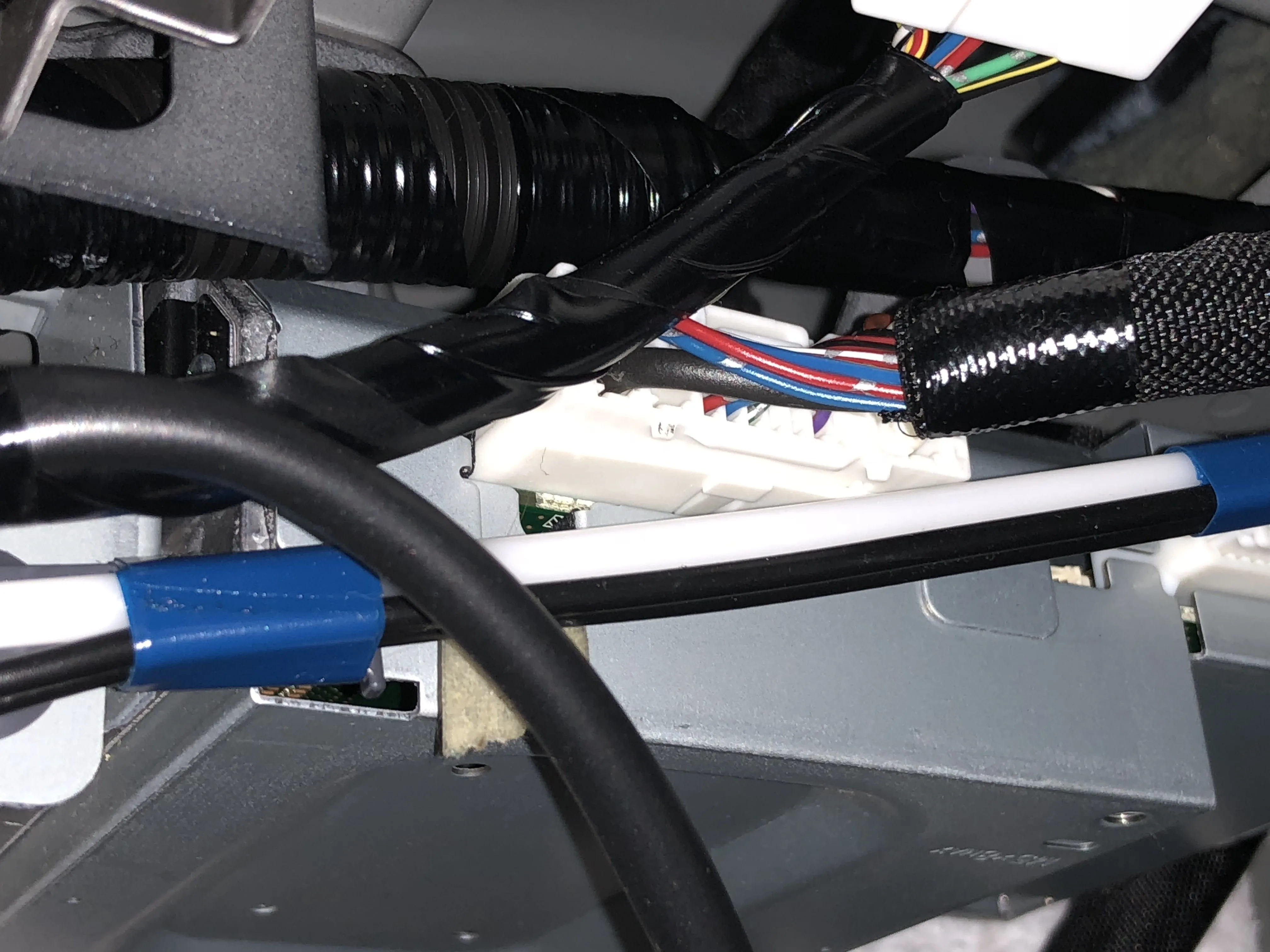

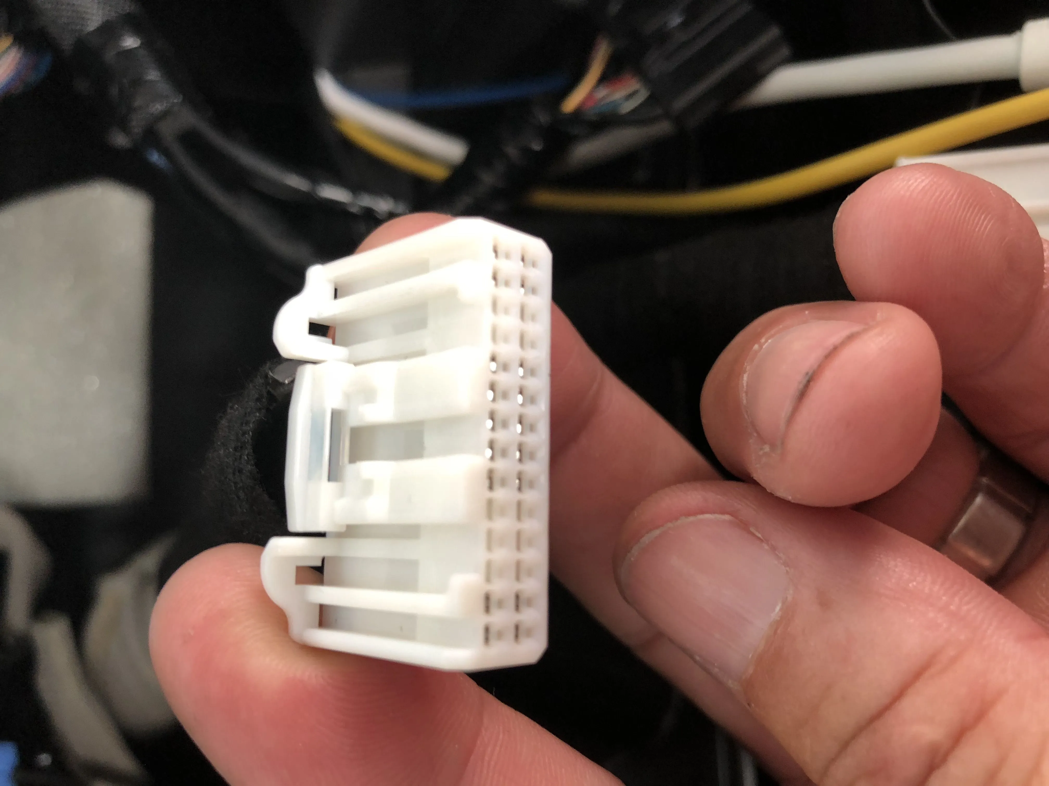

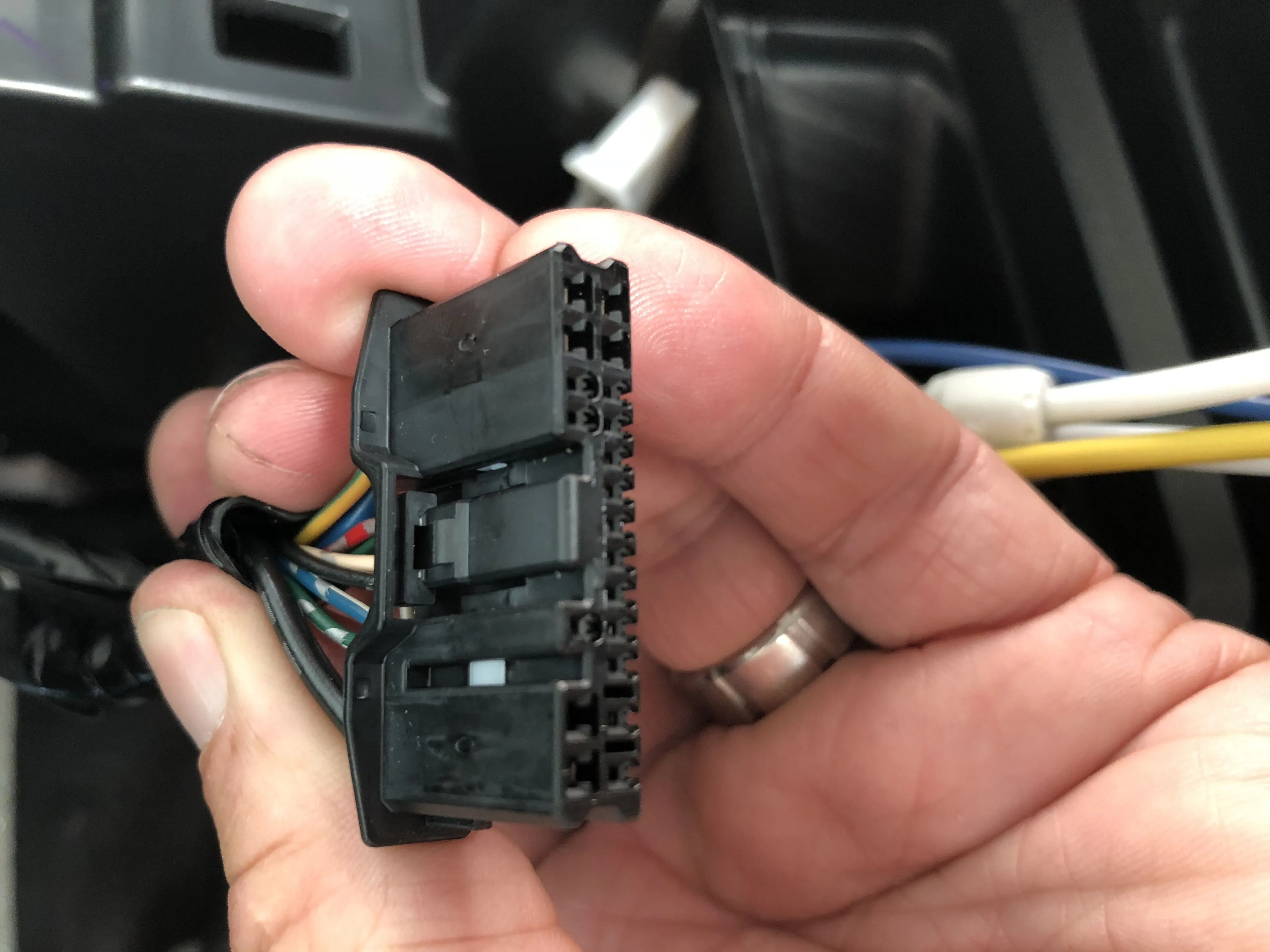

Mazda CX-5 2016.5 70-7552
I have the CX-5 2016.5 Sport and am trying to replace the head unit with a DNX693S. Crutchfield sent the 70-7552, but it doesn't fit any of the connectors that came off of the stock head unit. After spending some time on the phone with them, they suggested the 70-7903 that plugs into the unit behind the panel on the passenger side right. I don't see any mention of this install type on this thread. I don't have the Bose setup. Looks like 6 speakers. 2 small tweeters up on the dash and 4 door speakers. Attached are the pics of the connectors from behind the head unit and the unit in the passenger side I referenced. Any clarity here? Thank you!
I also have a 2016.5 model without Bose setup. im trying to install a pioneer avh-2330 unit but ran into harness issue. Were you able to find one that tackles this burden?
I am beyond confused. Metraonline.com says my 2016 CX-5 Touring can use the Metra dash kit, but Crutchfield is saying because I have factory navigation that I can't use it??

So, I am in the middle of upgrading my kiddo's 2016 CX5 sport audio, and... ran into this very SAME issue.
Did anyone find a good fix.??? Calling Crutchfield in the AM....
Will post any follow-on details.
