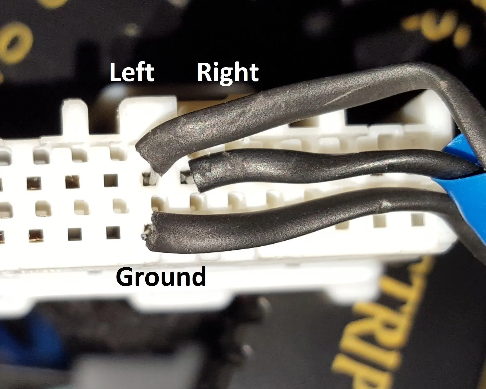

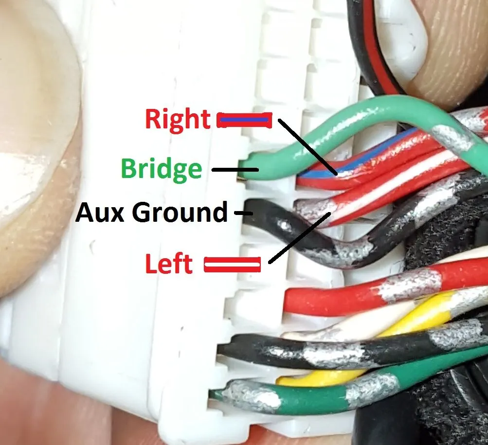

There is one last modification I would like to make. Hooking up the Aux input (next to the USB header underneath the temperature controls).
Before I dive headlong into figuring this out on my own does anyone have any input?
Otherwise, I plan on taking a battery and a multi-meter and finding where on the wiring header the aux signal wires end up.
I am planning the same, just haven't got there yet. Here is some information I found (and saved) from this site, I just cannot find the thread to credit the photo to:
Wow, that was much harder than I thought! Gives me more appreciation for the work RG_Flyer and awpgti did.
So, the aux signal ends up in the Bluetooth header behind the stereo.
(fyi, Bluetooth header behind the glove box does not have to be plugged in, the signal goes straight from the jack to the header)
I cut up an old set of headphones to steal the plug and about 8 inches of wires. I then used those wires to tap into the audio signal from the Bluetooth header and then plugged the other end into the stereo. works great!
Red/White: Left Channel (+)
Red/Blue: Right Channel (+)
Black: Ground (-)
Green: Bridge (grounded when cable is plugged in, probably not needed)
