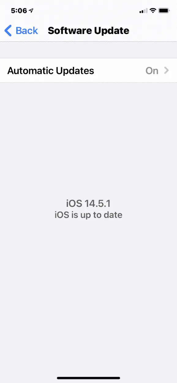

What version of IOS are you using? I had a similar problem when updating to 14.5. Seems to have gone away 🤞🏻Now that I’m at 14.5.1. (I’m running and old version of the Mazda system - 3 years old?

Interesting. I downloaded and installed 14.5.1 last week the day it was released. It showed as current just now:
