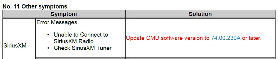

Well there seems to be some XM updates in 74.00.230A according to SA-019/21:
I guess it needs to be tested if it helps with your issue.

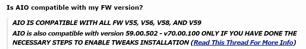

Is the AA wireless using BT or WiFi? I assume BT. I have WiFi enabled using AIO Tweaks but that's probably moot here.
escape75 - Are you going to install 74.00.230
2016.5 Mazda CX-5 GT AWD w/Tech
Yeah I'll install it probably later today :)
I'm guessing it will have a few fixes for us and nothing else. That being the case I don't see using it myself as it will likely break AIO Tweaks. Meaning I'll have to pull out the CMU and hookup the laptop again which is a bit of a PITA.
