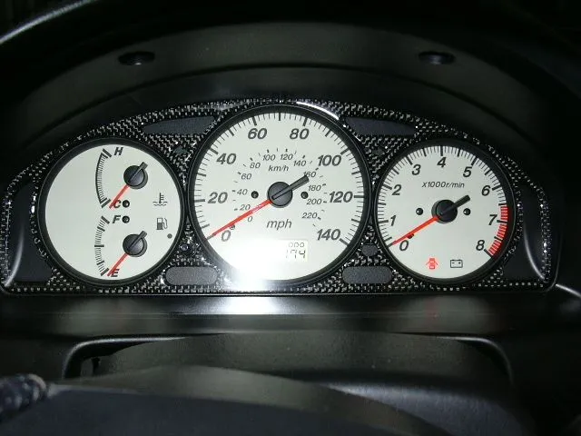

Here are the finished pics. Don't mind the messed up console in the third pic. I'm in the process of painting the radio trim as we speak.

Hey guys,
I'm going to do this install myself this weekend. Thanks for all the tips! I ordered 2 sets of gauges from procarparts.com, in case i didn't like one or the other ... I think i'm going with the ones you guys have.
On question tho. I have 3 male connectors that go from the gauges, and then the wiring harness. The wiring harness part has 4 female connectors ... is one just unused?
extremely nice setup... think its possible to cut a hole for the low on gas light? or would that kill the gauges wire? coz i alawys use my gas until the light comes on.. would be bad if i dun have one :P
Vicocola - Yes, you can cut a hole in it. Although I cut the slit from the hole over the gas light, so I didn't want to bore another hole. Just make sure whenever you cut the gauges, don't cut into any of the gray. It's possible to cut and fit the gauges without cutting into the electrical paths (gray).
Stepson - That extra connector will just hang. I use the first three closest to the black box, and left the last one just chillen in the back.
Guys, just BE CAREFUL. Don't **** with the needles. I had to be very patient and it took me many tries before I got them on. If you don't think they'll fit without force, cut some more. You can't see the slits at all at night, and only a little during the day, as long as the slits are clean. Use a very sharp razorblade or exacto knife.
