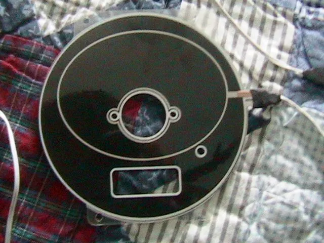

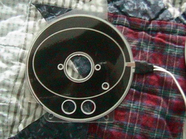

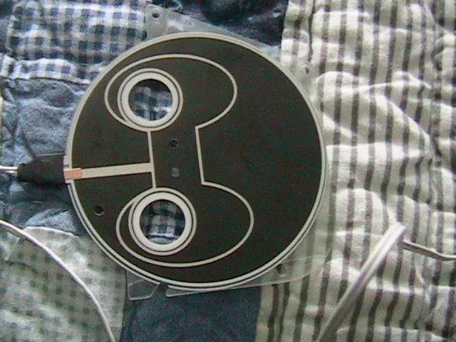

I want to install mine but I'm not sure if they are the same as these. Here are some pictures of the backs of them.
1st - Tachometer
2nd - Spedometer
3rd - Temp/fuel
Can I cut these without cutting into the power lines making them unusable?

ship me your cluster ill do it for ya. its really not that hard man, Take the cluster out and I promise you'll get the motivation to do it. Relax and before you know it, they'll be in the car and you'll get a s*** load of compliments on how they look at night.
The problem is I don't know if mine will fit without cutting and if I don't know if its possible to cut mine without cutting the power wire.
okay, they are reverse indiglo right, you can cut them to a certain degree but dont cut all the way through it. or else it wont work. you can cut a little on both sides.
