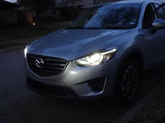

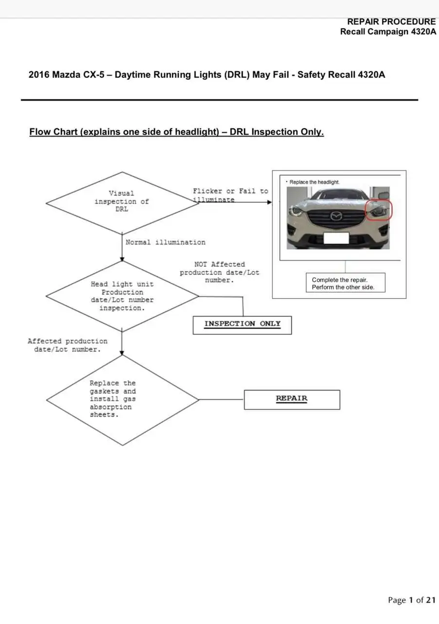

Hahaha! No, my friend. My car wasn't on the recall list. As I told you many years ago, and for once I was right....so far anyway...this is not an issue that affected EVERY 16 CX-5.
Yes the defect on those LED headlights is on EVERY 2016 CX-5 like I said before, and the recall notice verified that. But yours is a newer 2016.5 CX-5 model assembled after Dec. 2015 ⋯ 😜
The LED DRL safety recall does include very few early 2016.5 CX-5’s manufactured in Dec. 2015. It also depends on the actual production date of the LED headlight assembly unit itself. If the production date of the LED headlight unit has the ‘H’ or ‘J’ date code, it isn’t subject to recall.
I believe 2016.5 is the best CX-5 ever overall on design and reliability. Good choice!
And my 2016 CX-5 is Sonic Silver Metallic too. You’ll find you don’t need to wash the car often. ;)
