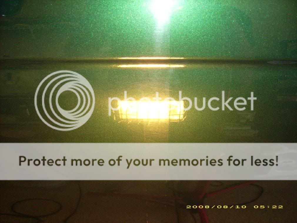

Go get a camera, make sure the flash is on, and take apicture of the panel, i guarantee youll see the defects.
Oh and to show you what machine polishing can do.
Left side was polished with a single pass of Megs 83 on a orange cutting pad. As you can see there isnt noticeable major swirling.
The middle tape mark is the untouched area.
The right was polished with a single pass of Menzernas PowerGloss oncompound on a orange cutting pad, and finished off with Menzernas final polish on a white polishing pad.
No OTC product has the filling capabilities to fill in major defects like this, and give swirl free results like on the right.

it wasnt swirl free per say. i was just aiming to remove the majority of the defects from the paint. It was my friends new 4runner, and the dealership had put a ton of damage in the paint. its my most recent detail (last week) so it was the closest picture in my photobucket w/o scrolling through the hundreds of pictures i have.
My point was that to even get it to that point is by machine polishing. Youll never see results like that on an entire car by hand.
