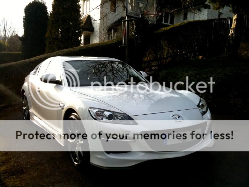

So I'm staying Mazda after fair consideration of other options, and am hunting down an R3. My MSM will be up for sale tomorrow. Also got an estimate on vinyl wrapping an R3, as I don't like 2 of the available US colors (Sparkling Black and Velocity Red), generally like a 3rd (Aurora Blue), but I need to protect the paint better than my last 8 anyway for all my driving. Thinking a satin white or white carbon fiber... :)
Carbon fiber, close and far.
https://fbcdn-sphotos-b-a.akamaihd.net/hphotos-ak-frc1/481888_455318491223625_1566990609_n.jpg
https://fbcdn-sphotos-h-a.akamaihd.net/hphotos-ak-prn1/943140_455318511223623_750767697_n.jpg
This is pretty hot imo...

if he only liked VRM! i like that white one! good luck with the sale, shouldn't have a problem selling it...
