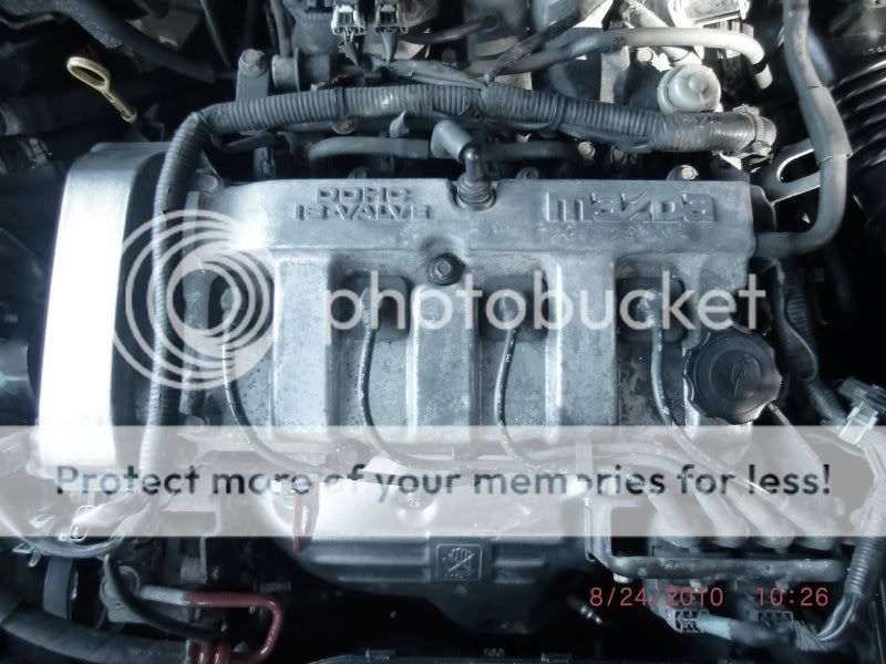

These are before and after photos I am uploading on behalf of Throsorator.
BEFORE
AFTER

NEW Valve Cover Gasket + RVT
PICS: This is why I decided to change the gasket:
I used some help :P (being my 1st time taking it apart)
seal seemed fine tho? but already had a new 1 so i installed it! (the guy from the DIY had the same experience, found it a lil funny)

BTW, i never did update a new picture.. but no leaks anymore! ive been driving it 6 days now and no probs, clean!
heres my work in order..updated pics as of now also
ANYWAYS HERES THE PICS IVE BEEN 2 LAZY TO PUT UP..FROM THE FINISHED VALVE COVER + RVT JOB
BEFORE :
DURING:
AFTER:
And no leaks !
Well I bought a new gasket also..but the old 1 was in perfect condition..so instead of doing the job twice,I did it right the first time..w the new gasket and rvt..so it doesn't have any problems..besides, there's nothing against using it. Its better to have it..IMO
