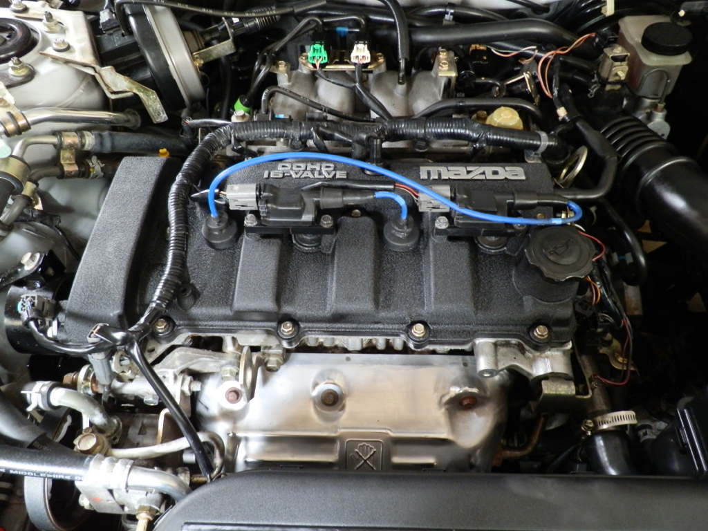

Hey everyone. I'm new here, but wanted to thank you in advance, Sleezer for the awesome pics with the arrows. I'm going to give this a go on my Mazda Protege5 next week while I'm off work for Christmas. I am a girl who doesn't know much about cars, but I enjoy learning. So far, I've done simple things like headlight repairs and sanding off the rust and fixing the paint job on my car (Which I love doing). I've also learned how to change the brakes and I got new calipers which I painted red. (Simple I know, but I'm proud of myself). :-) The red doesn't look good though, it always has kind of an orange hue to it, so I really like your black cover with red letters and bolts. Very sharp! Hopefully all will go well for me (cross your fingers) and I can happily put this on my list of things I've done.
Thanks, its a pretty straight forward project.
Oh and the valve cover has changed, wrinkle black an orange.
That looks awesome! Great job! I'm glad you changed the paint, because now I don't feel so guilty about painting mine the same. I tried with solid red, but it looked soooooo tacky, I had to go with black. Thank you for your help! It really helped me get through this! Thank you!

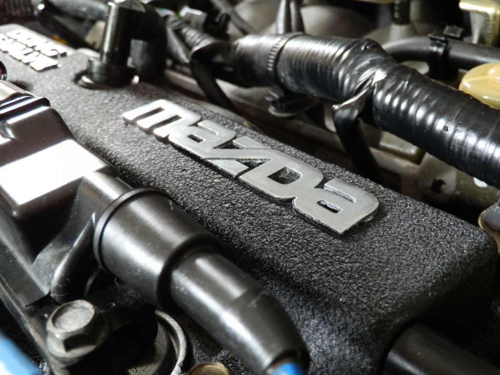

I have a question about painting. What is needed to paint? Did you sand it down first? and if so, with what grit? In getting the two tone look, like on the MAZDA wording, did you just spray it down first and then with a brush go over the words in a different color? Use any primer or clearcoat before and after the paint?
With mine I take a wire cup brush and cordless drill to clean up and etch the surface. Then sprayed on the wrinkle paint following the proper procedure. If you are doing gloss you will need to start with a rough sandpaper then work to fine to make sure the surface is smooth so the finish comes out right, that or find a high temp filler primer if it exists. And no Ive never used clear-coat on a VC. Use high temp engine enamel or my new. fav wrinkle.
Thanks for the info, i actually read that I shouldnt use primer because it may crack the paint after it is on it.
But about the lettering you did, did you first spray the lettering red, wait for it to dry.. then mask it off and use like a box cutter to cut away excess tape and then spray it black?
Tried that once. Was a pain and didnt work right. Last time I sprayed a bunch of the paint out on a piece of cardboard and used a sponge to sponge the lettering on
Well for my first valve cover job and spray, here are the results.. It does look a hell out a lot better than previous, but I am not 100% happy with the job, but for the most part, it works. The 16 still has some masking tape stuck in it that i forgot to take out (it is out now!). I wanted to shoot the cover below it but 2 out of the 4 bolts are not coming out and kinda stripped now too. lol. Thanks for the tutorial bro. By the way, I sequence in tightening the bolts back is reversed in anyone doesnt figure it out or know.
