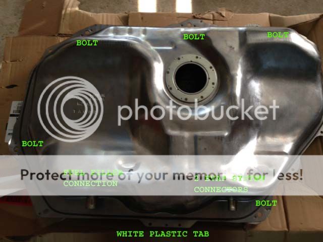

12 Get under the car and spray PB Blast liberally on the 5 13mm bolts that secure the tank and shield.
13 While under the car, locate the tangs on the little white plastic clip that fastens the vapor recovery hoses to the tank. It's on the center of the rear edge. Pinch it with pliers and push it up. Mine was brittle and just snapped.

16 Peer in through the wheel well and locate the black 1-1/2" fuel filler hose connector and clamp on the rear of the tank. Spray it with PB Blast. This is the part where you're psyched you jacked up the car nice and high.

21 Go around to the passenger side of the car and peer in through the wheel well to locate the 2 vapor recovery hoses on the back of the tank.
22 Use pliers to pinch the 2 clamps and slide them back.
23 Use the pry bars or hose pick tool to work the hoses off of the connectors.

25 Loosen the 5 bolts holding in the tank and shield and leave them threaded about 1/4 of the way in so you can easily turn them with your fingers. My car has been rolling around Massachusetts roads for 11 years and it's pretty rusted up but I got lucky and they spun right out with my pneumatic impact gun. I'm pretty sure that trying to loosen them with a wrench or ratchet would snap them. Beware that they thread into the body so if they snap or strip they're going to be quite a headache to extract.
26 Remove the bolts one at a time and reinstall them loosely so they hold up only the tank and not the shield. Drop the shield.
27 Get a capable helper and remove the 5 bolts (keep them handy in case you need to put the tank back up in a hurry) and GENTLY/SLOWLY lower the tank by dropping the front edge down and sliding it towards the front of the car. Note that the rear edge of the tank has a lip that sits up on top of the control arm center pivot. Have your helper check for any hoses or wires that you missed and watch for the fuel pump electrical connector from step 5 that is taped to the top of the tank. Drop the tank.
